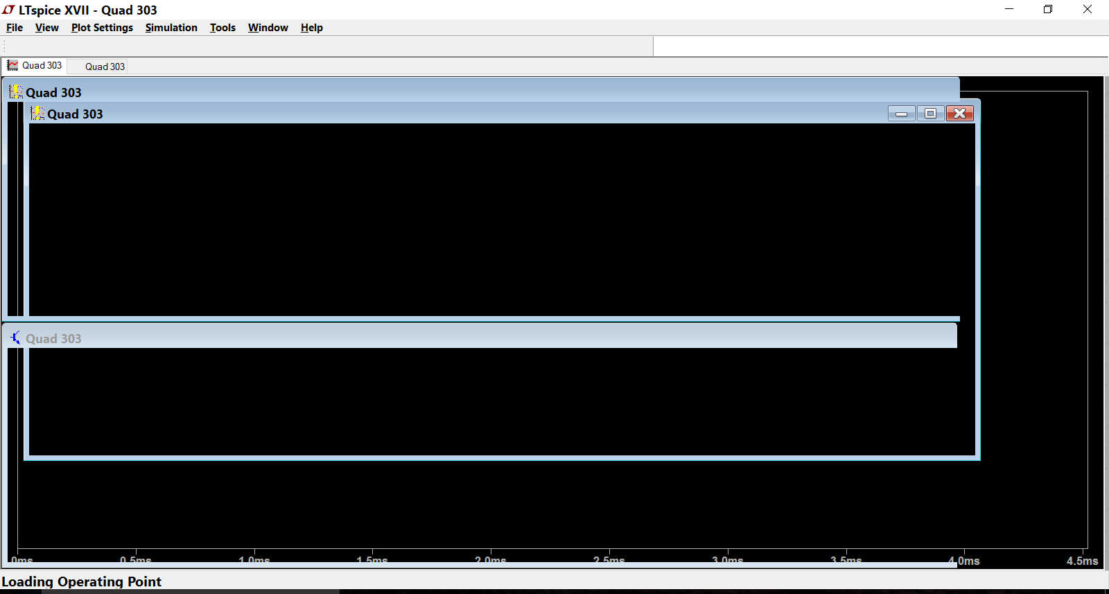

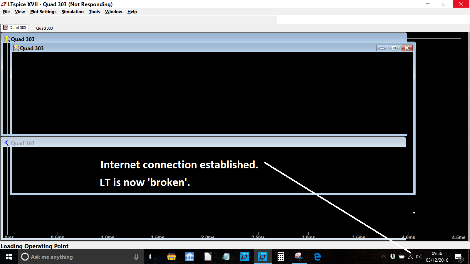

Are any users of LT XVII on Windows 10 suddenly finding it crashing out or not responding ?
Both my systems (one x86, the other x64) are doing this and I'm suspecting a silent Windows Update could be the culprit. Restoring to a previous disk image does not fix the issue. Restoring to the same disk image but this time with no internet connection available does fix the issue.
Re-establish the connection and LT is broken again. LT IV is not affected on either system.
Hmmm. Interesting.

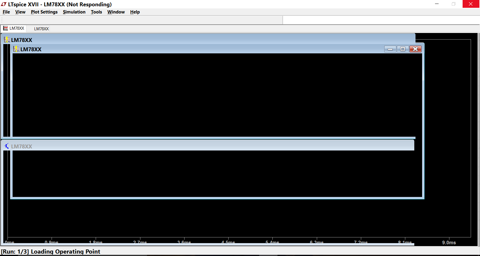

This is what I am seeing when I run any .asc transient simulation. Even the worked examples included with LT XVII will not run.

Very very odd. I've just tried it again and still the same. A .op command seems OK, its the transient run that screws up. The only way out of the above screens is to use task manager to close LT.
My second system (old Acer laptop running W10 X86) doesn't give the same broken graphic screens, it just freezes with a 'not responding' message. Again task manager is the only way out.
The x64 install which is used daily was fine until yesterday, the x86 has been OK whenever used (not regularly).
Yes, I tried reinstalling (uninstalled LT first and then re-installed). Exactly the same behaviour.
I take system images daily (and keep month end backups) and these are OK when restored as long as the PC has no internet connection. As soon as it does, then the working restored image then breaks (I'm guessing as W10 phones home and installs something).

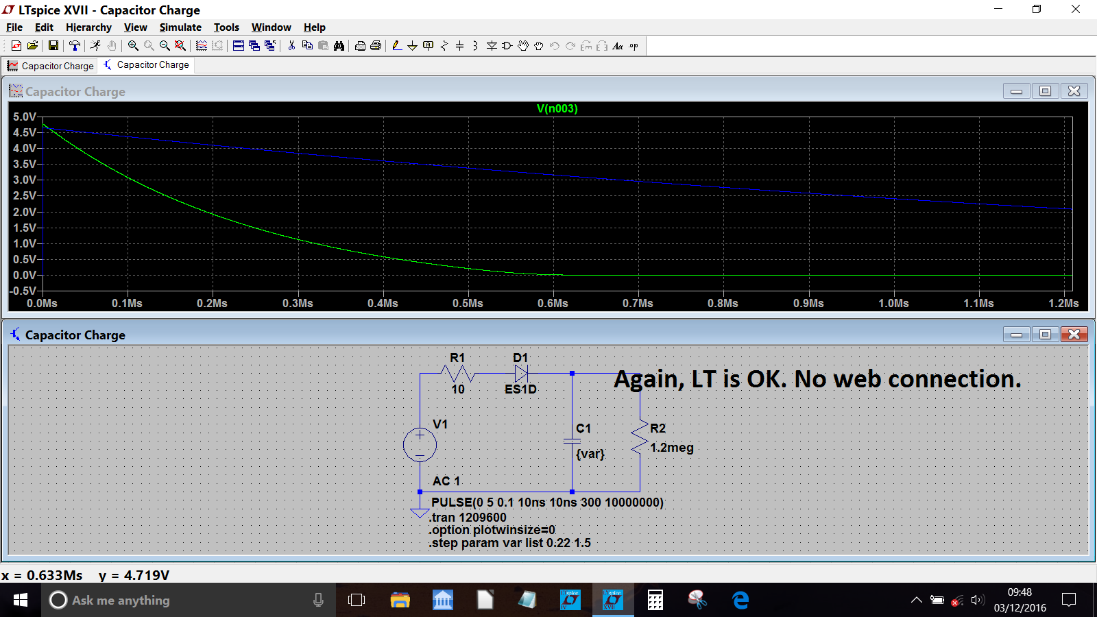

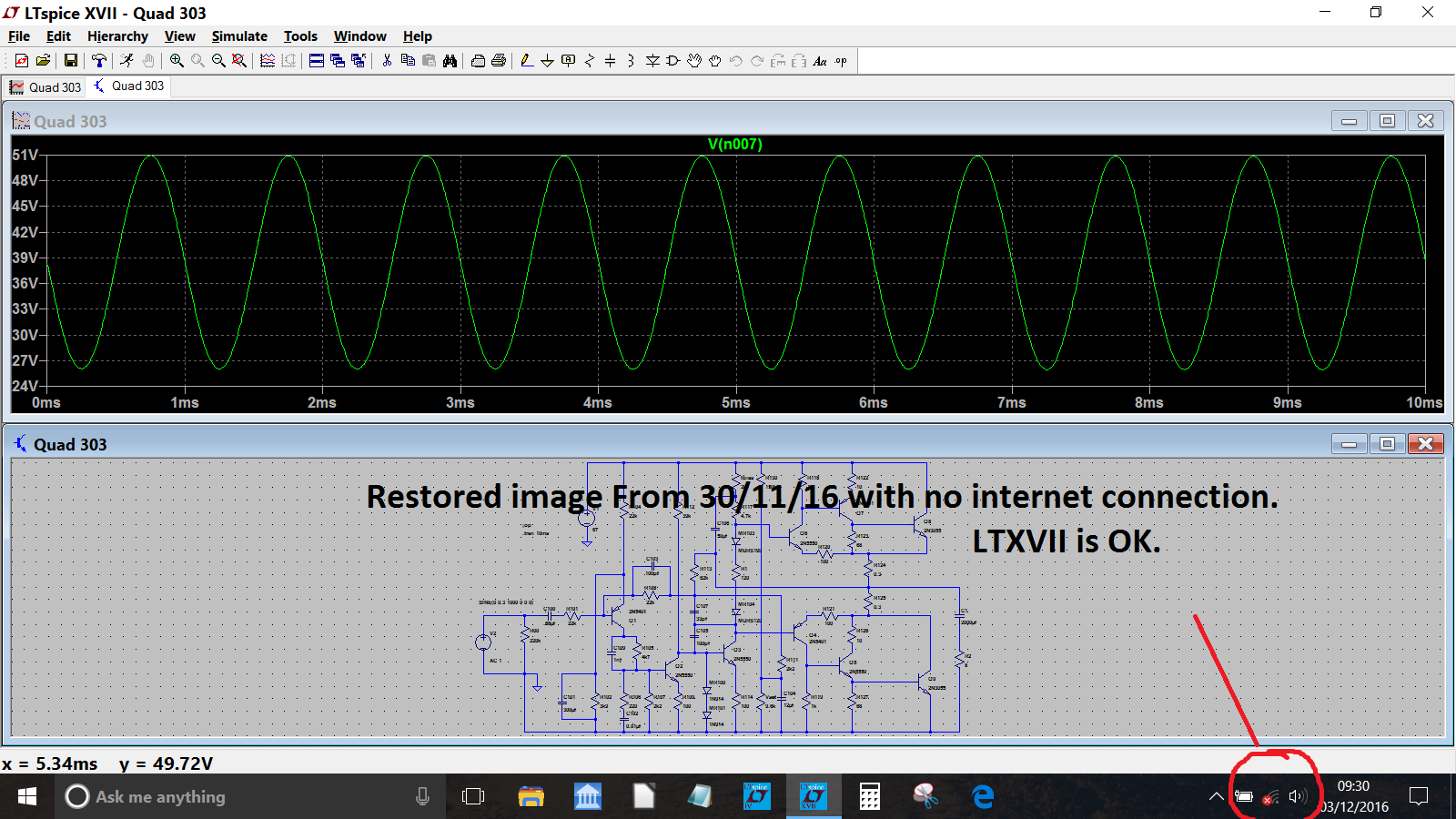

OK, so I wanted be 100% sure of the facts and so I recovered to my November month end disk image. The problems started late on the 1st December and so the image made on the 30th should be good. I'd done this once already but this time I wanted to take things slowly and see what was what.
These images probably show the issue better than any description. Be sure to look at the system tray and the time and internet connectivity.
1/ I restored the image and made sure I killed the internet connection before Windows could phone home. LT worked perfectly.
2/ I left the PC running and tried LT again. All good.

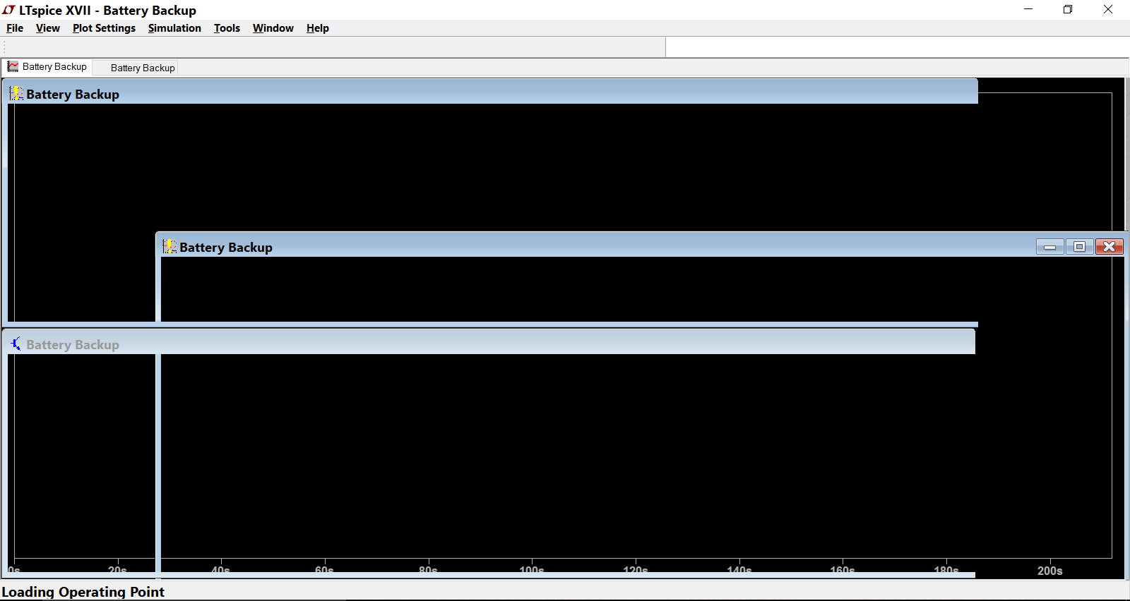

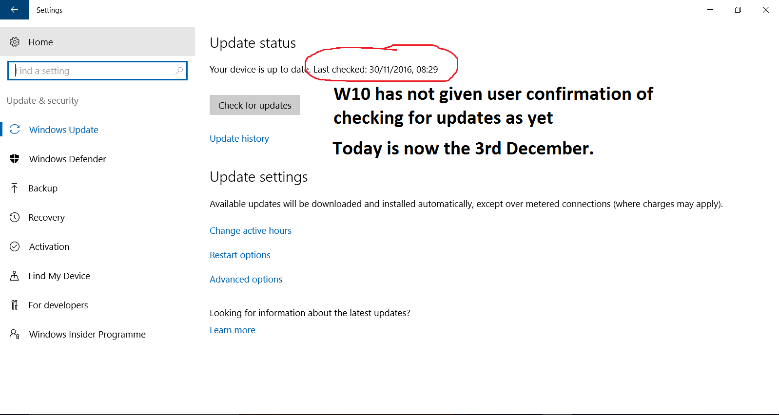

3 and 4/ I re-establish the internet connection. Windows Update has given no user info that anything has happened at this point, however after a couple of minutes LT is now 'broken.

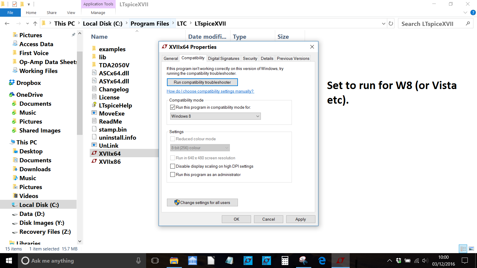

5/ When I installed LT XVII I made the choice of choosing the combined 32/64bit package. That is why you can see two executable files here, one is x86 and one x64. Curiously on this PC the x86 version appears to still run correctly. The x64 does not.

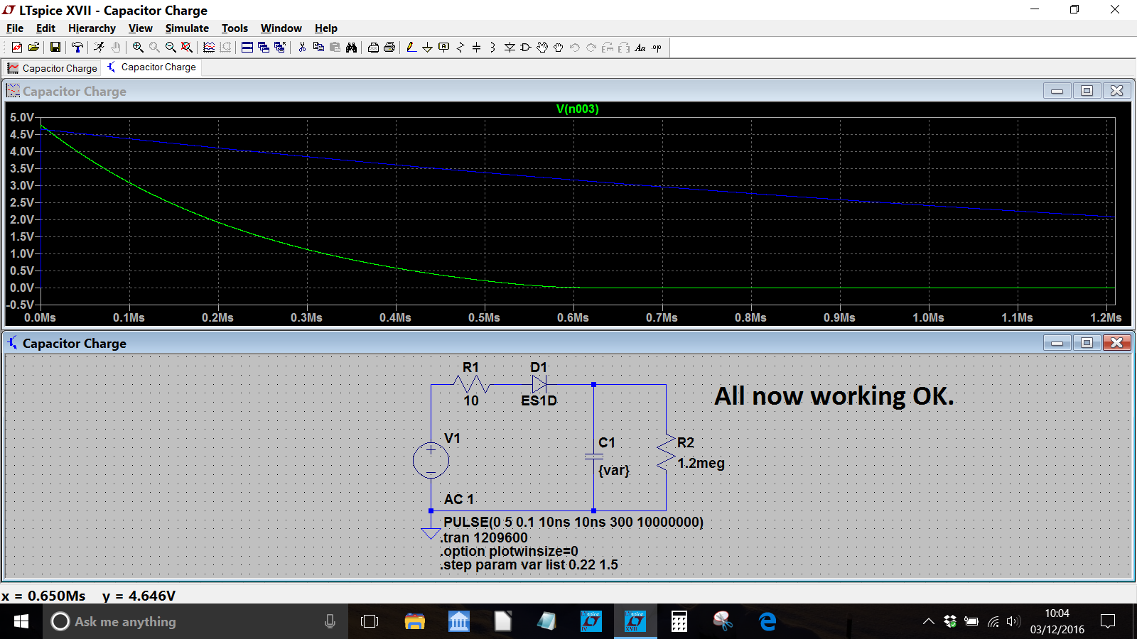

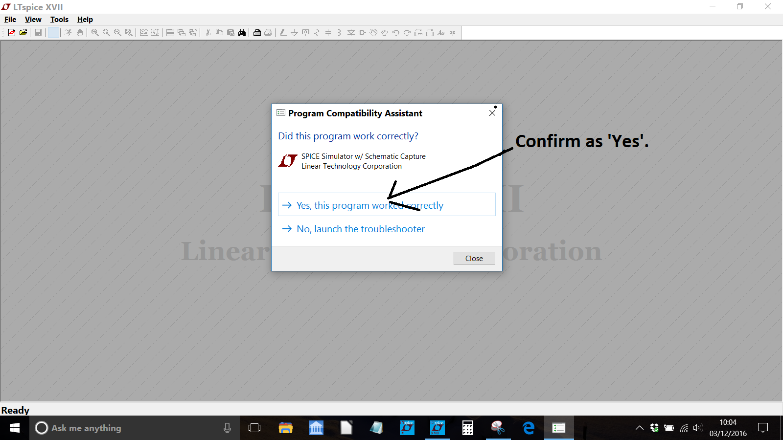

This is the point I right clicked the executable file and tried Windows own compatibility trouble-shooter. Setting the Windows version to anything but W10 appeared to instantly fix the issue.
6/ After applying a change Windows asks for confirmation that it is OK.
7/ LT XVII now appears to run faultlessly once again.
My 32 bit W10 install also seems to have responded to the same fix even though the symptoms were different. This set up just froze with a 'not responding' message.
Conclusions... I am forced to believe on the evidence that some Windows processhas been altered or updated silently causing the issue. The two PC's affected are pretty much identical in configuration and 3rd party software but years apart in hardware terms.
