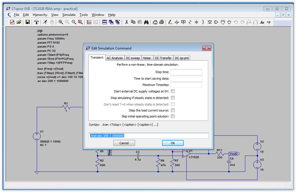

So, if anyone still wants to use older schematics : the new software is NOT compatible on the area of parameter transfer! I won't use the new software if this isn't fixed!

Noticed an obvious flaw... Parameters defined for the transient analysis in a current schematic appear not to be correctly read into the new version and are displayed in the AC department.. also other settings (octave, decade... etc.)for the AC transfer function are lost. One has to re-enter them to be able to run the analysis...
Verdict... some nasty details have to be fixed...

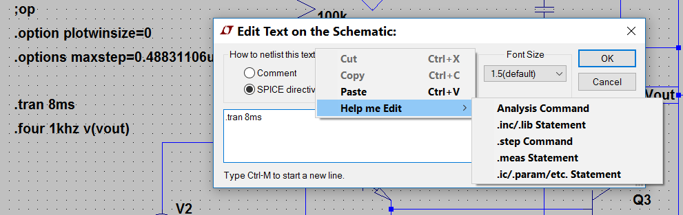

I don't get it tbh. Mike sent quite a detailed reply saying that the behaviour is 'by design' and that once you understand how LT XVII works it will makes things easier.
For example if you right click an op command there is a 'help me edit' tab. Its not intuitive and it seems a bit convoluted and difficult to understand at the moment.

I now have to click my mouse twice as many times to do the same thing and this is considered better?
Well its certainly different and its going to take a lot of getting used to. On the other hand, if LT IV is becoming an unsupported legacy system then I feel its probably worth the effort to try and get to grips with it.

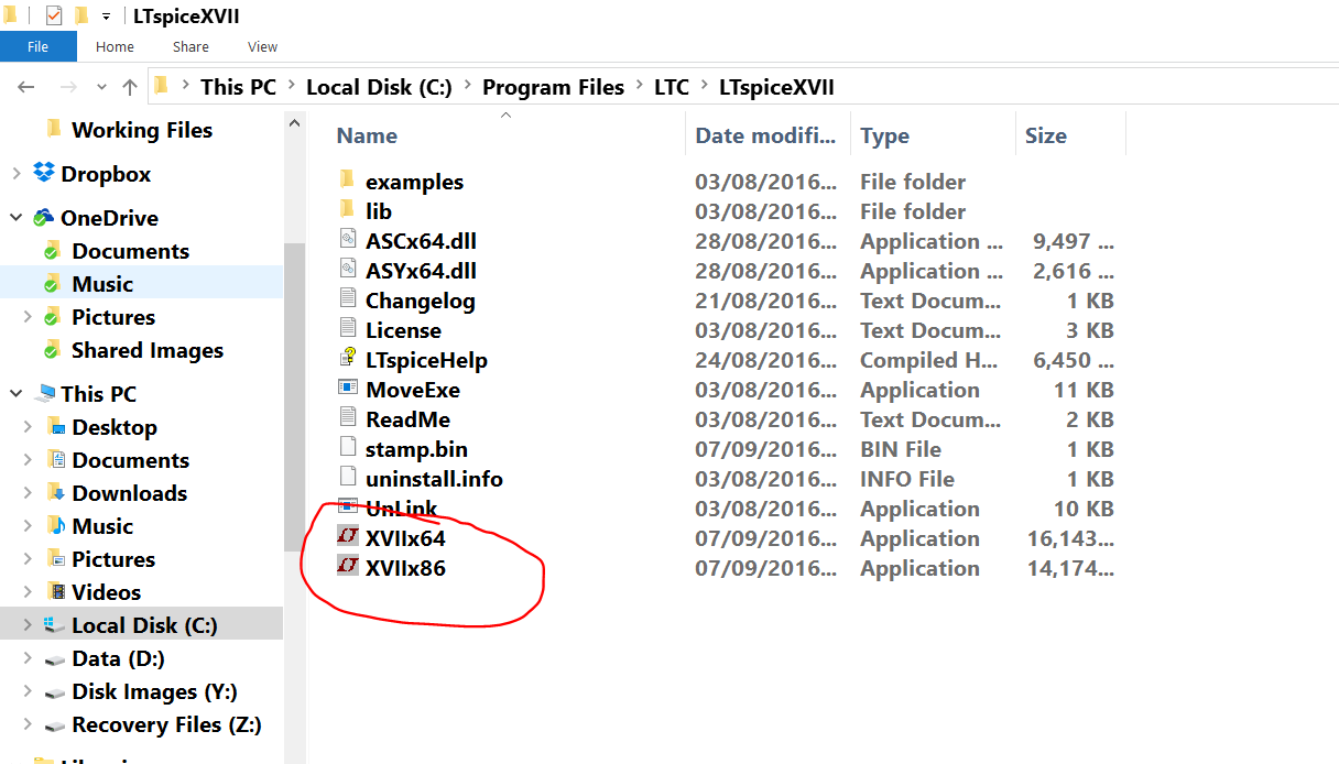

1/ When I installed XVII I can not remember now what the installer offered in the way of 32 or 64 bit versions. Was there a 32+64 option ? I ask because in the program files I have both applications installed (and both work). However BOTH these are in the x64 program files. There is nothing LT related in the x86 program files.
2/ I do have an old laptop running the 32 bit version of W10 and so I installed the 32 bit version of LT on this one. Although it was OK at first, I'm finding now that the 32 bit version throws up an error message when updating LT. Something about permissions (I'll have to take another screen shot) but if you just carry on and click either retry or cancel then it says the LT spice executable was updated OK. And so it seems. Mentioned that to Mike but had no response.
