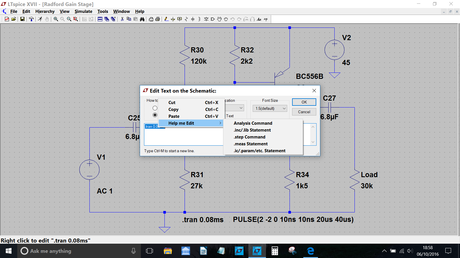

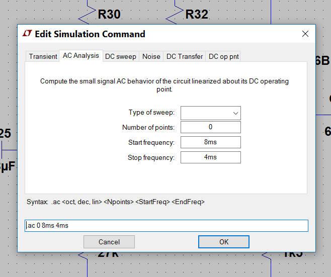

The most annoying aspect is the 'edit simulation' window which carries over settings from one task to the next as here. I'm assured this is 'by design' but I'm really not understanding how it makes life easier. I just don't get it.
Sometimes that might maybe possibly potentially could mean there was no written requirement(s) for the functionality, and the implementation just happened. And it was discovered to be less than ideal later, after final test and release. But rather than go to the expense of changing, testing, and re-releasing, the official party line becomes "works as designed". 😛 And in the case I've outlined it's not an untruth. But all this is pure speculation on my part, nothing more than my imagination at play: I'm sure does not happen in the real world.
Maybe 🙂 although the reply I got was that it was a great improvement over LT IV in this regard.
The gist of it is that you right click any .op command on the diagram itself (such as .tran 8ms) and then click cancel it opens to a new window that allows you to right click again and bring up the 'help me edit' option. From there and a flyout menu appears.
That doesn't seem intuitive or quick to me.
...That doesn't seem intuitive or quick to me.

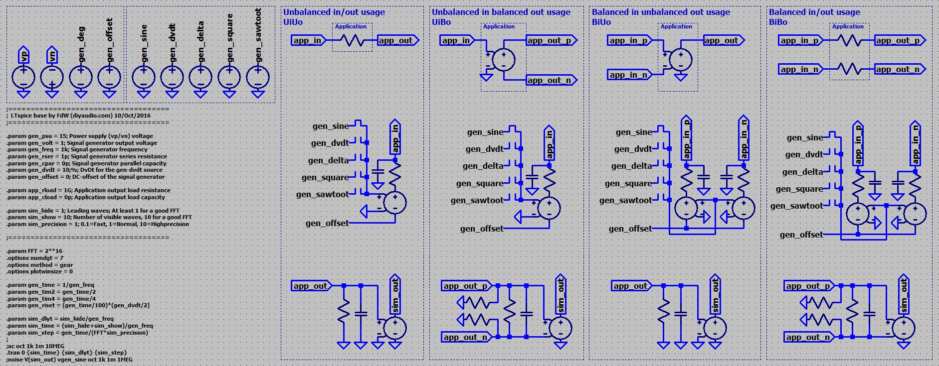

This is what happens if you have to much time on a Sunday.
Use the attached files to install a new context item in the explorer context menu. The new file created will not be empty but contains power supplies, generators (sine, square, dvdt, delta and saw-toot) basic settings and more.
There is also (when selecting the balanced out support) a means to consolidate the balanced outputs of your schematic into one signal to analyze. For balance in the model support a generator set that supports the p and n signals from one common source (this (for instance) supports noise or THD measurements including both signal paths).
Default settings for .TRAN, .AC and .NOISE analysis are included.
And, you can specify the simulation speed, from slow to normal and fast (vary the value of the precision parameter).
See the '.txt' file for install information.
There are 4 files attached to this post.
1) FdW's Simulation Base.reg.txt (before using this file, you must remove the '.txt' extension)
2) FdW's Simulation Base Readme.txt
3) FdW's Simulation Base.asc

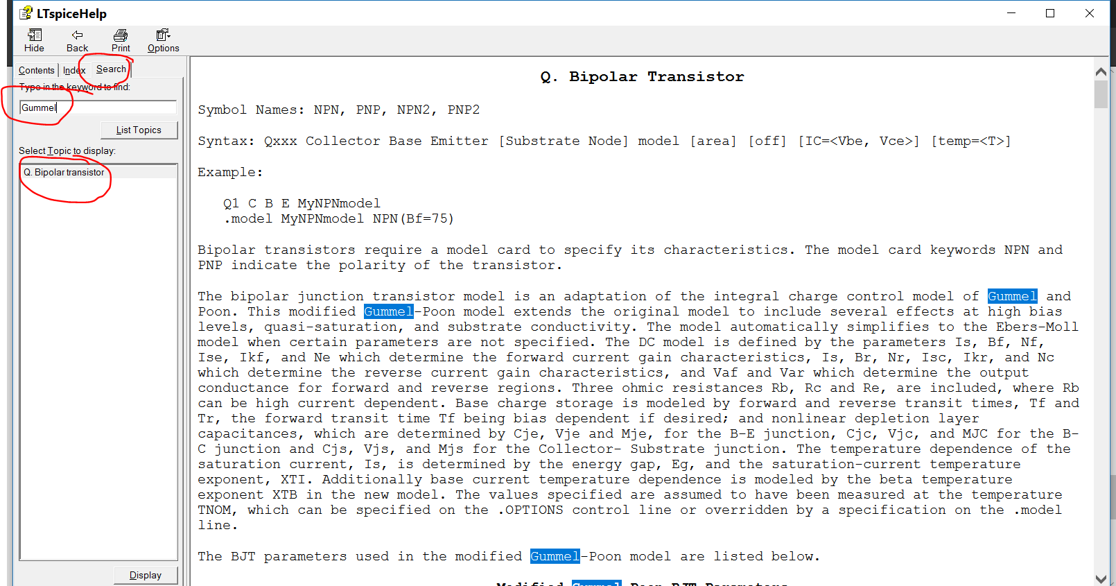

It may already have been covered in this, long and useful, thread...but how do I input actual transistor-values?
That is, I have measured a bunch of transistor for hfe and vbe, so I know those values, how to input them in to the circuit for a more accurate simulation?
Unfortunately the models don't use simple values (such as hfe and Vce) that we can just input directly to create new ones.
I would strongly recommend you read Bob Cordells book "Designing Audio Power Amplifiers" which has a both a very large section on LTspice and also covers in depth creating and altering models.
If you click on 'Help' in LTspice (located on top line) and then 'Help Topics' and search for 'Gummel' (which in turn will bring up the topic 'Q Bipolar Transistor) you will find a hint of what is involved...
