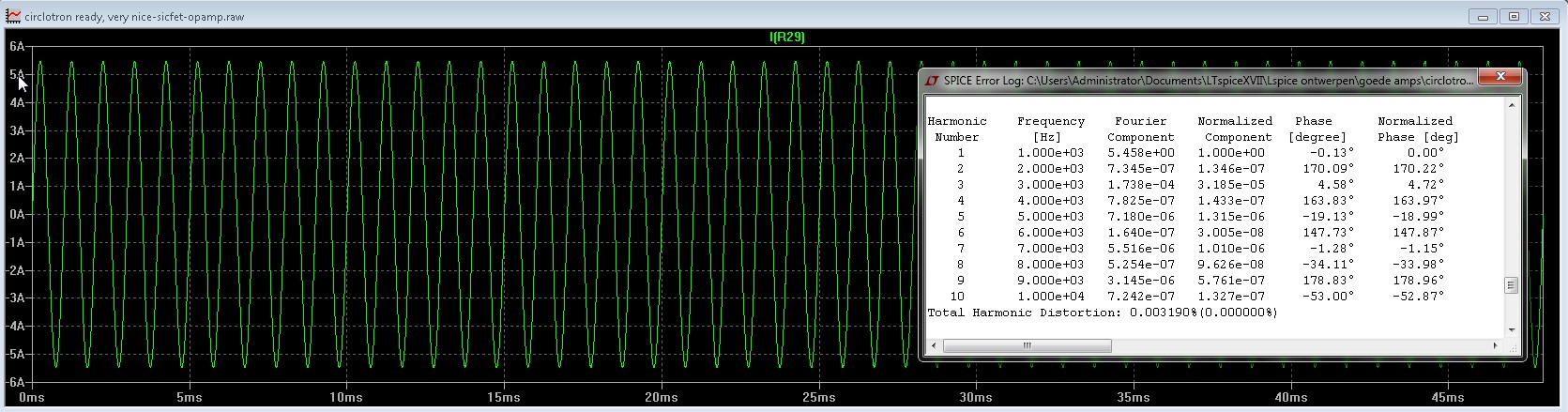

What do mean the distortion of a amp between the brackets?

If the second (bracketed) figure is higher than the first then you haven't used/included enough harmonics in your simulation.
That oscillation at the start will totally screw your result, your simulation isn't covering and including the harmonics contained in that.

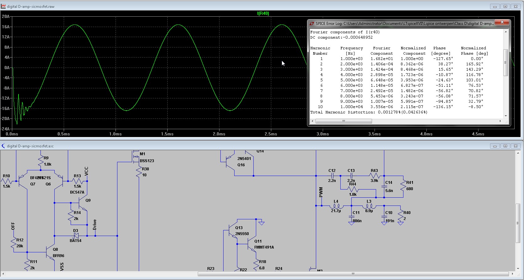

So it has to look like this? I need to remove startup or set start plot after 6 ms.
the other one was the D amp, that simulationtime needs to set longer? but it do go slow, this one is a liniair amp (circlotron I make pcb for).
thanks for respons.
Yes, that looks OK.

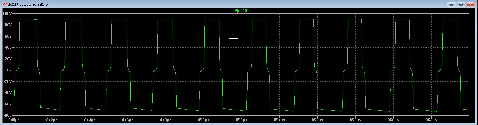

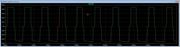

I need to sim long enough so the value between brackets are zero, or same as left side? that costs time with a d amp, simulates very long, I need also to look at the IR2011 model, the lower side mosfets do not switch to the rails, the upper side is fine. @spiceanalog did made that model, and maybe he knows why and how to correct.
thanks all for help.

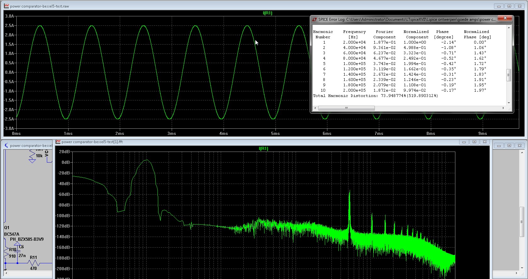

I don't think there are any hard and fast rules tbh. Mike Engelhardt said it was a requested feature and that was why it made an appearance. Definite details on interpreting it down to the nth degree are sketchy as you have probably found.
Mike is pretty approachable I have found, particularly if you have any issues with models or something doesn't seem right.

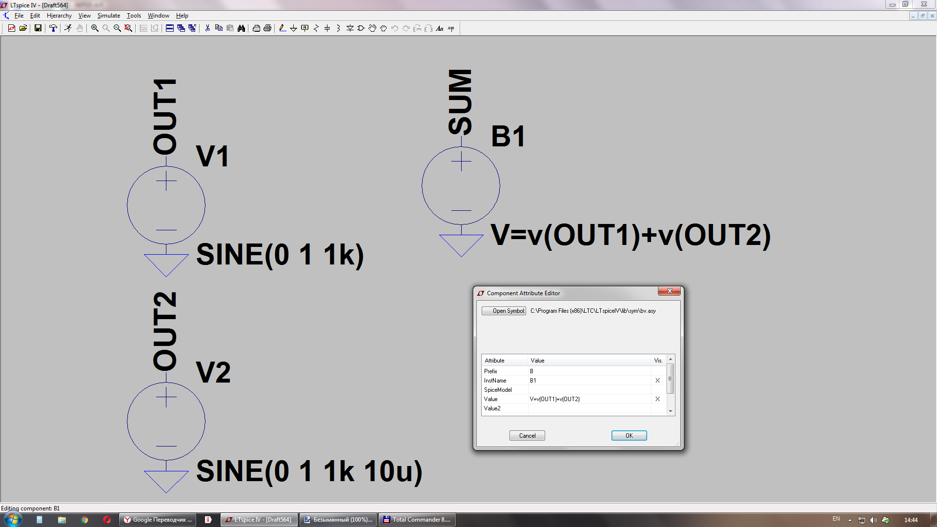

Is there any way to sum two outputs in LTspice IV?
I'm working on a line level 2 way crossover and would like to view the combined output with phase. I've searched for a couple of days and can't find the answer. That is probably as much of a testament to my search skills as anything but if someone can point me in the right direction I'd be grateful.
Thanks,
Marty
If you click on the name of the curve ( don’t remember whether left or right) you should see a window opening where you can enter an expression. Just add the other value and you have it.
Sorry for not being more precise, I’m not at the screen and did just that the first time yesterday
