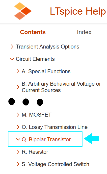

One thing you could try is: tell LTSPICE to emit an ASCII netlist. Then check the netlist to see whether it contains .MODEL statements. If not then perhaps reading section "Q. Bipolar Transistor" of the help file might suggest possible default values that LTSPICE drops in when your .MODEL doesn't mention them.
Or you could decide that it's silly and misleading to run circuit simulations with unknown transistor models, and never do that again. Decide that if you don't know and don't actually care which particular transistors are used, you'll make it a habit to always drop in the 2N5401 / 2N5551 for simulation.

Thanks for the tips.
That is delberatly i like to run simulations with defaults components. I assume they are widely general purpose.
The idea behind using the defaults is to not care about component choices, to firstly care about toplogy trends rather than details.
I was caught doing so with Vaf. The default BJT is Vaf=infini. I want to see wether there are more traps.
I just have suspicious results that are much better with 2SA1579 than with the default PNP. The 2SA1579 model has a very hight Bf, may be there more that is better than the default.
OK, I could use my own defaults: 2N5401 2N5551 1N4148 and so on.
Output an npn or PNP transistor to the circuit without selecting a specific transistor from the pop-up menu. If you want to change the gain of the transistor, for example, the gain and the Earley parameter, then enter a directive on the circuit: .model npn npn BF=50 VAF=80 .

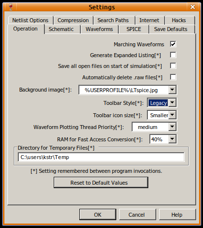

As a happy XVII user, to assist someone else who downloaded Version 24, I had to go to this version also.
It seems this version is made for analphabetics with all those silly symbols in the menus that are very confusing.
What's wrong with straight text ?
The other thing that annoyed me is that each time I start the program, I have to start it explicitly as Administrator although I am Administrator.
When forgetting to do this and just starting the program, functionality is very restricted and you can't save.
Maybe there's a way to change this, but so far I couldn't find it.
For the time being I see no single reason to switch from XVII to 24.
Hans
That sounds a bit weird tbh. I've two LT24 installs and haven't encountered anything like that. I wonder if there is some conflict somewhere with the previous version.
When you installed it did you choose the 'Install for Everyone' option or did you use 'Install Just For Me' option although either should work normally.
Same here. V24 running without any issues for me on various W10 and Wine/Linux platforms. That is, fresh installs (not updating from XVII), and sometimes installed in coexistence with venerable ltSpiceIV.
And for those silly icons (I agree they are silly), the layout is configurable:
