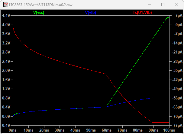

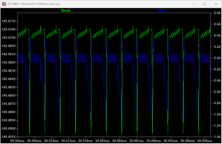

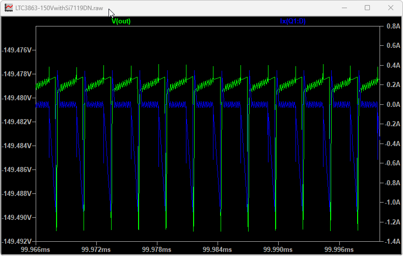

I ran the sims to their conclusion. Both reached -150V after ~90mS. Zooming in on the last fraction of a millisecond showed there wasn't much in it.

I checked the Mosfet in Help and
M. MOSFET Vertical double diffused power MOSFET:
Syntax: Mxxx Nd Ng Ns <model> [L=<len>] [W=<width>] [M=<area>] [m=<value>] [off] [IC=<Vds, Vgs, Vbs>] [temp=<T>]
I never noticed this before " [M=<area>] [m=<value>]" 2 options!
Looks like the area scale factor is "M=..." which is case sensitive?
But I haven't checked a sim to see if "m=0.2" does the same as "M=0.2" when used after the model name in the VDMOS model.
Re: no load in my sims - was to see if it reached steady state sooner, but it didn't, so I limited the test to 10ms rather than wait many minutes to get to 100ms.
There may be some way to get to 100ms (steady state) faster. Maybe some can suggest how, other than using a supercomputer.

The Si7113DN simulation runs quite a bit faster in v24 even in the VM I'm running it in. On v24 the Si7119DN simulation stalls after a few microseconds and finally produces a "Time step too small error".
I have the information I need from the simulations anyway - confirming that the specified components are up to the task with power and voltage estimates.

The inflection in the output voltage occurs where "the SS pin voltage is greater than the internal 0.8V reference, the VFB pin voltage regulates to the 0.8V internal reference".
Current from the Vfb peaks at 75uA when the output hits the programed -150V. The datasheet says it needs to be < 200uA so no problem there.
The Si7119DN model won't go past 84us on v17.1.11 or V24. Worked fine on V17.1.11 last evening and I haven't made any changes to it.

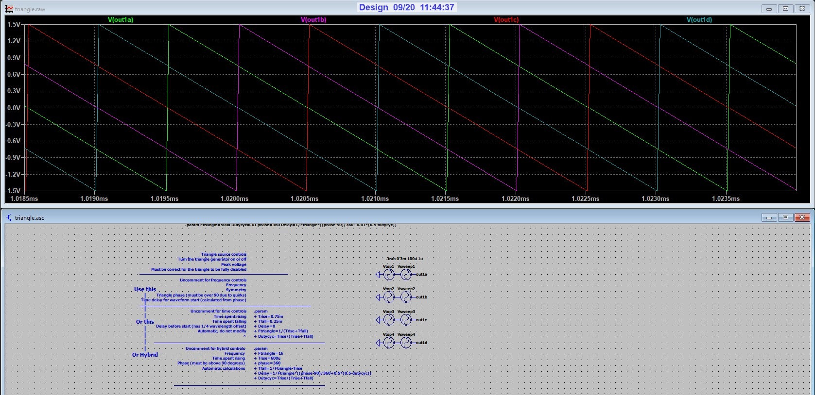

Because I am not very good with some things concern LTspice, I have a question about
how to change the triangle to a sawtooth.
Dit change the dutycycl from 0.5 to 0.1 did make a sawtooth who was inverted. but
invert back when use the second dutycycl and change the first back.
Sawtoo is needed for ripple supression. Now i use the trianglewith 90 degree shifts
these shifts need to be stay there.
.param Ftriangle=250k Dutycyc=.5 phase=360 Delay=1/Ftriangle*((phase-90)/360+0.5*(0.5-dutycyc))
I am thankfull if someone can explain for me or show me.
regards

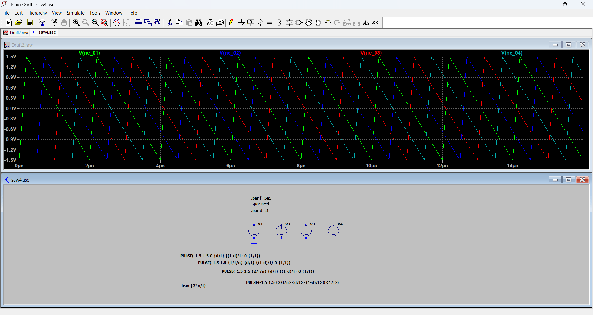

This is not an LTspice problem. You must define the sawtooth yourself, on paper, start at time 0, next point is time 5 amplitude 10, next point is time 2 amplitude 0. That is one period.
Then place a voltage source on the schematic, open the menu for it (right click) and select PWL and fill in the points you just wrote down. Check how it looks and modify as needed.
Jan

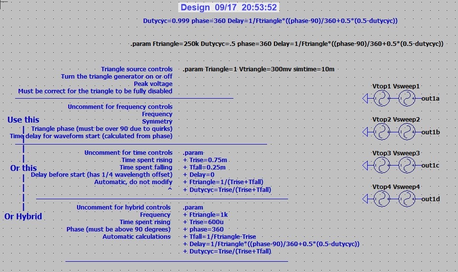

Still I can then not adjust the fase between them, now I have four voltage sources who can be setup for fase, like 90 degree
then 180, 270, degree etc as you see in the pc, see the asc. It is some more complicated then a single triangle or sawtooth,
this I can do, but for shifted signals I can not do it right, just do not now.
It is always hard to work with someone else's construction, at least for me.
As I mentioned, I would just take 4 sets of 50Hz sine wave, rectifier, capacitor, load, to get a realistic wave to check PSRR, not an artificial one with a different spectrum.
You can set the phase for each sine wave to get different phases for the sawtooth.
Don't waste your time figuring someone else's stuff and still not have a realistic sawtooth.
Jan
Hi Steveu, it do look like I need, however the sawtooth needs to go from 0 to max in period the other way around.
I have done this on the asc I have use for triangles.
The only thing I did was change this.
.param Ftriangle=500k Dutycyc=.5 phase=360 Delay=1/Ftriangle*((phase-90)/360+0.5*(0.5-dutycyc))
to this, but is not a perfect sawtooth, but maybe risetime is to low I mean, inverted was risetime...
.param Ftriangle=500k Dutycyc=.01 phase=360 Delay=1/Ftriangle*((phase-90)/360+0.01*(0.01-dutycyc))

If I do change the file like this.
.param Ftriangle=500k Dutycyc=0.99 phase=360 Delay=1/Ftriangle*((phase-90)/360+0.01*(0.99-dutycyc))
I get the sawtooth reversed and is what I need, but why it does not work if I use 1 and not 0.99 for both changes.
because when I do I get a more triangle/sawtooth mix waveform again but
The end of the equation is always zero, so that does look wrong.
0.01*(0.99-dutycyc)) is zero for dutycyc = 0.99
Same for 0.5*(0.5-dutycyc)) for dutycyc = 0.5
It is anyway confusing that in some cases you use the Dutycyc variable and in some cases the actual value.
That invites errors. If you set dutycyc to 0.9, then use (1-dutycyc) instead of 0.1, much less chance that you forget something when you change the duty cycle.
