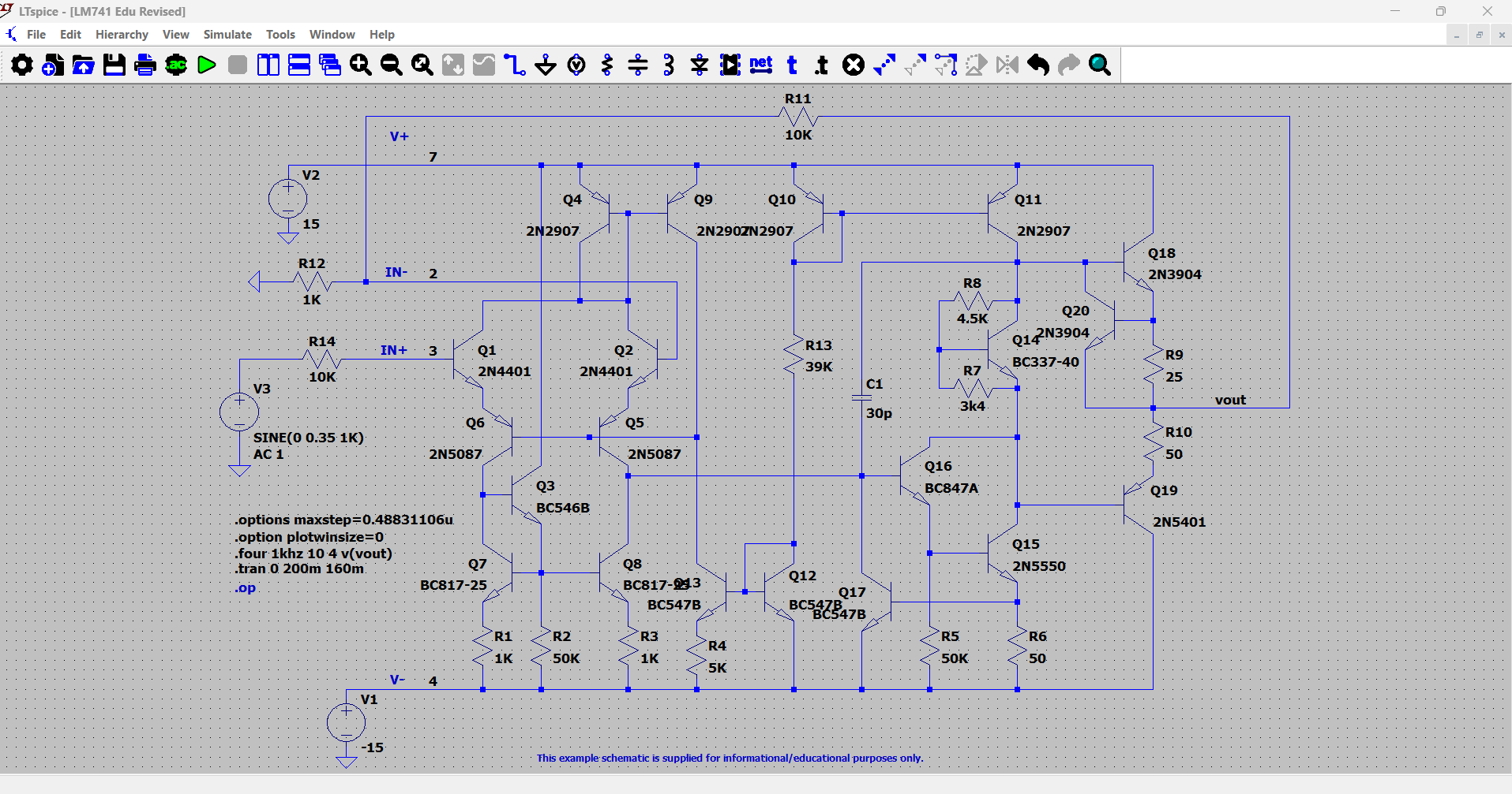

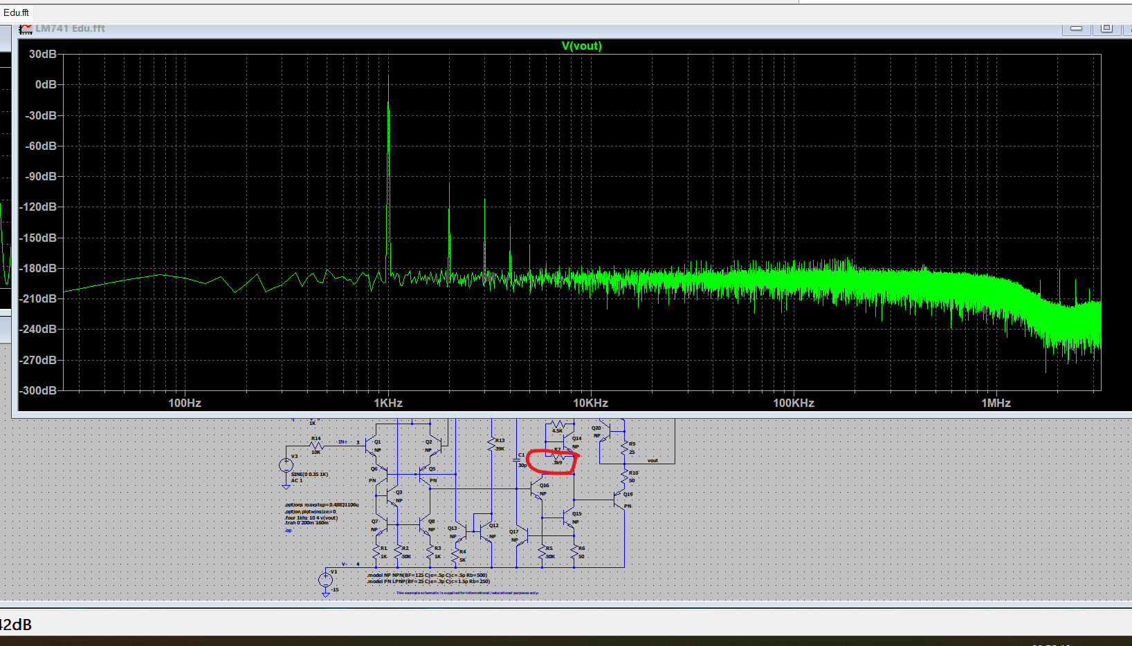

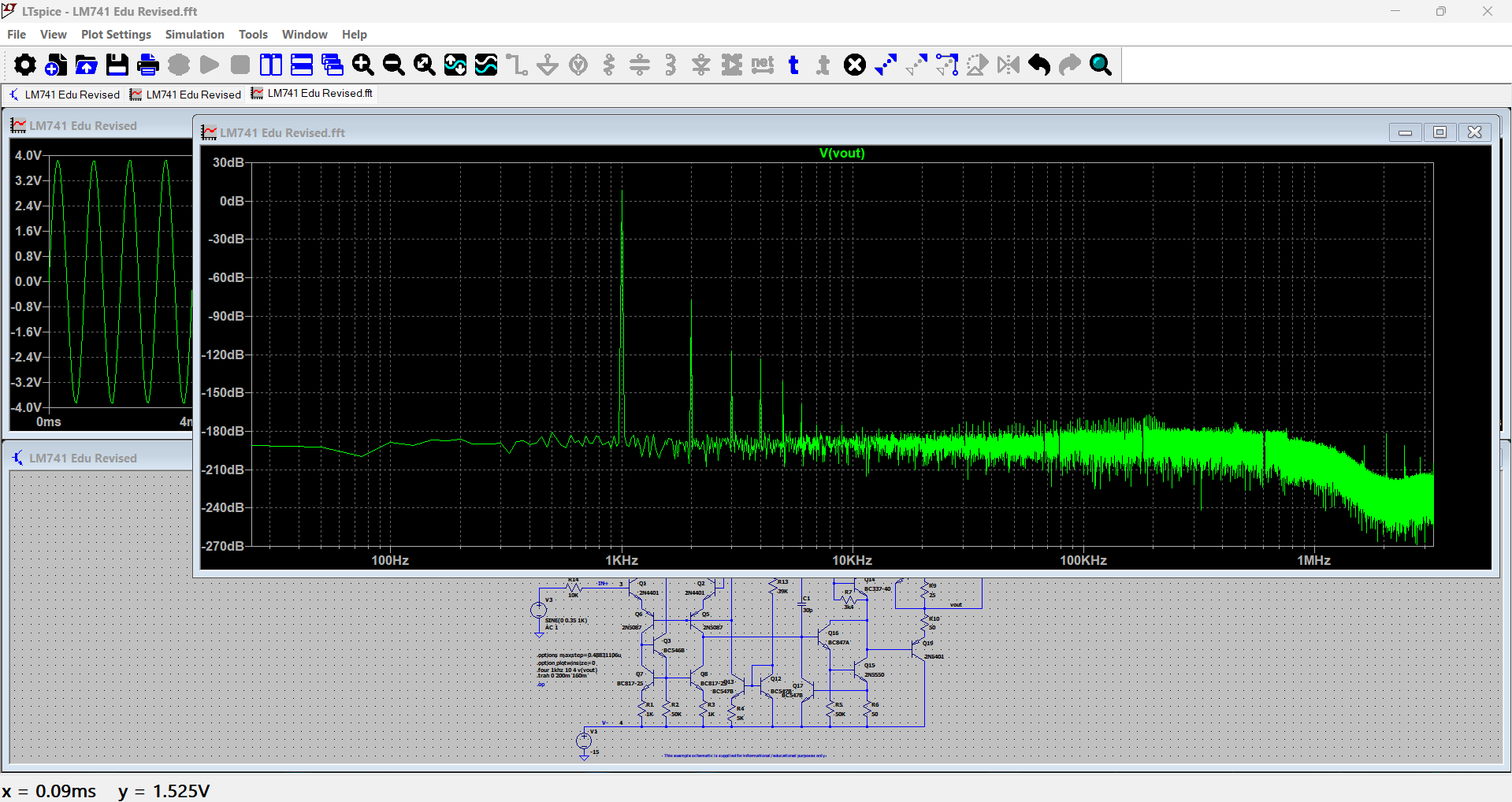

If you take a real amplifier circuit and substitute all the transistors and providing they are suitably rated for voltage and current then generally the circuit will still work as before. Same for simulation, swap a BC546 for a 2N3704 for a BFY51 for 2N5551 and it will all work and sim essentially the same.
Try this one. Look at the models. All picked totally at random from devices that generally meet the spec for a circuit like this.

Thank you so much again This shows how the actual topology and voltage and bias points are important Great
But still for a same duty some bjts should be more performant than other (i am guessing here)
My main problem now is basic ignorance I guess there must be an optimal working point for a bjt in terms of Vceo and Ic
I say this because they are the parameters most highlighted in the datasheets
The nest goal is to understand from the values that come out from the simulation if the various bjts are working optimally or not
This is when passion is facing ignorance 😕

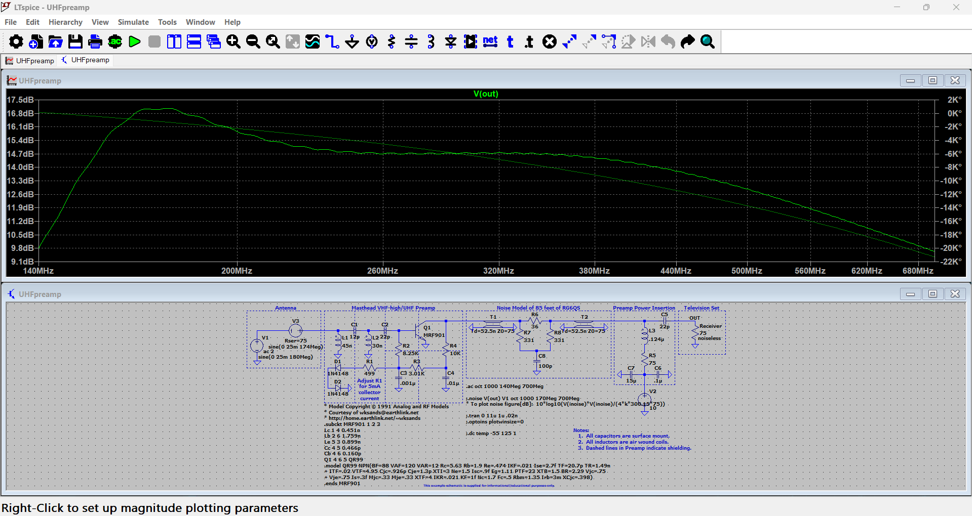

Look at the sim in Examples called 'UHF Preamp'. That might be a circuit for a TV aerial booster.
Look at the gain in db at the left:

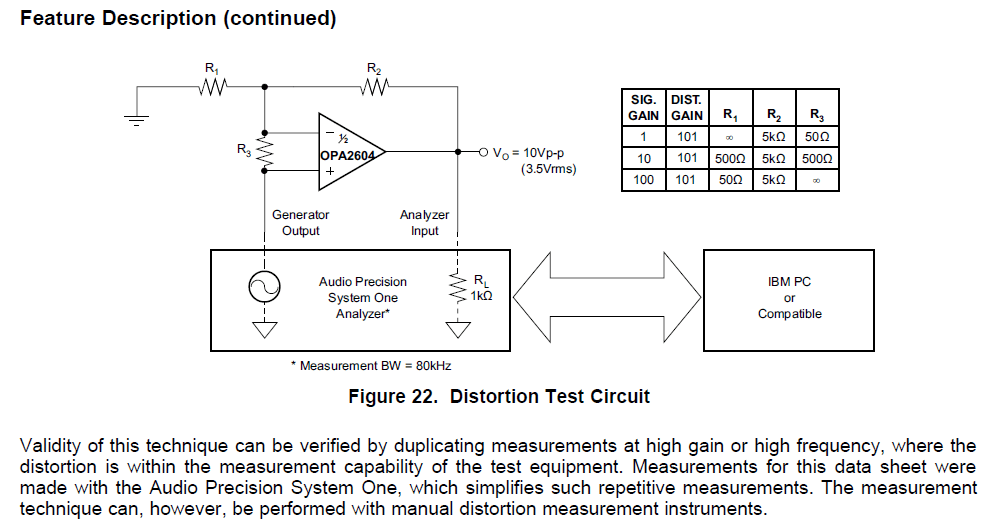

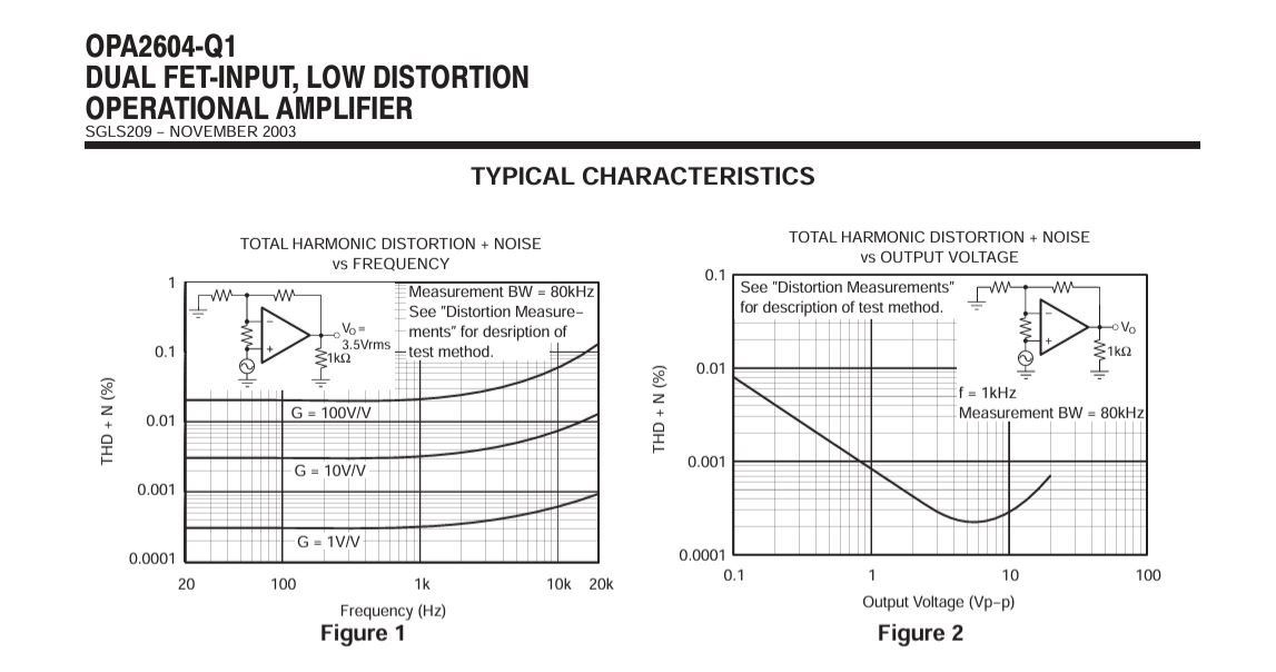

The AD797 is a very high performance opamp and is very demanding in terms of the board layout and the circuit application. It sounds very much like your project might have been oscillating as the pot wiper reached ground. Adding a 100 ohm isn't a normal thing to do with most designs.
Maybe But opamps aside and speaking of discrete very few design can achieve THD -120dB
The best opamps are very difficult to even measure at those sort of levels but there are tricks that can be used to make the distortion 'bigger' and so be able to calculate what the real distortion is.

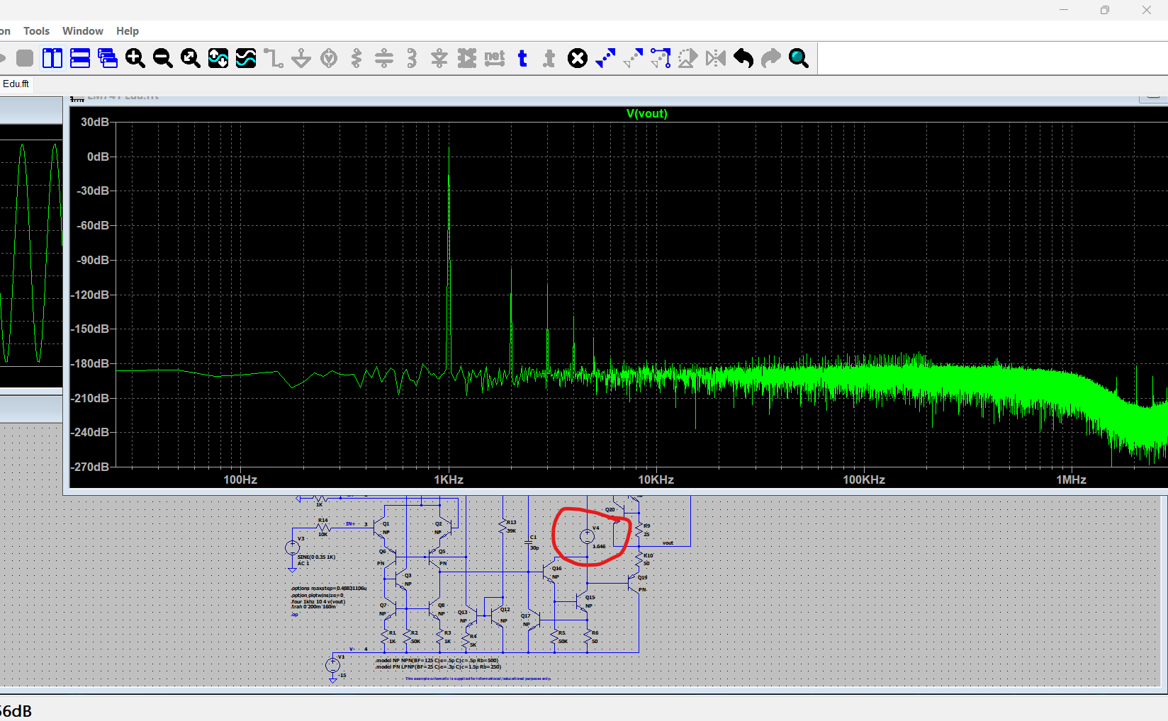

Many opamps use this method:

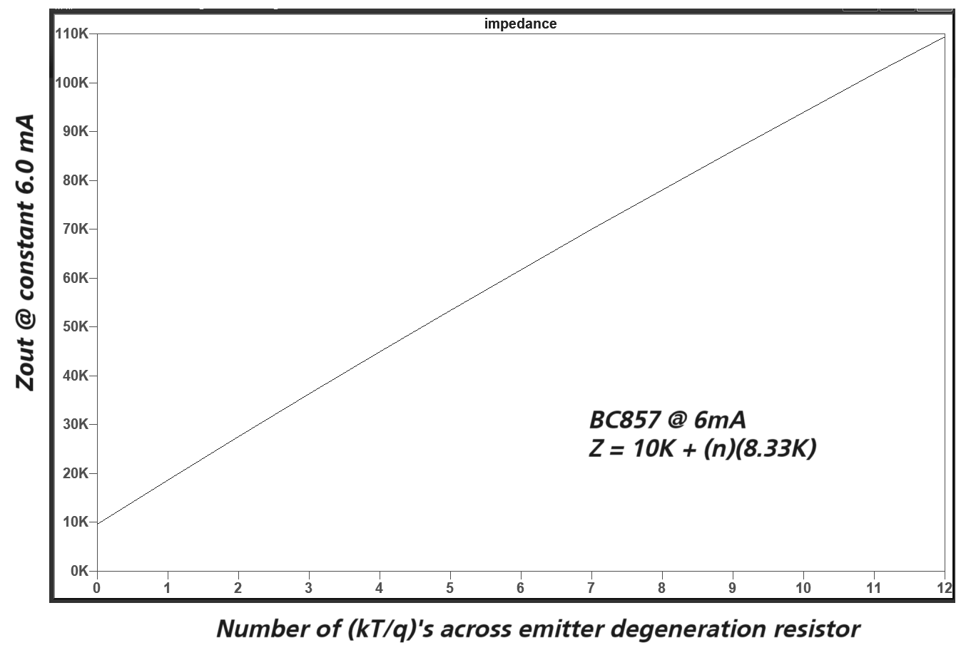

A CHALLENGING PROBLEM FOR ADVANCED LTSPICE USERS ONLY
In my opinion, this is a fun little exercise which produces a surprising result. It took me about one hour to complete, one enjoyable hour. However, I didn't know whether it was even possible. Now that YOU know it IS possible, maybe you can finish it in even less time! Here's the problem statement:
Build a 6.00 milliampere constant current source using a BC857 PNP transistor (datasheet attached ; SPICE model below) and an emitter degeneration resistor. Vary the emitter resistance in steps of "deltaR" ohms, where deltaR = ( (kT/q) / 6mA ). Assume (kT/q) = 26 millivolts, thus deltaR = 4.333 ohms.
This means: simulate the BC857 with (i.) zero ohms emitter resistor, and with (ii.) 1*4.333 ohms emitter resistor, and with (iii.) 2*4.333 ohms emitter resistor, and with (iv.) 3*4.333 ohms emitter resistor, and with (v). 4*4.333 ohms emitter resistor --- et cetera. Run for 0 <= n <= 12 times 4.333 ohms. The horizontal axis on the plot below runs from n=0 to n=12.
Then use LTSPICE to .MEASURE the output impedance of your stepped current source. Then tell LTSPICE to plot (output impedance) versus the number n. You ought to get something like the attached plot below.
Look at the plot and utter your favorite word: Shazam! or Cowabunga! or Eureka! or SonyaVabeetch! The darn plot is LINEAR. Who woulda thunk it?
If your LTSPICE installation does not include a BC857 transistor model, you can use the one I copied from Rohm Semiconductor's website (link), it is below.
