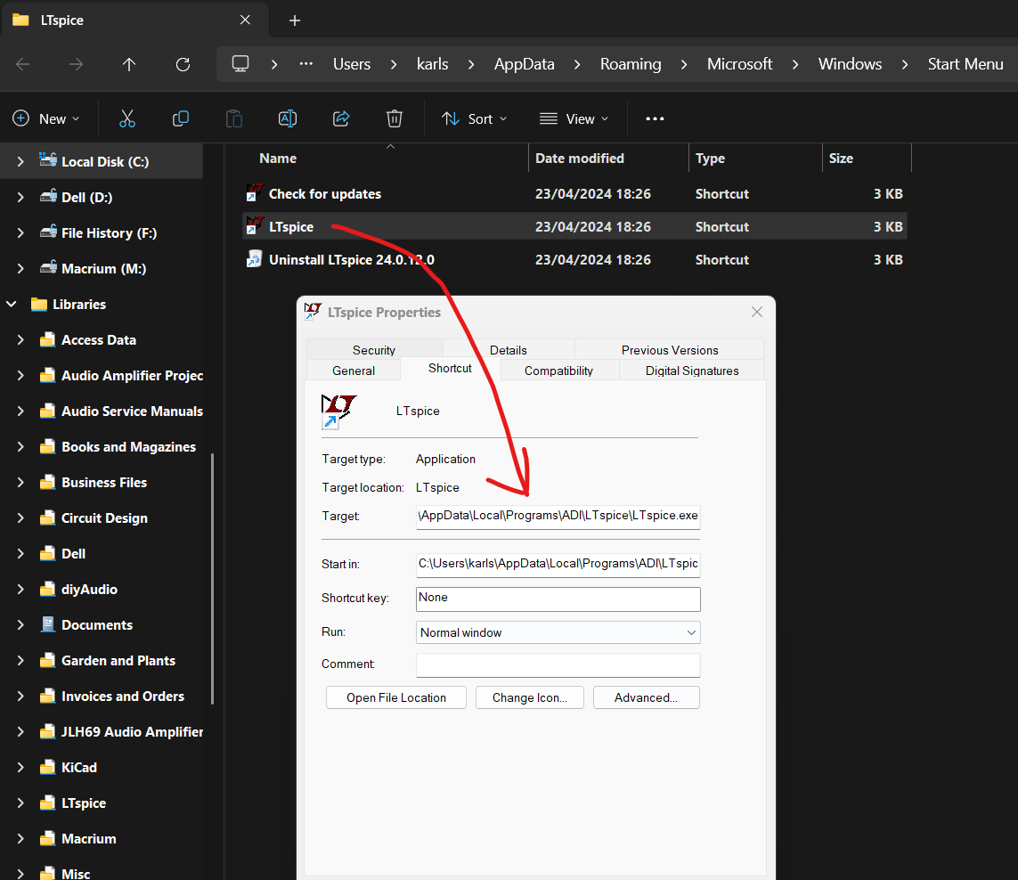

On Windows I created a shortcut to LTSpice on the desktop an set "run as administrator". Whenever I click on the shortcut, it opens LTSpice as administrator.
When I start a sim, a line below the circuit diagram shows:
"Waiting for permission to clear (File name) 9 seconds", counting down to zero seconds before the sim starts.
But then the message appears "Could not open include XXX.LIB"

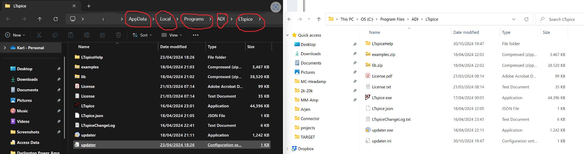

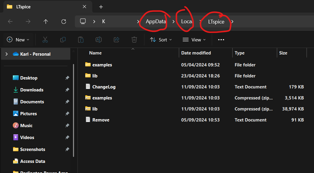

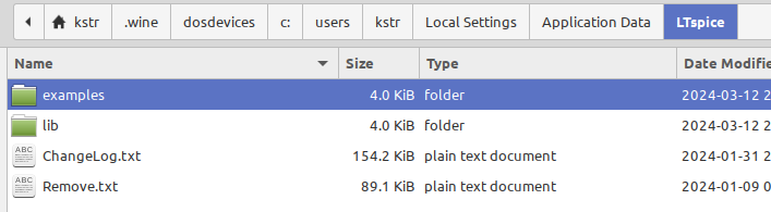

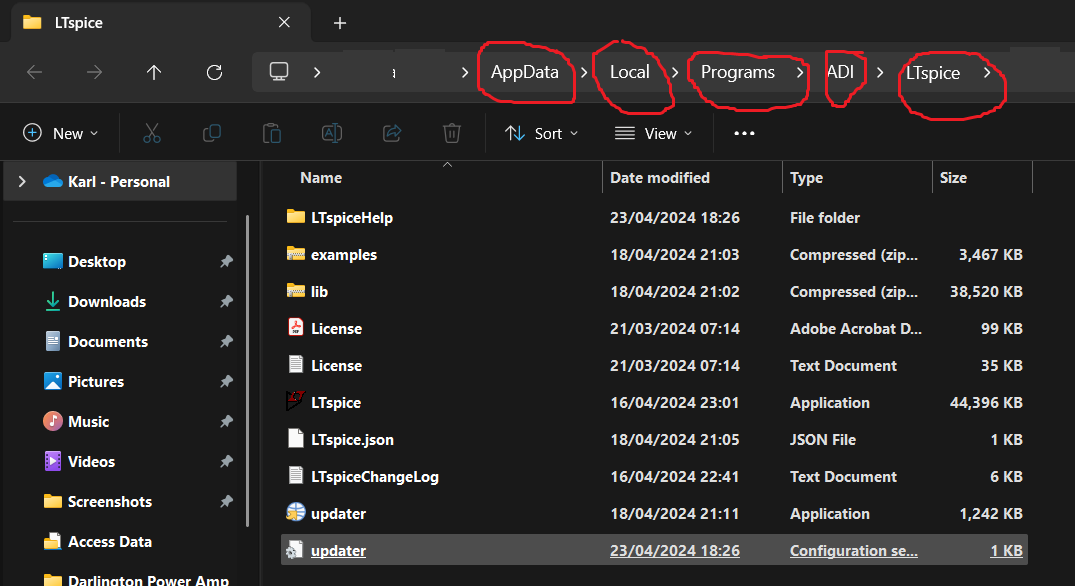

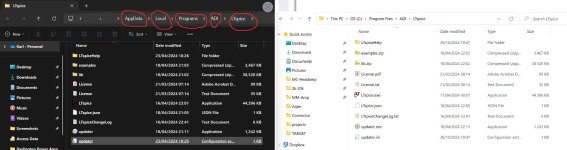

My install lives in the App Data folder because I chose 'install for me' I guess but I think you should see the same set of files and folder if you installed it to the Program Files. No idea if this gives any clues but this is what I see for my install.
In AppData:
And in AppData > Programs I have this. Note the dates and how nothing here has been altered since I installed LT24.

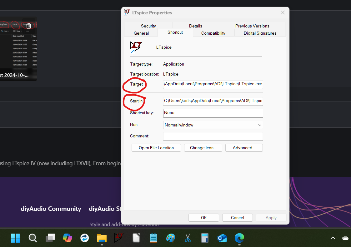

And the shortcut targets and where to open it.
All these are defaults though, I haven't altered anything.
Below in the attachments is what I see.

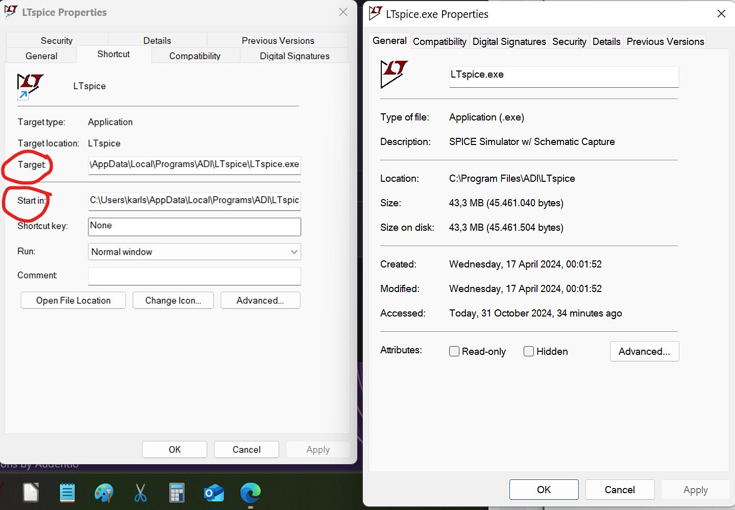

The content of the ADI/LTSpice Folder is identical, but when clicking on LTSpice to look for it's properties, things are different and the Shortcut tab is missing in my case.

That looks OK at this point. So yours is an install 'for all users' located in program files. It looks fine and I've compared it with my Windows test setup where I just today as a test clean installed LT to the program files. I see exactly the same as you show.

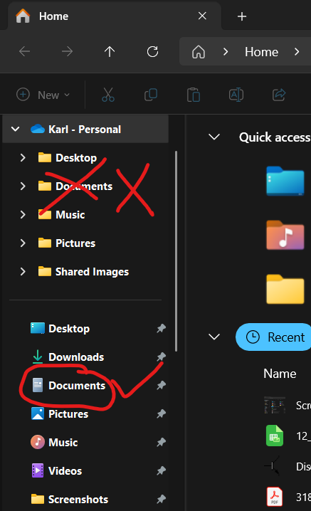

Has the installation created a folder called 'LTspice' in your Documents folder. This may make a difference and I would say it should be documents on your Windows install and not One Drive cloud based documents.
So just trying my new test install and opening it from the LT icon you show in program files and it opens OK. Placed a complex looking chip onto the workspace and saved the file and it automatically saved to the LT folder in Documents.

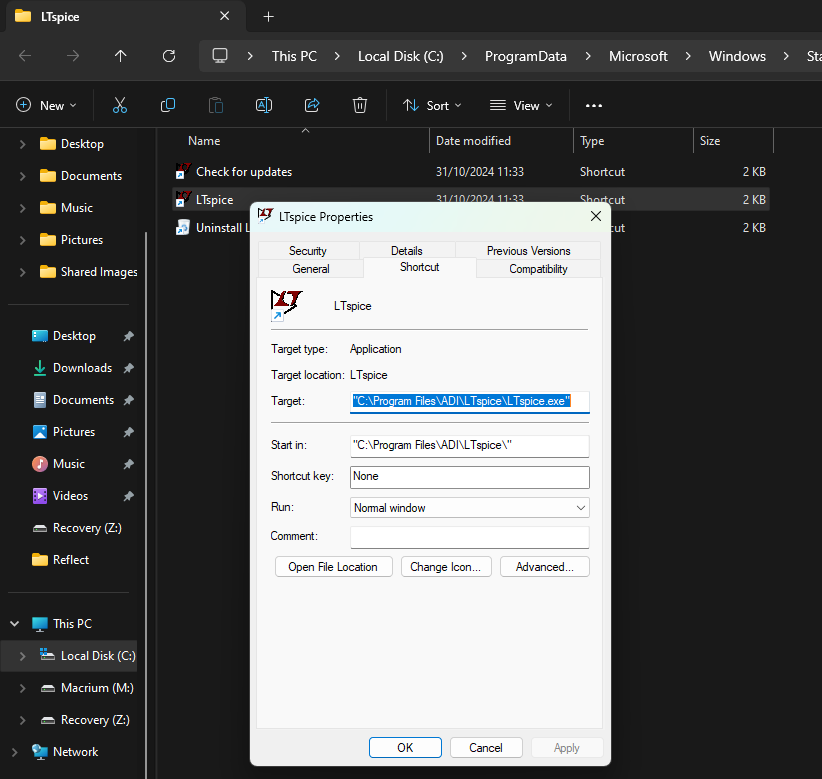

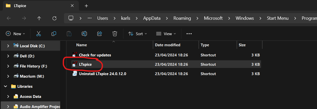

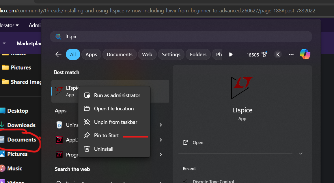

If you just search your PC for LTspice you can place a shortcut on the taskbar, the start menu or both. Just right click etc.
If I click the 'Open File Location' I see this. Edit... these images from my main setup.
The properties of that shortcut are:

If I look at the shortcut in the above image on my test setup I get this. So this reflects the difference in the two installs. One install to Appdata and one to Program Files.
Mooly,
Thx for investing your time, but I see you still have the Shortcut tab that's missing in my case.

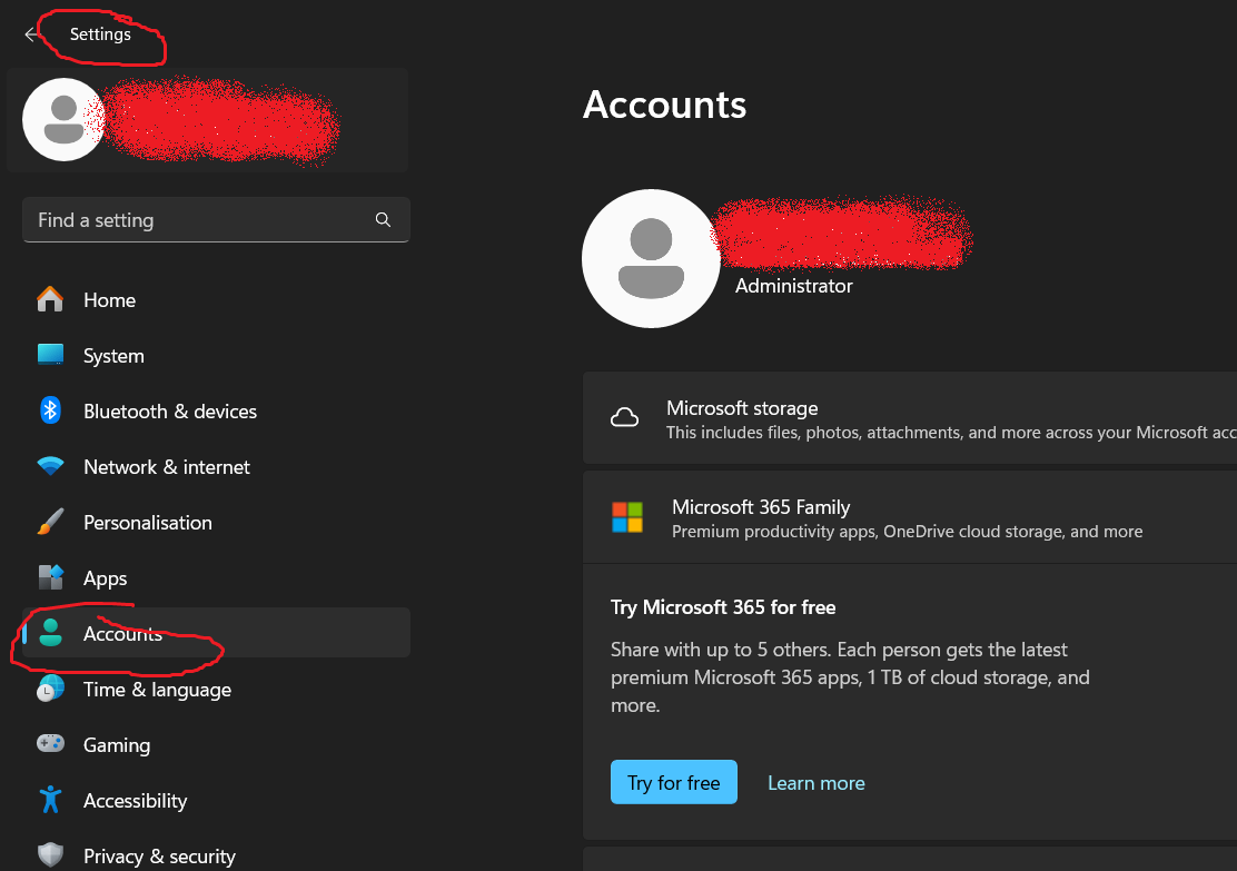

Is your Windows account on your PC as Admin one? or are you using an account without Admin properties?
If you go to settings and accounts...

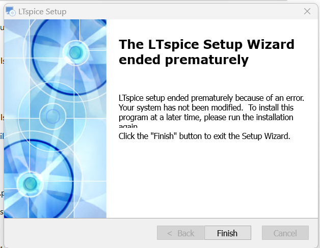

So LTSPICE attempted to install 24.0.12 over my older version of LTSpice and basically wiped it out. Worse than that I cannot install 24 at all on my Lenovo laptop running W11.
This version is apparently half baked and you might want to avoid updates until it is fixed. I am completely without any version of LTSpice at this point, because it uninstalled the previous version first. Going to try and install the last older version on the ADI site.
