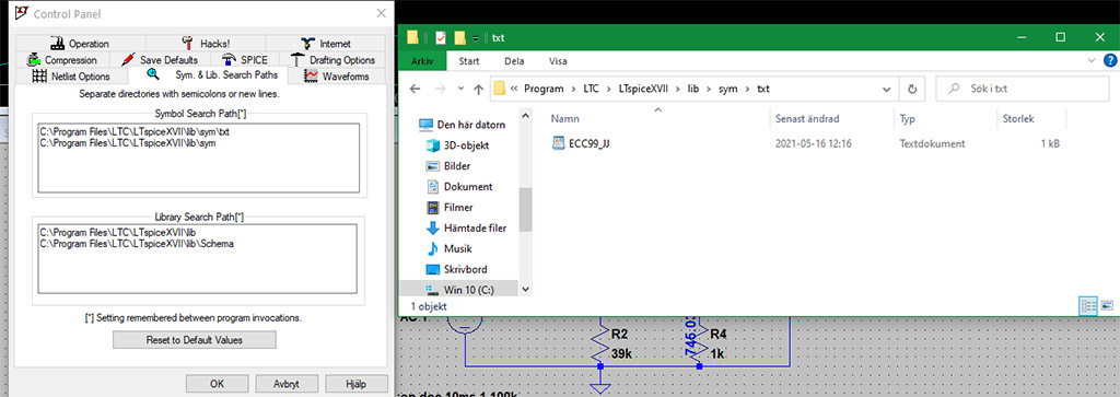

The message I get is:Fatal Error: Could not open include file "tube\ECC99_JJ.txt"
That really means that LTspice can't find that file. Open Tools|Control Panel and check the lib and symbol search paths. Is your tube\ECC99_JJ.txt on this path?
See attached example.
Jan

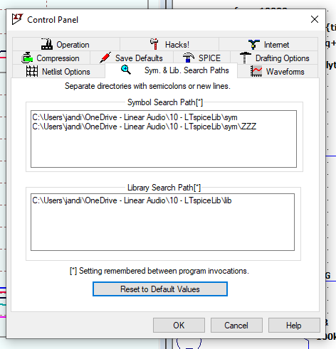

Now I have the txt file in more than one place and the path pointed to it but it still can´t find it (open it). anyone tried the txt file so that it is working as it should?
You need it only in one place. Can you post the various paths and where it is? Screen shots?

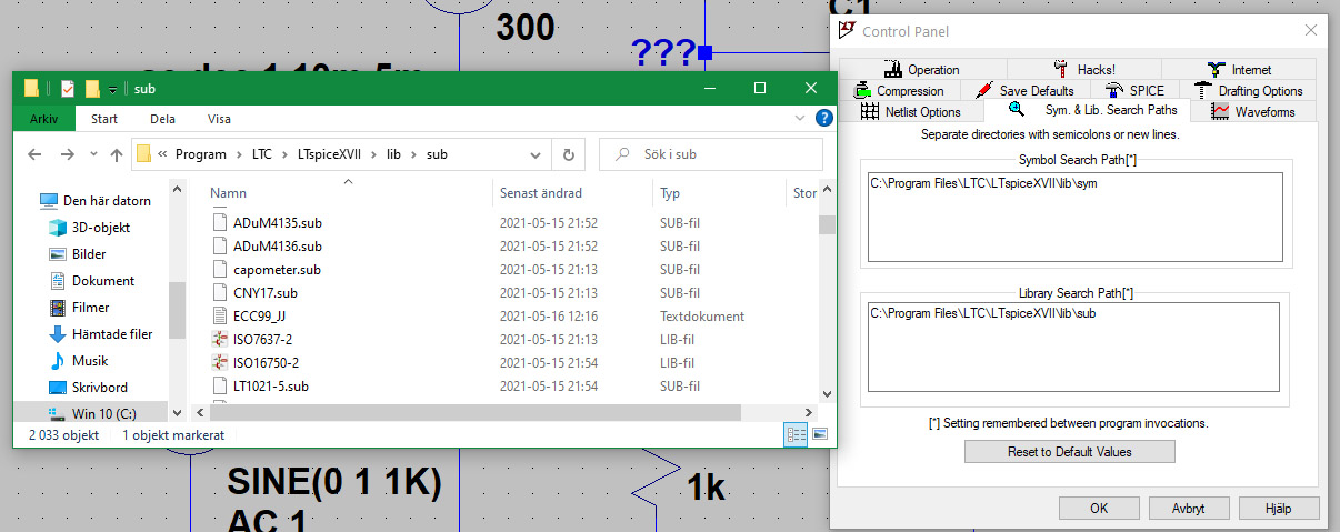

You have the model file in the wrong folder. You have it under lib\sym instead of lib\sub. LTspice is not going to look for a subcircuit or library file in the sym folder (or any of its subfolders).
I recommend that any folders that you create for user files be created under the lib\sub folder where they will be safe from being overwritten when LTspice is updated. I personally put my own "user" models in the lib\sub\User folder.
It is important to understand the difference between a symbol and a model (or model library). A symbol is just a drawing with some pins; the actual model is what represents the part, it has pin numbers that correspond to those on the symbol.
So you place a symbol, and then tell LTspice which model it should connect to.
Symbols and models (or model libraries) each have their own folders which you can point to.

You are going to have to change the include statement in your .asc simulation file to match. If the subcircuit file is in one of your specified path folders, then you need to remove the reference to the "tube" folder that you originally intended to use.
Try changing the include statement to the following:
.inc ECC99_JJ.txt

Storing these files in the "Program Files" folder is a carryover from LTspice IV. This was never a good Windows programming practice because of file permission issues that can arise, so when LTspice XVII was introduced these files were also copied to the user "Documents" folder upon installation. That is the location that you should use for all of your third party models and libraries. Storing these under Program Files is asking for trouble.
Also, as Jan pointed out, you are confusing symbols with subcircuits (or models). Based on what you have posted so far, I think you have "lots of tube models" and not "lots of tube symbols." LTspice provides generic symbols for all mainstream tubes, but you have to supply the models. This is a fundamental concept that you need to get comfortable with.
