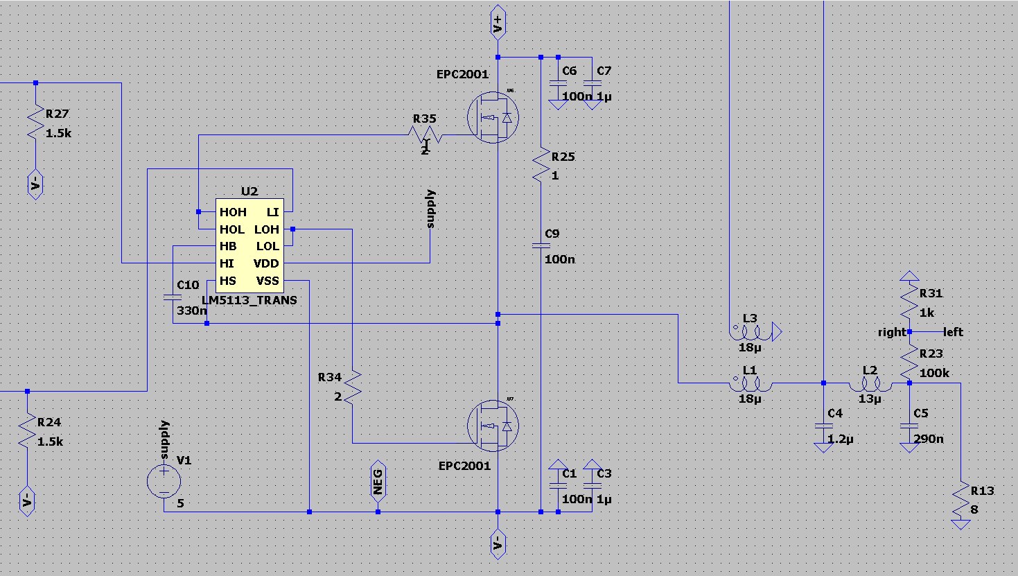

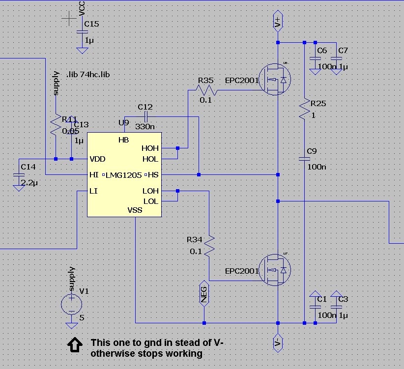

I try to simulate a flying cap stage, however do somebody now how to connect it to 4 switches and 2 drivers? and one flying capacitor want to use with symetric supply, in schematic it is done with single
supply, but for single I need symetrical afcourse, maybe somebody has tip or knowledge tot do it.

Kees maybe you should start a new thread on this, you might get more replies.
This is a circuit problem, has nothing to do with LTspice.

Hi
Maybe that is a good idea.
What is ltspice concerning is the mosfetdriver itselfs, normally there is a need of when using symerical supplys the supply of the driver ic needs connected there, however when I do that, model does not work anymore in LTspice, I do need to connect the negaive pin of the 5 volts to ground in stead of negative rail.

If you connect that voltage source bottom to -5V, your VDD 'supply' becomes 0V.
As noted, this is a circuit problem, nothing to do with LTspice.

Hi Jan
Not quite, it was the model itselfs who has a problem.
the model of the LMG5113 has no problem when tied the supply to the negatieve rail, what is needed for reference the mosfet source.
That is why the multilevel did not work, the model LMG1205 is as such not oke, connecting the supplt 5 volt to vss and negative rail do let it stop working, the supply 5 v was the problem, not vss, new model does fine..
I have however some strange behavior when simulating, defcon1 and a strange unstable continu run of the simulation time, but it does simulate and the signals looks oke.

So did you get a new model? What did you change?

Hi Jan
I did get a other one, the previous chip LM5113 who is the same as the LMG 1205 only older, the 1205 has updates ans has better bootstrap.
The LM 5113 I did import in LTspice and this one did work.
Now I can go on with testing multilevel.

Maybe the other had an internal ground connection in the model. Some opamps have that too, you cannot use them 'floating'.

I have seen a schematic example where she are used floating. And the older 5113 does work fine and is exact the same chip as the 1205 only the last has a better bootstrap, the lmg5113 did need a resistor and diode extra because of it, and is changed in the 1205 where it is not needed anymore.
I go write this in the new tread.
Can I see somewhere if ground is connected in model? you now, this ltstuff I am not that good in.
What strange, I did not touch the mouse and still this post did get placed, weird.
Here are the models, one does work lmg1205 not, but same parts, look at it just for fun.

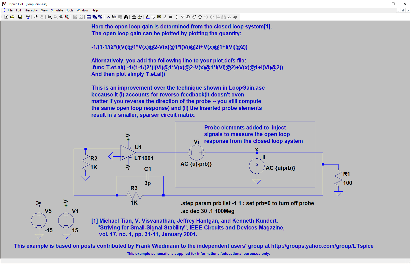

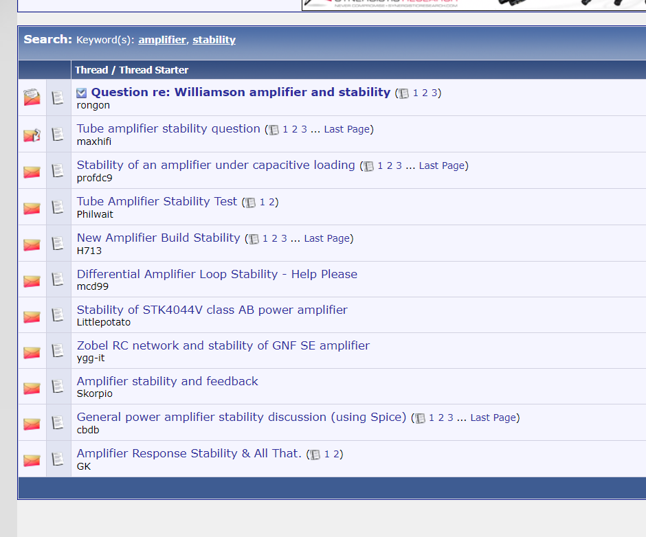

Your question is a circuit design problem, not an LTspice problem.
Although you might get an answer here, look for threads where the subject is amplifier stability or compensation.
Like the following, but there are more. Also, threads with 'Tian' or Middlebrook' in the title. Use the search function.
Jan
Jan
Thanx Jan.
I was thinking more of a general method.
My amplifier is just an example to better understand the procedure
Sorry for the off-topic post
There are examples within the LTSpice.lib provided by Frank Wiedmann.
See here his article on the subject.
Hans
Hans

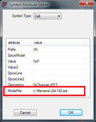

It looks like the asy file can't find the jfet model. Try editing the .asy file attributes, in the field "ModelFile" enter in the file path for the location of the 2sk182 jfet model, See attached example.
You can also drag and drop the jfet model into ltspice then with the mouse highlight the ".SUBCKT 2SJ28" then right click and create symbol.
