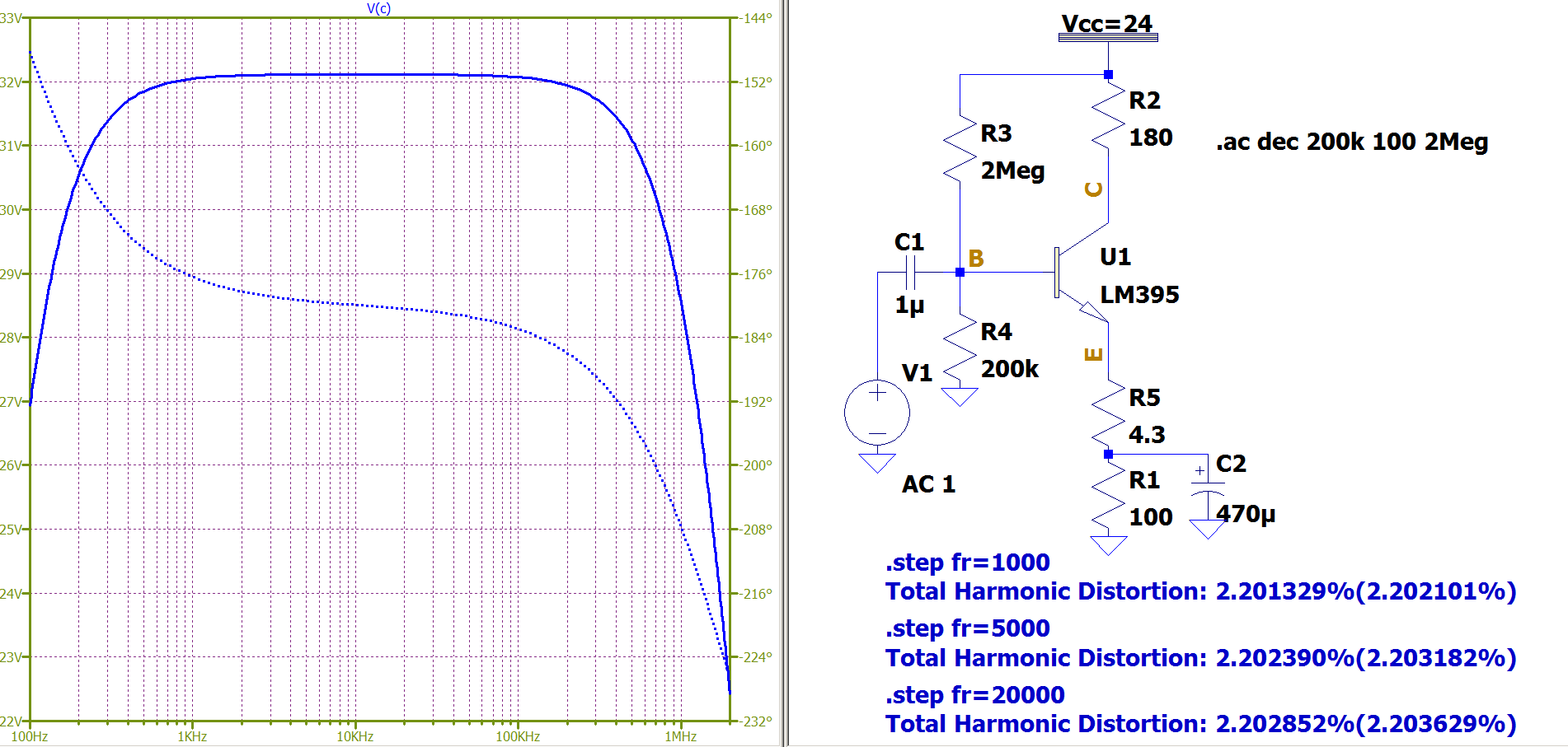

Let's put it this way: if I wanted to characterize the AC performance of the LM395, I would do it on the bench. I'm not saying you definitely can't make a decent model of the LM395, but it is going to be a lot of work... and how will you verify the model's performance? On the bench of course.
Bottom line, unless you really need a model for some reason, I think the fastest path to enlightenment will be on your bench.
YMMV.

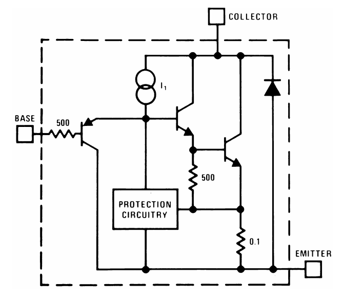

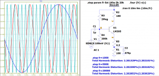

When using this (very, very simple circuit), what current can that current source be expected to be set to? 100uA sounds reasonable?
Jan
I can't say that's wrong, but I can't say it's right either.
My suspicion is that it's not set to a nominal value like 100 uA but rather it's scaled to the transistor whose base it drives so they track each other over temp & process variations but there's no way to tell. Again, representational...
You should have asked a few years ago, I could have just asked Dobkin, I bet he remembers! I don't do linkedin but if you do & you can find him he might answer you.
Joined 2011
Because I want I1 to be "comfortably" greater than the base current of the NPN. I decided that I'm comfortable when I1 = 3 * Ibase. Individual preference. Other designers may prefer a larger safety margin, to handle fast transients and to charge/discharge the inevitable capacitances on that node, quickly.

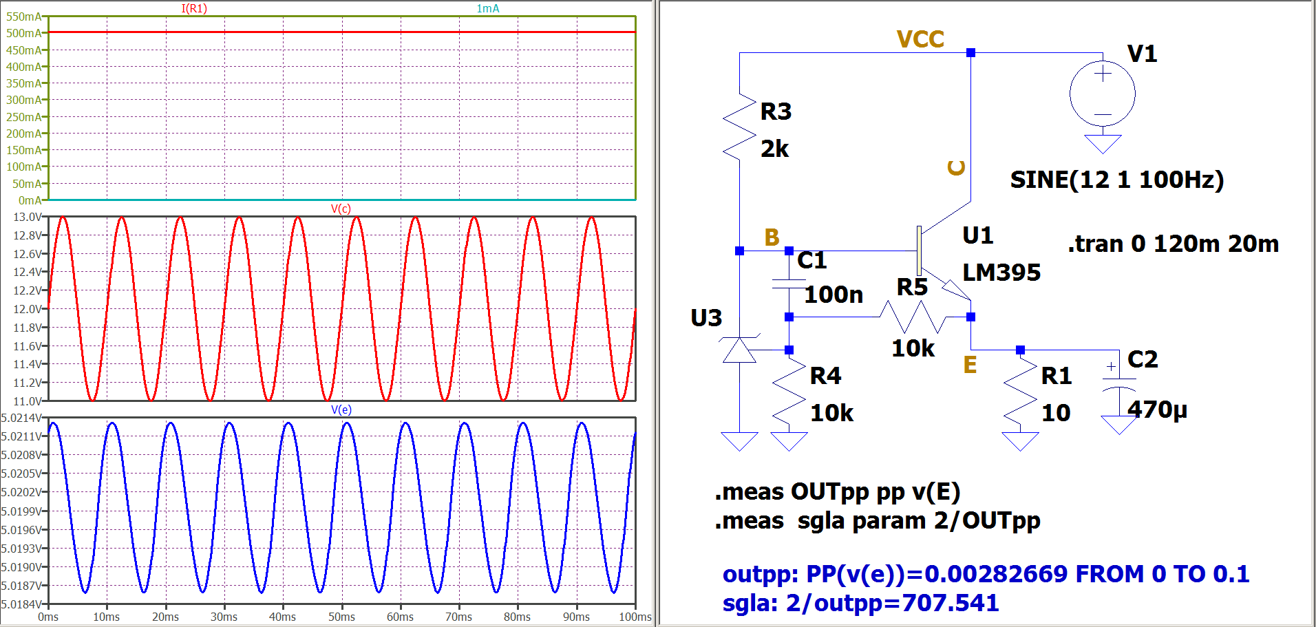

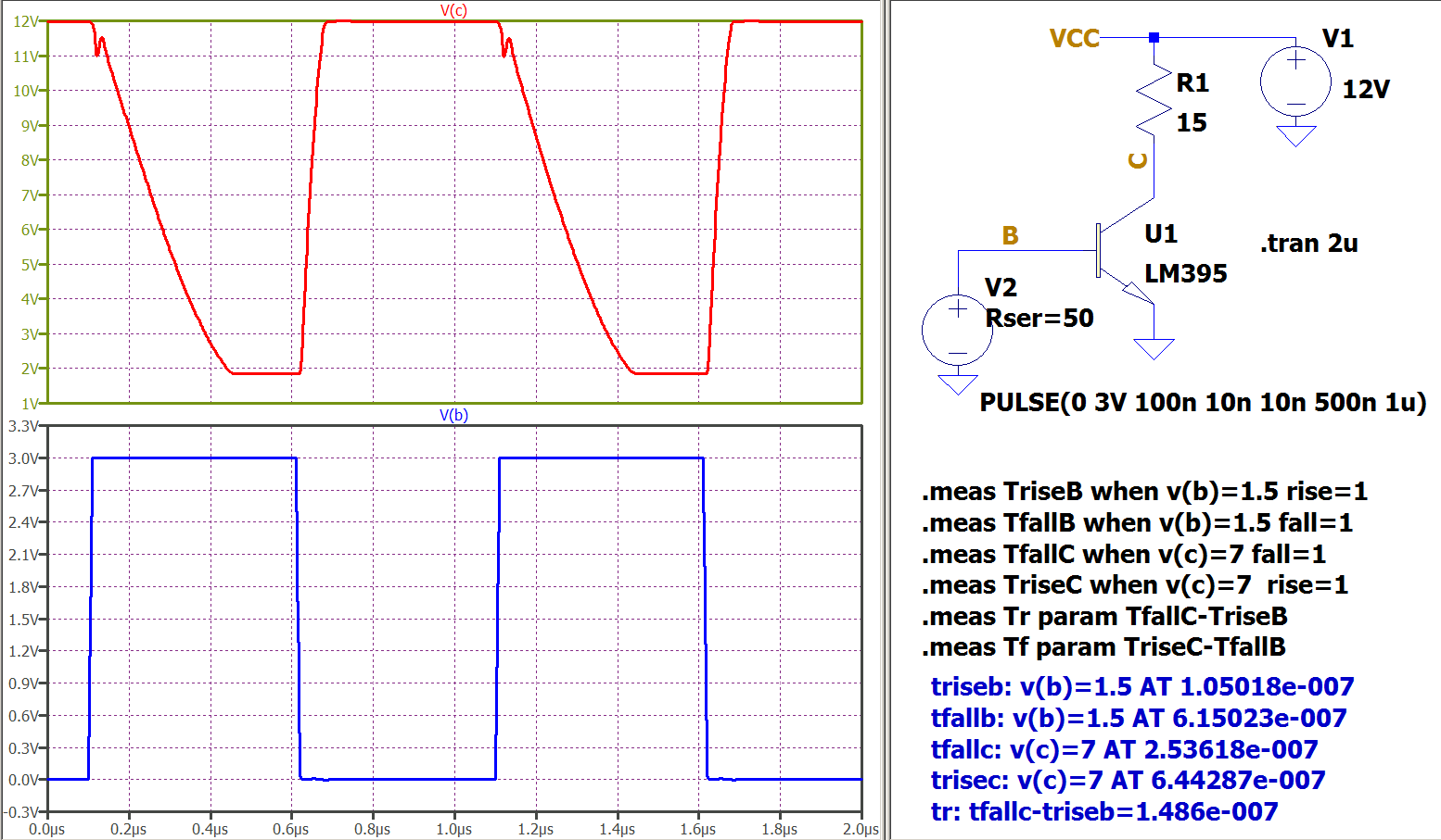

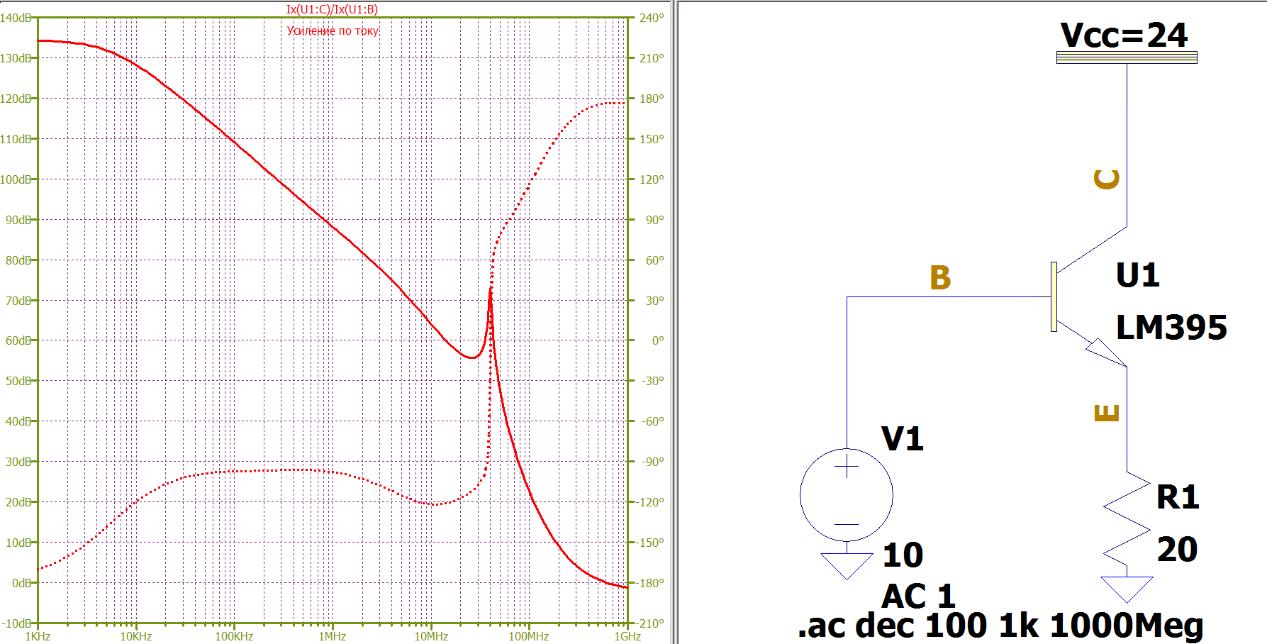

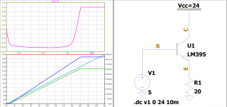

I took the model from TI (I have several of them). I threw out some transistors, resistors and capacitors. I changed one resistor to a 500 ohm rating and one end of that resistor became the base. If you look, you will see the lines commented out. I did not try to make the circuit 100% correct. I figured it would do just fine. Some of the auxiliary circuits are different than the LM317. They are designed to trigger (turn on) the reference voltage. But the circuit works this way too. And this circuit is outside of amplifier transistors.
The model I sent does not match the datasheet. When I found this out, I corrected the resistor values to those given in the schematic in the datasheet. But it turned out even worse. Maybe that is why the spice model was not uploaded. I decided to ignore these resistor values. I had to expand the list of parameters. I entered the breakdown voltages.
I am sending the new model and test circuits. I would be glad if someone would test the model and give comments.
