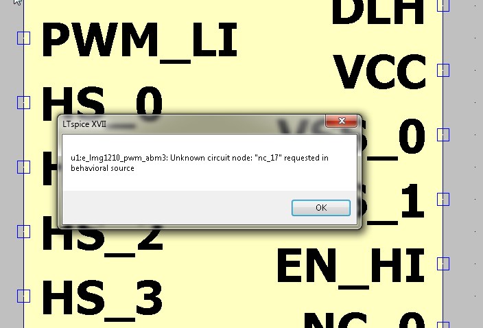

I had also did make a other part, also a lmg but this time a 1210.
These did give a error. Yours do fine Thanks. Now I now also how to automate the part, just load the lib and richt mouse click.

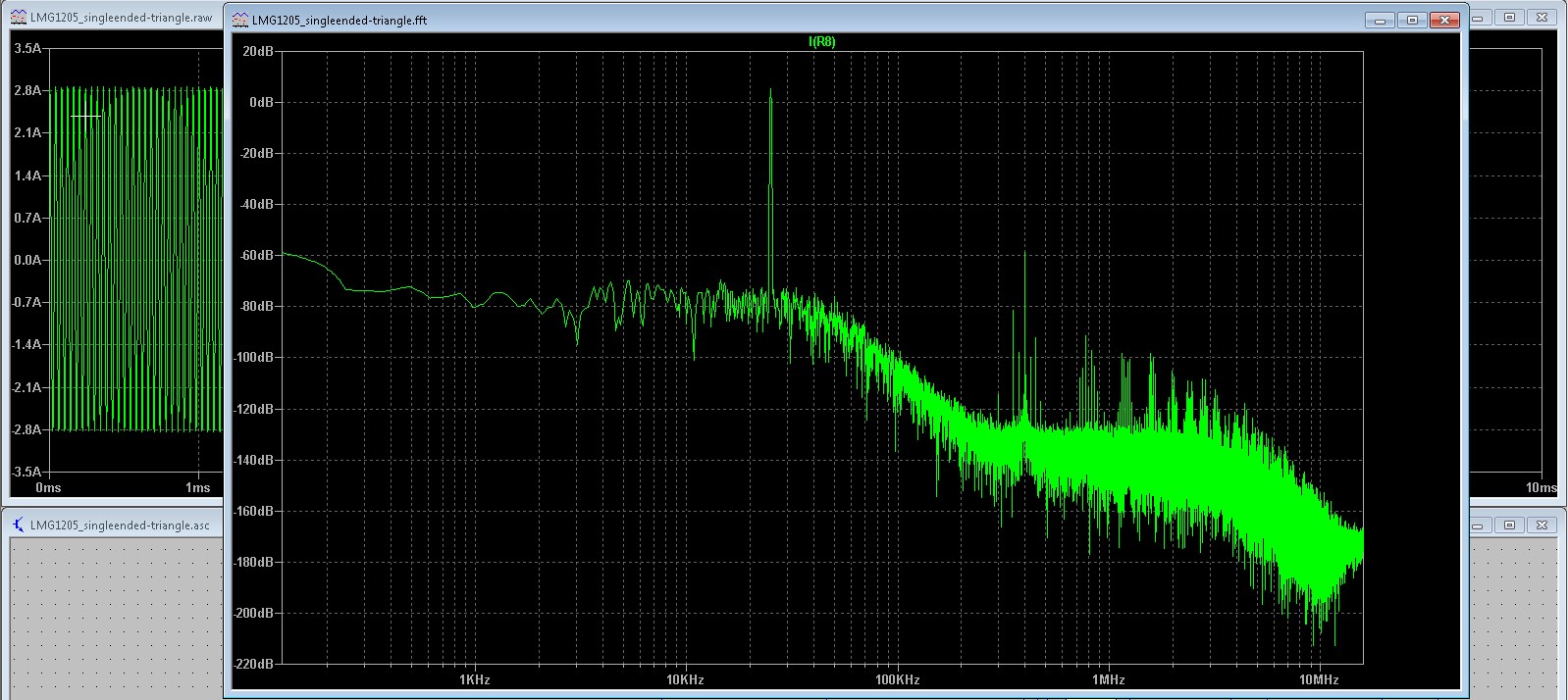

Here the sim, this is a open loop test, Gan is promissing stuf, very fast.
The other pic you see what the error is, do not see the pin NC_17 into lib by the way.

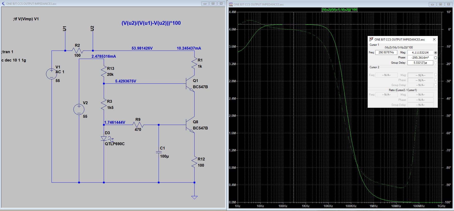

I made this circuit but now I am reading the ccs load resistor impedance (2kohm).
That seems about right. In theory, you would measure the 2k in parallel with the collector impedance which is much higher.
Do a .tran and look at the collector signal, to make sure the test current is a nice sine and the stage is not clipping.

Yes is this one. but is this a subcircuit? I have only the .lib like the other one, who work very good so far.
This is a "library" file containing a number of subcircuits, most of which have specialized purposes. The one that is relevant is the very first one in the file, labeled ".SUBCKT LMG1210." This is a rather complicated model, with 21 "pins," and like the LMG1205 model, some of these pins are duplicates that are connected together internally. In the physical pin-out diagram on page 3 of the datasheet (see link below), there are 3 pins plus a pad labeled HS, 4 pins labeled NC or NC1 (for no connection), and 2 pins plus a pad labeled VSS. So you could create a symbol that consolidates these duplicate pins into one each (and ignore the NC pins) so that you have a symbol that looks like the one shown in section 8.2 on page 16 of the datasheet, which has only 12 identified pins. This is what I did for the LMG1205 "alternate" symbol. Give this a try and see if you can make that work; it will be a good learning experience!

He cannot, because only one of them can has the "AC 1" stimulus. He seems to be on the right track now with his impedance measurements.
Correct... the bias circuit for the cascode device should remain frozen.. stable... and can not be modulated by the measuring ac sweep.

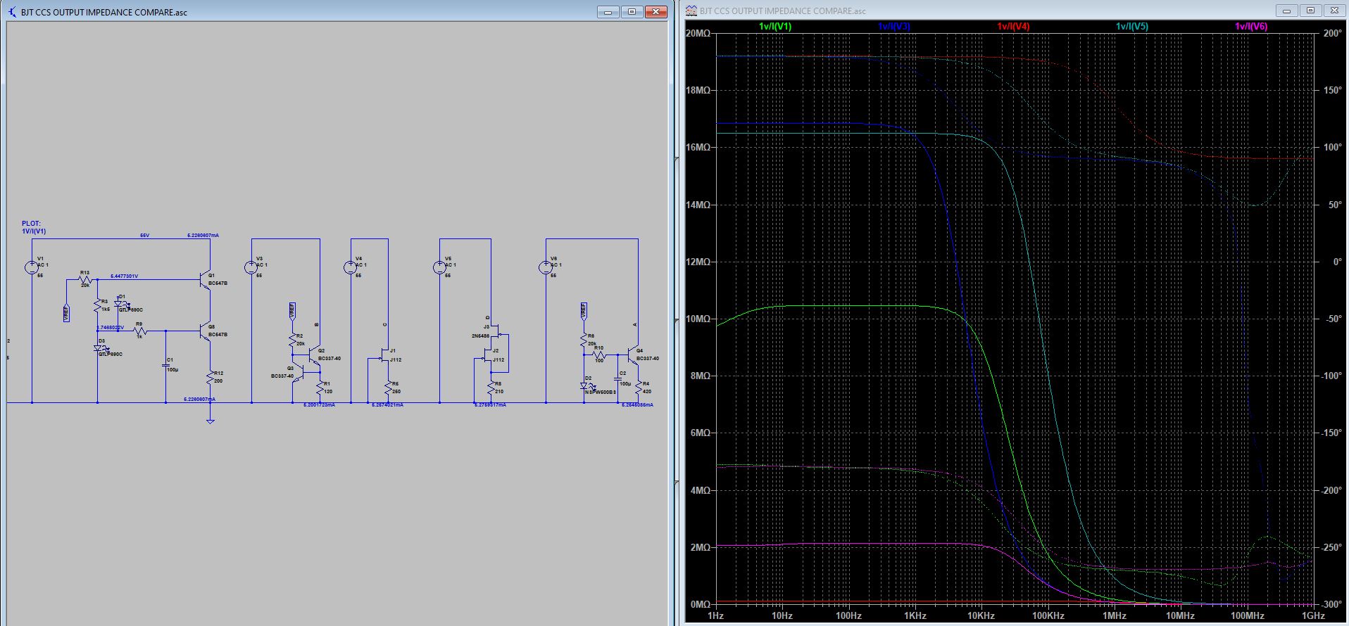

I am comparing the output impedances of several different ccs for my most recent power amp.

It seems to me that you could delete R1 and R2 and simply read the current source impedance as 1/I(V1), given that you are providing an AC 1 stimulus.
Simple procedure: mimic the output voltage of your current source with the DC value of V1. V1 also has AC 1. Impedance = 1/I(V1).

Thank you so much.
Yours is the best solution.
Now I can clearly see the differences in impedance between the several ccs.

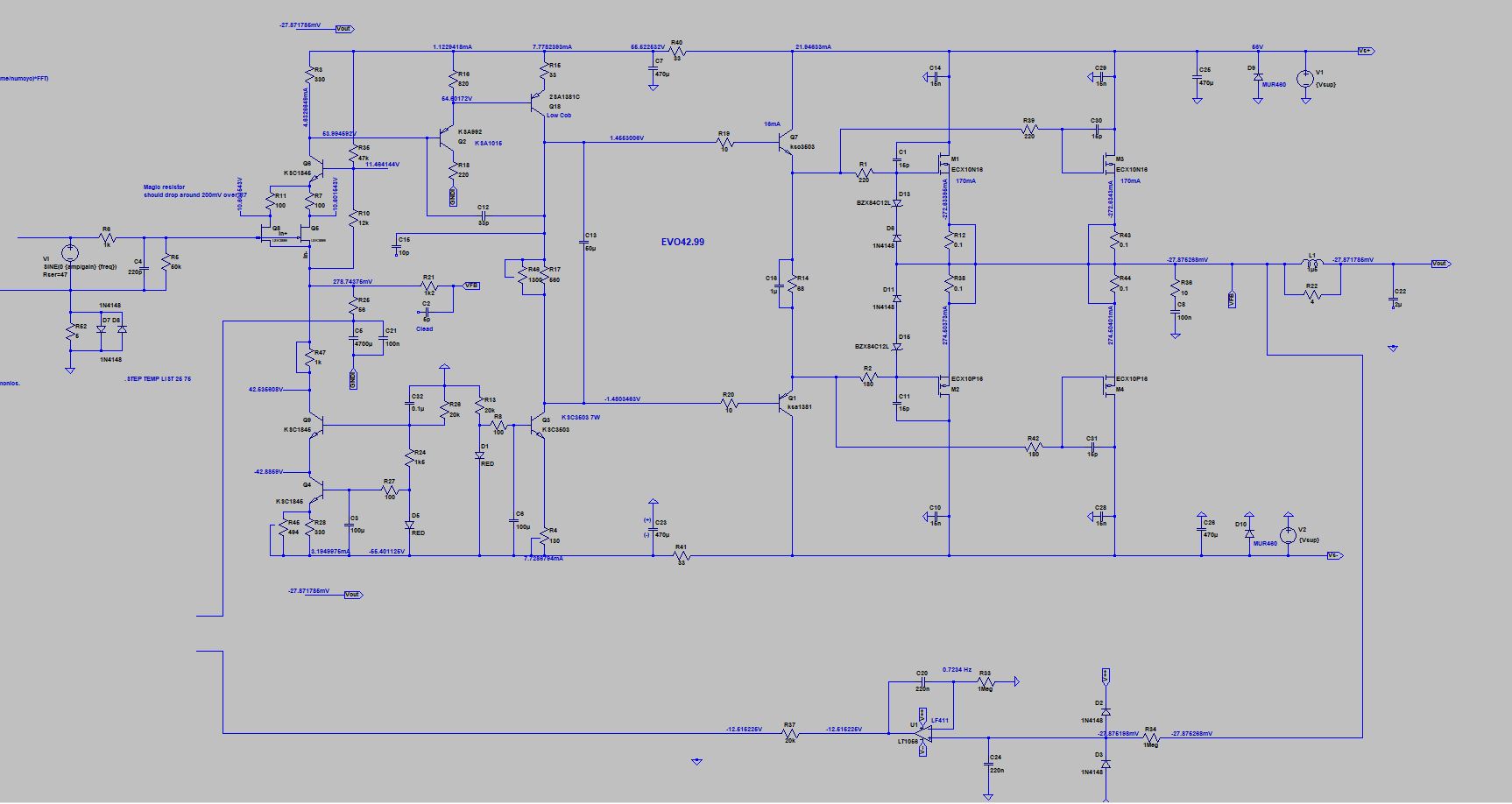

What kind of circuit is this supposed to be, how will you use it? Can you show the actual application it will be used in, probably then it can be determined how to realistically test it. The way it is now you really test a single transistor because the whole biasing stuff is excluded from the test.
Jan
Hi Jan
Here is the amp I am working on.
I am using a cascoded ccs for the IPS and a single bjt ccs for the VAS.
I need to determine the best value for R8 (vas ccs base stopper / RC filter) as it seems I can change THD distribution just by changing this resistor.
With R8 set to 1kohm, 3rd disappears.
