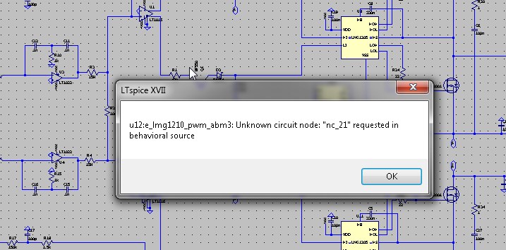

I have managed to let it work, but much errors in model.
Strange because people use it, however I have a class d who has symetrical voltages and not a ground for VSS because I do need reference from there for inputs. I do not now if this is possible at all with this chip. The lmg1205 does well.
The errors where because I had nothing connected.
I get this after sim, see pic.
regards

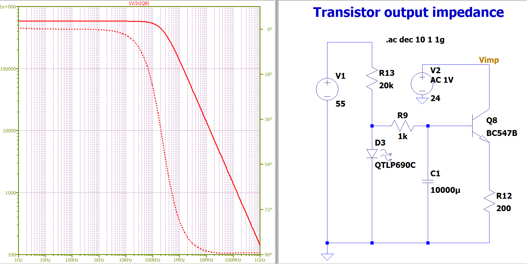

Those ccs are directly proportional to the bias current. For bjts Rout=Va/Ic2 where Va is the constant Early voltage. So if your collector bias was decreased by half the out impedance doubles. Run your sim agian but step the bias to see this effect. ( hopefully your models have a proper Va, many Dont). Fets are similar.

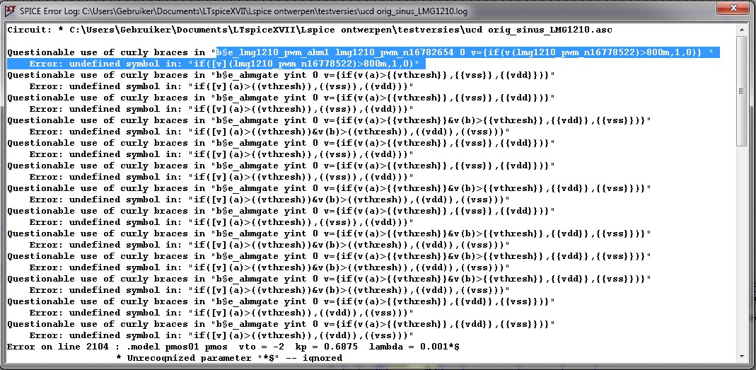

The model does work only the lower mosfet, and I get error about questionable error.
Here is somethibng about that, but that b$e where LTspice does complain about I can not found in wordpad looking at it.
https://e2e.ti.com/support/tools/sim-hw-system-design/f/234/t/646929
Here she mention remove these but I can't find them in normal tekst search in tekst editor see blue colored part, It is not in .lib, so maybe tekst fault, ansi or something?

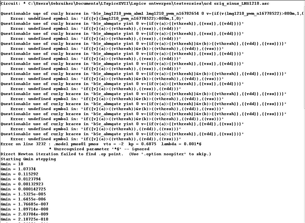

What is happening here?

Curly braces are typically used to denote parameters, and a look at the subcircuit shows that the curly brace is used in several places where ordinary parentheses probably should be used instead. Trying to find and correct all of these instances would be tedious and prone to human error. In any case, LTspice flags these as warnings, not errors, so the simulation should continue to run unless LTspice encounters some other error.
A Google search indicates that a number of LTspice users have encountered problems with the LMG1210 model, although the symptoms appear to be different depending on the specific schematic. I'm not familiar enough with this chip to troubleshoot its SPICE model so I'm not sure I can help much more. Maybe someone else who has run simulations with this device can weigh in.
Open the model file with a text editor and make a mass substitution:
{{vdd}} --> vdd
{{vss}} --> vss
{{vthresh}} --> vthresh
Also make the substitution
lambda = 0.001*S -->lambda=10m
Other adjustments may be necessary, but the above are mandatory.
{{vdd}} --> vdd
{{vss}} --> vss
Searching with search on a texteditor do not work well, only typing capital letters did work in some way but
managed it, oke the vss I did see have just one curly bracket and that is oke because remove it will give errors.
I have only edited lambda = 0.001*S -->lambda=10m twice and this did let remove the errors.
I get only lower fet switching not the upper one, so that need attention in schematic, like vdd vss ground uplift.
Collector current is set with the emitter resistor.
To reduce collector current we increase emitter resistor and this increases impedance.
Am I reasoning correctly ?

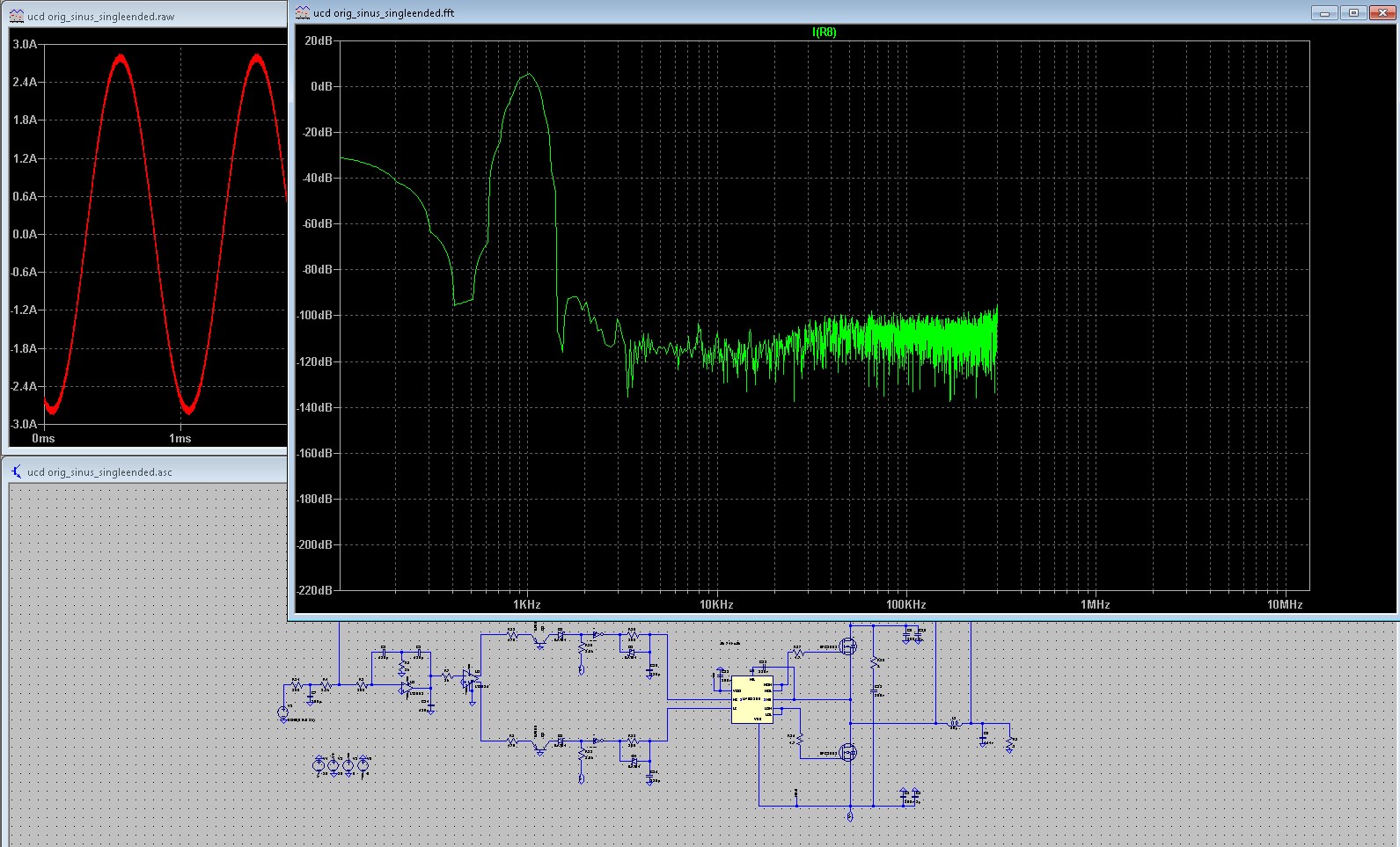

Using this simulation command:
.tran 0 45m 5m 0.01u
To get nice clean FFT results like this:
I am generating .raw files of 1.6gb !
Is there any way to instruct LTspice to delete this .raw file when the .raw window is closed to avoid the build up of vast amounts of data ?
Thanks in advance
mike
Tools=>Control Panel=>Operation, check the automatically delete .raw files option box.
That works most of the time. Sometimes it doesn't. I had this argument with Mike E a couple of times, he said impossible, it always works, end of story. I wonder if the new guy will fix it.
