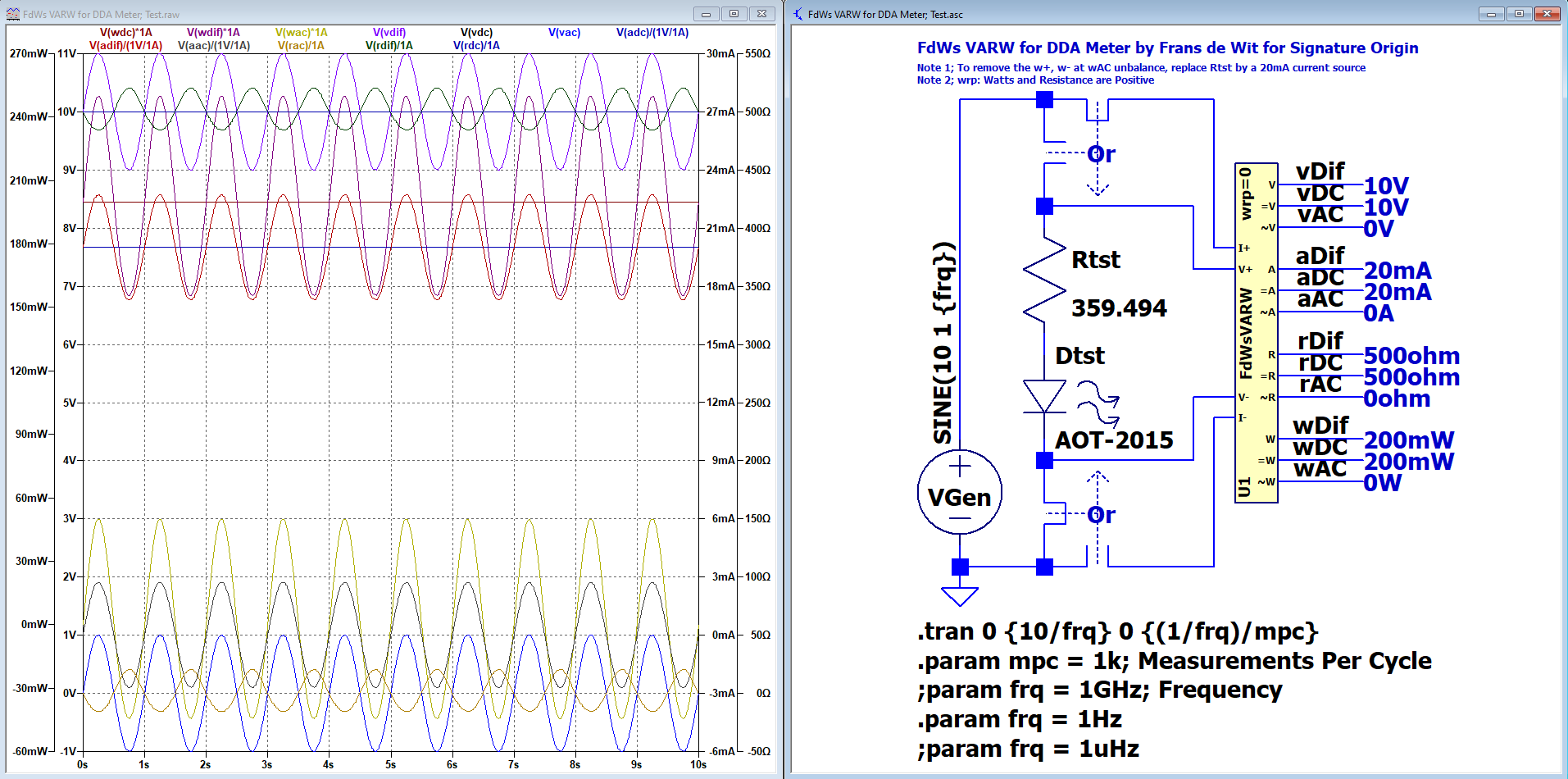

It's a measurement device called 'VARW', it has 3 connections that input current and voltage, and a demo circuit as supplied.
The demo circuit also shows how to annotate measured values correctly as V(volt), A(Ampere), R(resistance) and W(watt).
The signal pins on the VARW provide life signals as shown in the graphs, not that static s**t as provided by the '.op Data label'
Also the VARW floats, thus needs no ground. It can measure differential voltages and currents any ware in the circuit being simulated.
Just download the Zip-file, extract an run the 'FdWs VARW for DDA Meter; Test.asc' simulation.

Download the ZIP, it includes the source, as see how it is done.
Or, here, just connect the open circuit point to ground by using a zero voltage or zero current source (depending on the need for a zero or open impedance).
Any way try it, it's all there and free

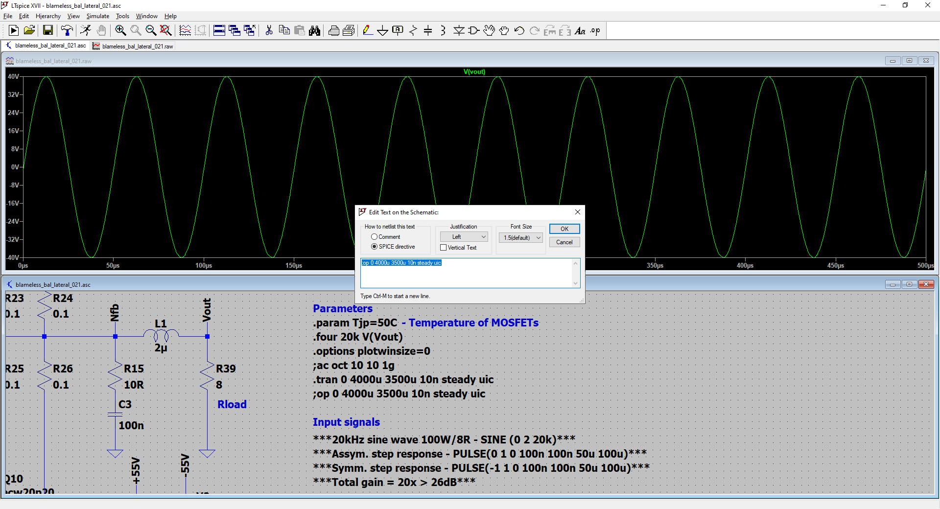

I just installed the latest version of LTspice and now I have to manually put in the simulation command every time? Obviously I have the .tran, .op, .ac etc. simulation commands listed in the schematic, but for some reason it now asks for manual input? I looked through the help files and searched through this topic, but to no avail? If anyone has a solution on how to have LTspice simply pick the simulation commands listed in the schematic like it used to please let me know, as I'm starting to wear out my keyboard!

It took me ages to try and make sense of it all when I first started using this version and all Mike Englehardt would say was that it was 'by design' and that it would make using it easier in the long run... and actually once you get how it works it does.

So you can set up loads of different simulation directives all on the same workspace and then call any up as required.

I'm sorry, please reread what I wrote, I have all the directives in the schematic, yet I still have to enter the simulation command manually every time I want to start a different simulation.
I.e. I used to be able to switch from a .ac to a .tran simulation with a few mouseclicks, now I have to enter the new simulation commands manually despite the directives being on the schematic. Also, this was *not* the case with the version I used to run, and I now regret upgrading.
