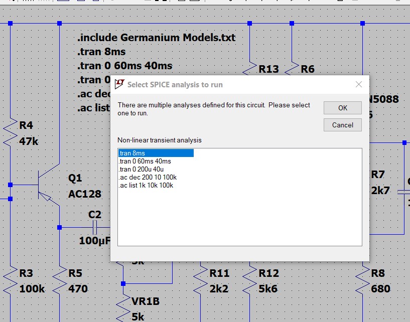

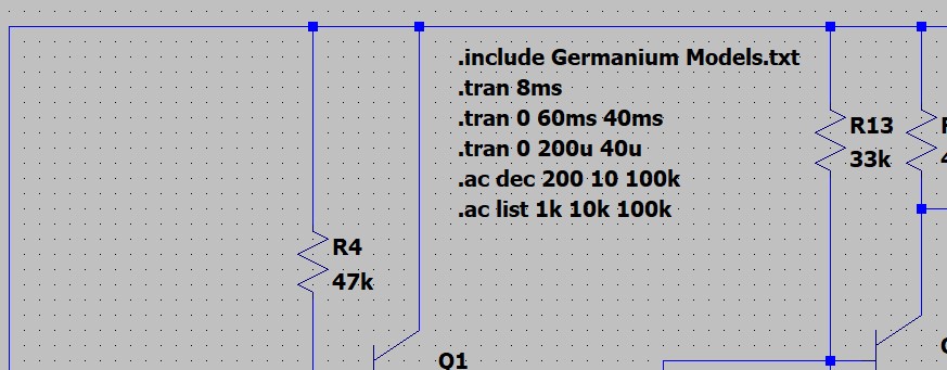

One thing you can do is set them all up as directives as shown here and when you click run you get offered what particular directive you want to run.
You pick one and click OK. All good, it runs. All the other directive get prefixed by ; instead of .
Then hit F9 (undo) and all the directives are changed back to . again.
So any of those five directive can be run with one single press of 'F9' followed by run.
I'm sure Mike didn't envisage that though.

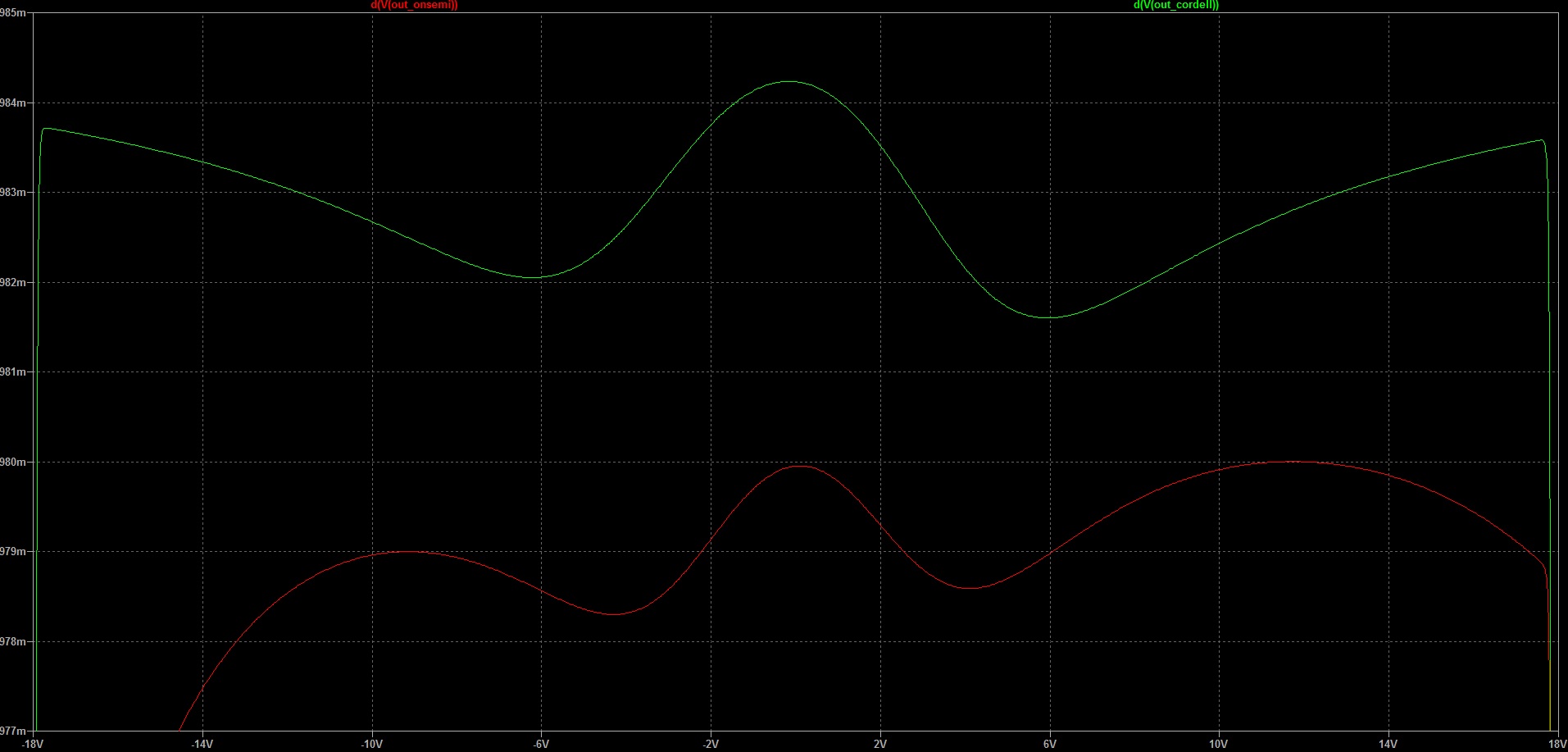

mje243/mje253 spice models - completely different results

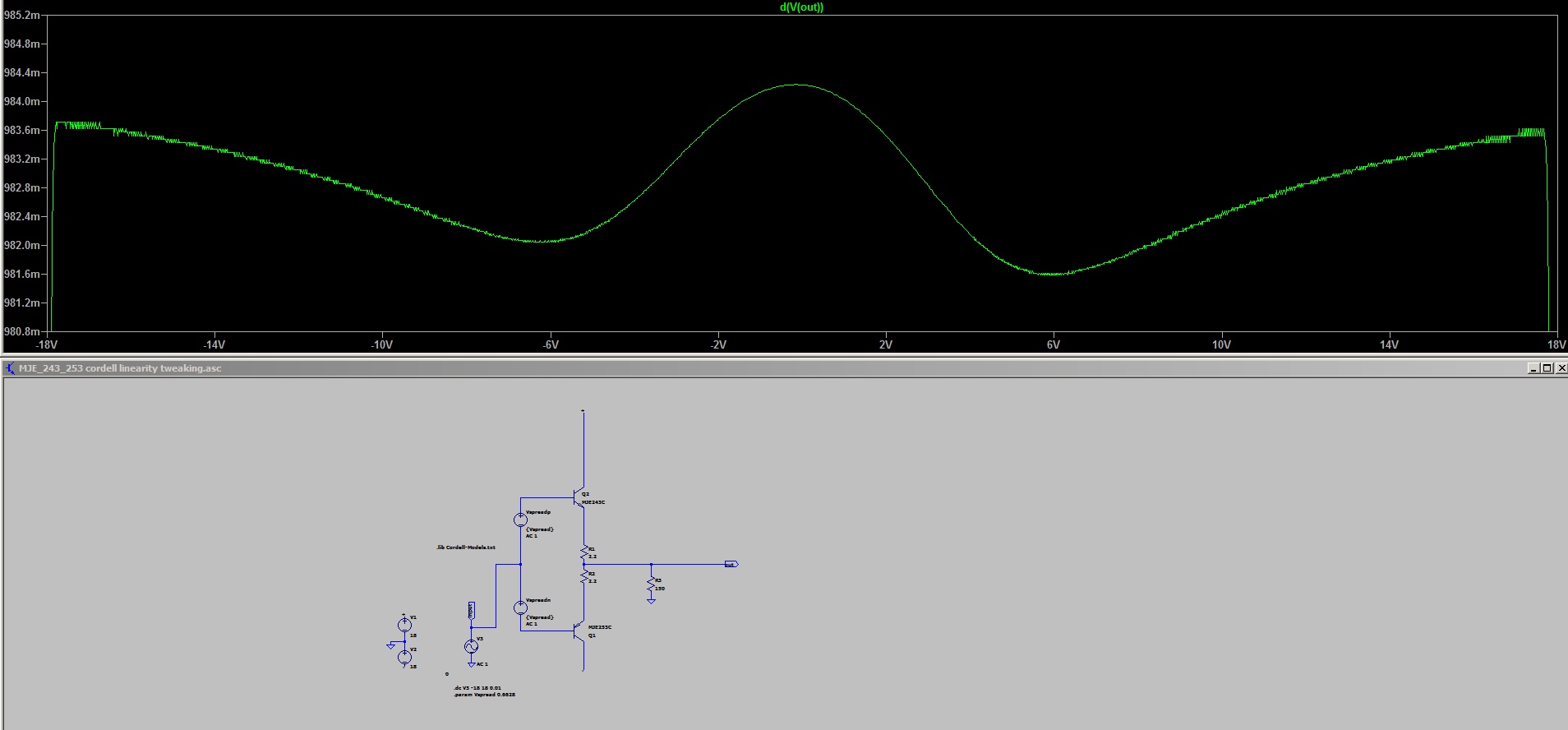

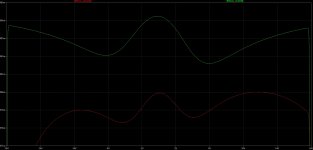

I tried to run wingspread simulations to compare the gain curve of two different spice models. While I expected to see differences in the gain distribution the almost opposite direction of the slope and the depth of the waviness of the curve surprised me a bit.
On-semi spice models
919178d1612555083-installing-using-ltspice-iv-including-ltxvii-beginner-advanced-mje243_253_on_semi_bjt-jpg
Cordell spice models
919179d1612555132-installing-using-ltspice-iv-including-ltxvii-beginner-advanced-mje243_253_cordell_bjt-jpg
I believe that Bob Cordell's models can be trusted, although the smaller and more rippled gain on the npn side is somewhat counterintuitive. On the other hand, I have read about the problems the factory on_semi models cause with ac analysis and the difference in the dc transfer of the two transistors is glaring here. And this is where doubts arise about the accuracy of other available models. I've just started exploring the simulation world from so-called 'kitchen side' and I can't quite verify how the code matches up to reality. Can the stock LTspice library be trusted and which manufacturer's resources should be avoided?

I tried to run wingspread simulations to compare the gain curve of two different spice models...
I had tried once to make a database of transistor models, but found that many of them gave very different results from the datasheet, and abandoned the project.
The most accurate models were undoubtedly Bob Cordell's. I wouldn't really trust the models that one finds floating around the internet, there's a huge amount of out of date and inaccurate stuff out there. The stock library models are probably OK, though I stick to Bob's as much as possible.

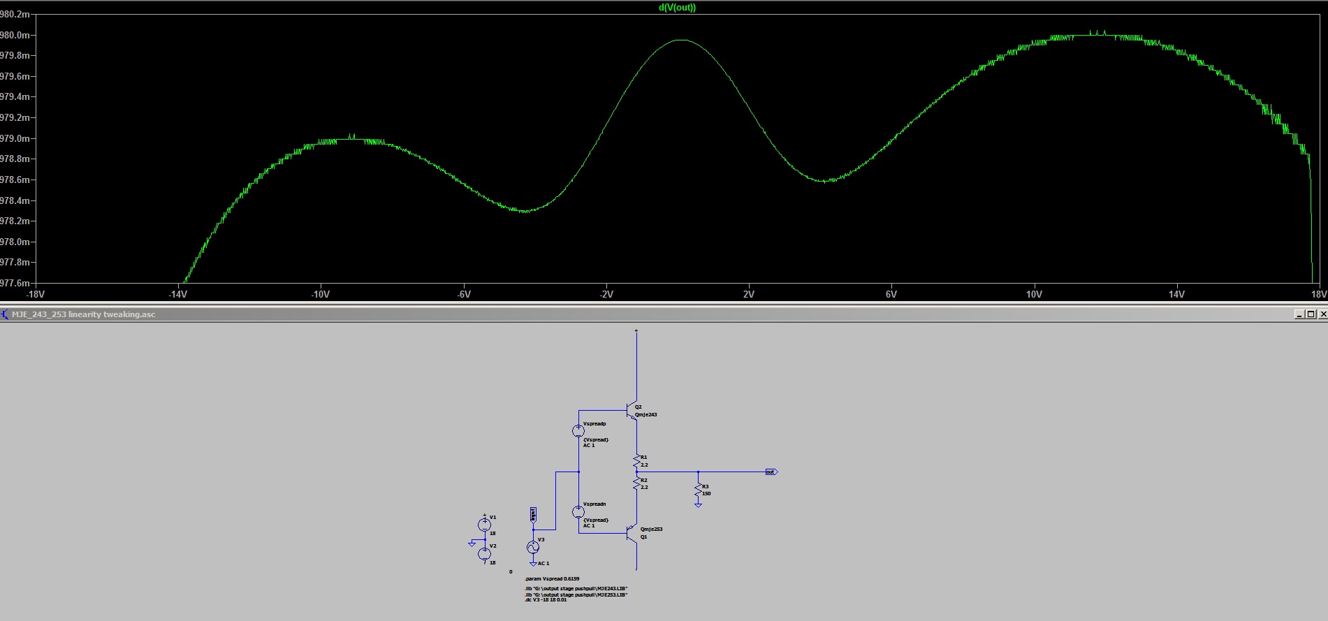

The jagged effect in your plots are rounding errors due to the limited resolution of LTspice's maths routines. To improve the resolution, the first steps to take are to include the following statements on your circuit:
.option plotwinsize=0
.option numdgt=7
The first disables data compression, the second sets double precision for the output data.
For consistency, I personally think it's a good idea to use .plt files to force all wingspread plots to have the same y-axis limits, e.g. 0.9 to 1.0 - this makes it much easier to make valid visual comparisons between plots.
It's virtually impossible to see the details of your sims from your screenshots. If you post a zipped folder containing your .asc files, along with all supporting files such as models and .plt files, I'm sure either I or someone else will be able to offer additional advice.
Thanks for your reply, your comment has helped me to clear up a few doubts. I read some really negative opinions about some of the models released by onsemi over a decade ago. It seems they haven't updated anything since then - the same files are still hanging on their site. It is a little surprising. After all, these aren't some files flying around the internet but official models of their own products, right? At least I know I can't find anything more accurate than Cordell's bjts. 🙂

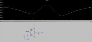

Ok, but it really isn't anything fascinating. A simple push-pull stage with idealised bias sources with the voltage selected to simply achieve a reasonable compromise in the linearity of that stage at the lowest expected load resistance. Ic is slightly different but the characteristic shapes are more or less preserved for the current range that interests me. With the onsemi models, the pnp side is clearly weaker and shows a stronger drop in gain (static crossover distortion) while the Cordell's models show the opposite tendency (npn weaker). Here the improved (according to your recommendations) clearer graph containing results of these two simulations:
If you think about it, choosing a side driven through the bias spreader with non-zero impedance can increase or decrease distortion. It may turn out that closer to the ideal cfp vbe multiplier will give a worse result than a simple circuit based on one transistor or a series of diodes.:bulb:😀
It's not a big deal but would be interested to know what trend these components actually exhibit and why it happens. I would guess that the hfe itself has rather little to say here, so is it related to the base resistance or perhaps one of the parameters responsible for beta droop?
