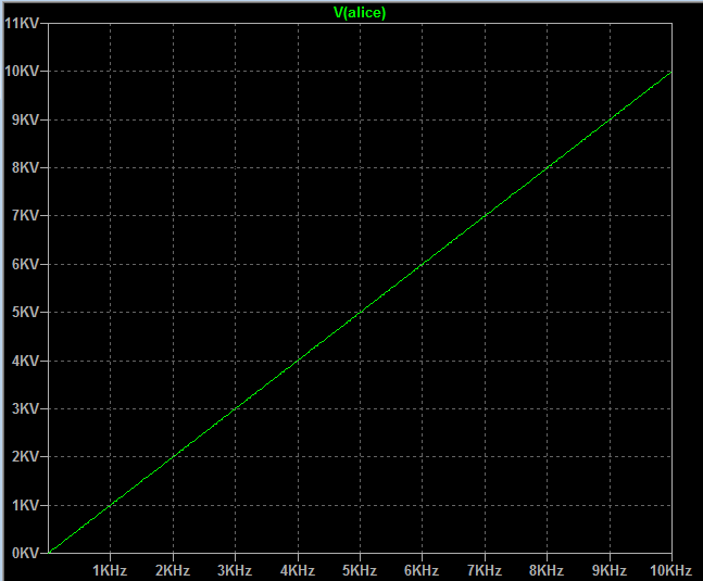

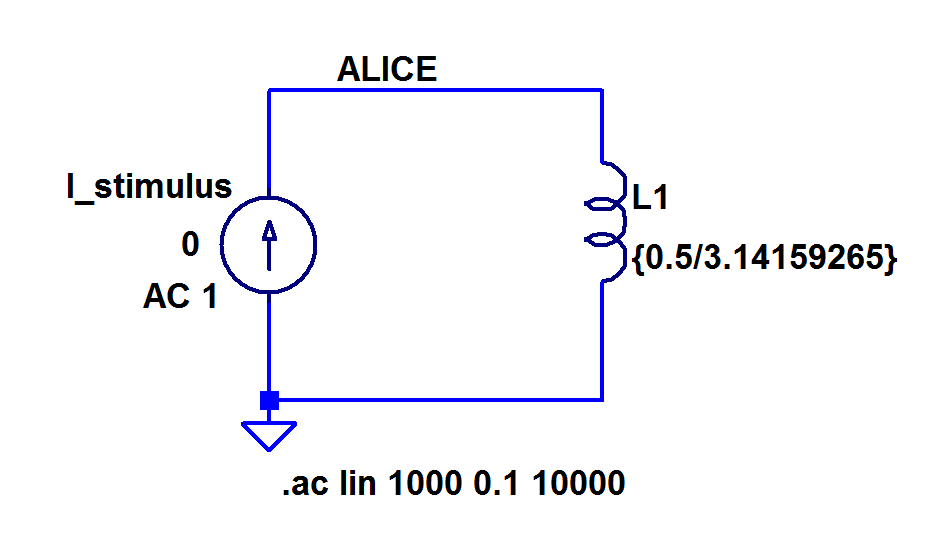

Hans, I am going to assume you intend to use SPICE's ".AC analysis". If so then the little subcircuit below gives you a voltage which is proportional to frequency.
Not only that, the linear function ( y = mx + b ) has the super convenient property that b=0 and m=1. In other words, one volt per Hertz ... with no dc offset (!)
Now you can use this voltage in a behavioral source to get the two terminal transfer function you want, including the AC analysis frequency. See post #2348 in this thread for inspiration.
(and if you intend to use SPICE's ".TRANsient analysis" instead, you'll probably need to build a little tachometer circuit (charge pump) whose output voltage is proportional to frequency). A google image search for tachometer circuit ought to get you started.

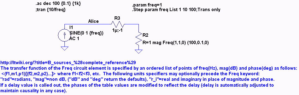

I would like to create a frequency dependant floating resistor, like R= A*(B+C*sqrt(freq))
this can not be done with .Param R=etc.
Any help would be welcome.
Hans
Hi Hans,
Maybe this can do it? B sources (complete reference) - LTwiki-Wiki for LTspice
attachment.php

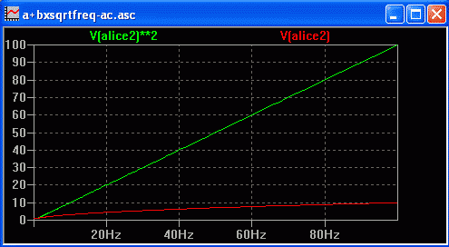

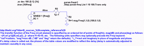

R=1 mag Freq(1,1,0) (100,0.1,0) implements the BR function, here with mag=1 at 1Hz then mag=10 at 100Hz with phase of 0 throughout. It needs a start frequency and end frequency. You choose these to suit the frequency range in your analysis.
attachment.php
This shows the R is 10 at 10Hz and 100 at 100Hz. Phase is zero.
The .trans run for my example doesn't look good; it's unstable long term. Not sure why. Does it need more more than 2 points? Maybe you or someone can get the .Trans mode to work OK. This is the first time I have tried this. All the best.
