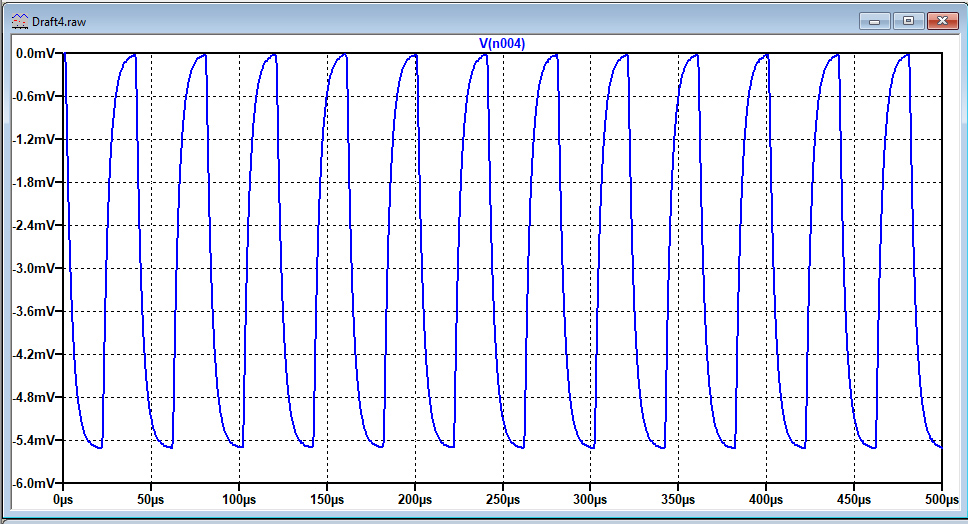

And presenting a 25Khz square wave to your anti riaa network followed by a perfect Riaa amp, results in the waveform of the image below, so please stop telling ferry tales of near perfect square wave reproduction.

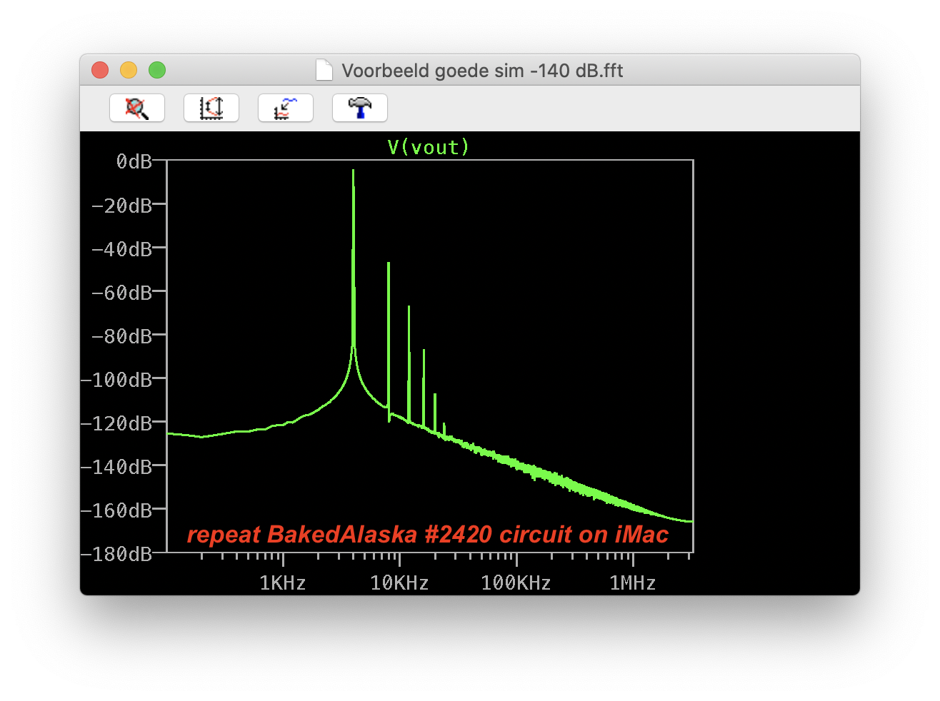

Hi BakedAlaska, your FFT output in #2420 makes me curious: mines look different. So I copied your circuit on my machine. You have a noise floor at funfamental of -140 and I at -120 dB.
My conclusion: my iMac has a higher noise floor (iMac 2017, poor power supply?? 😱 Joking)

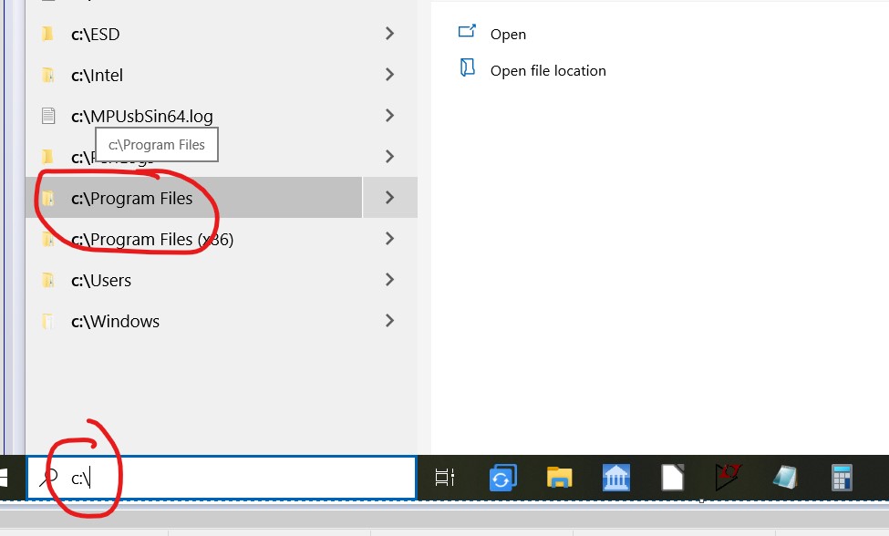

What happens if you look in the program files. Search:
c:\program files
Find the LTC folder and open it. See if the program will open from there.
