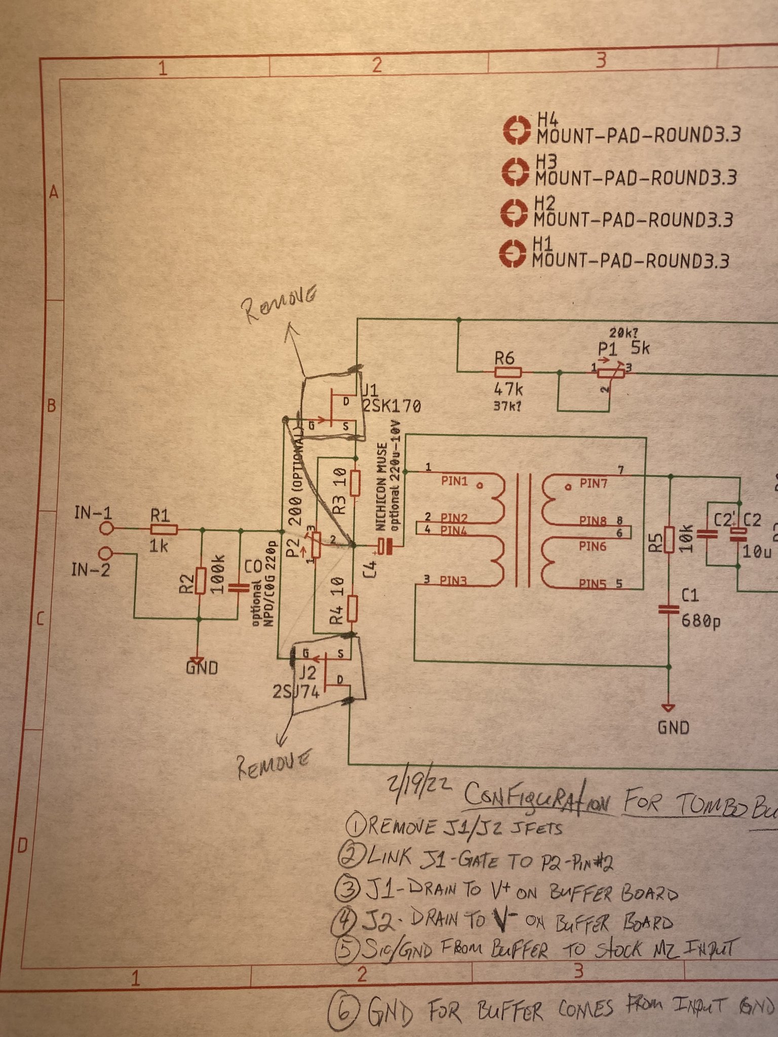

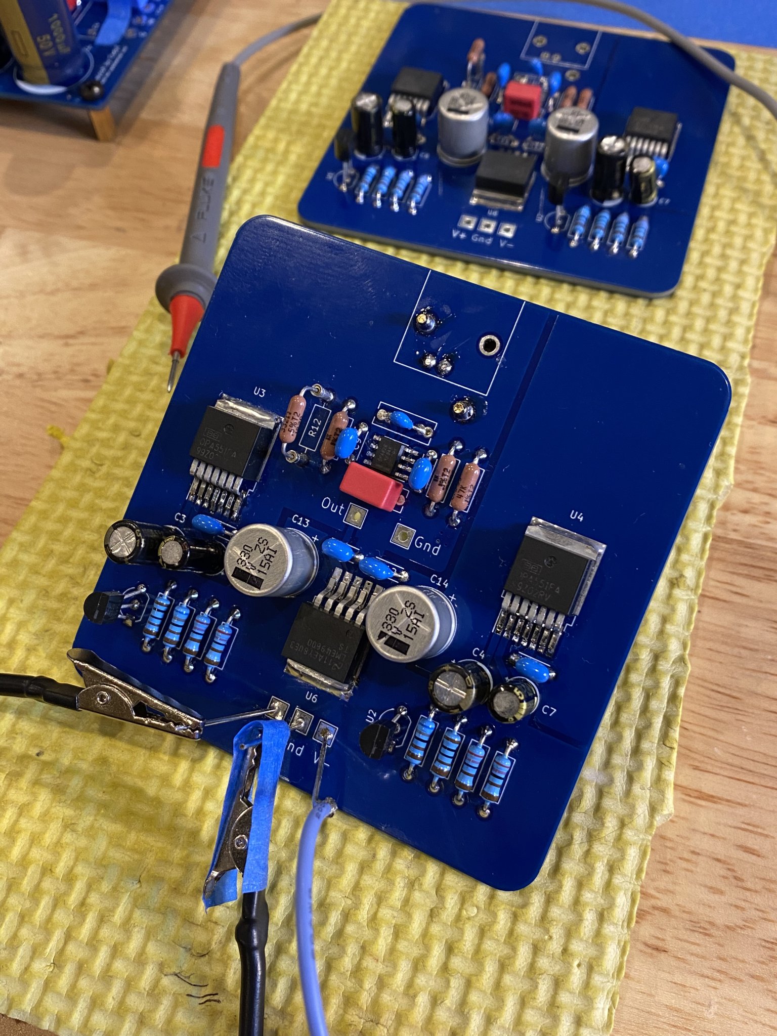

I varied input voltage from +/-20v to +/-45v to the buffer boards with a bench supply and voltage at the OPA828 was steady at -13.79v and +13.80V.

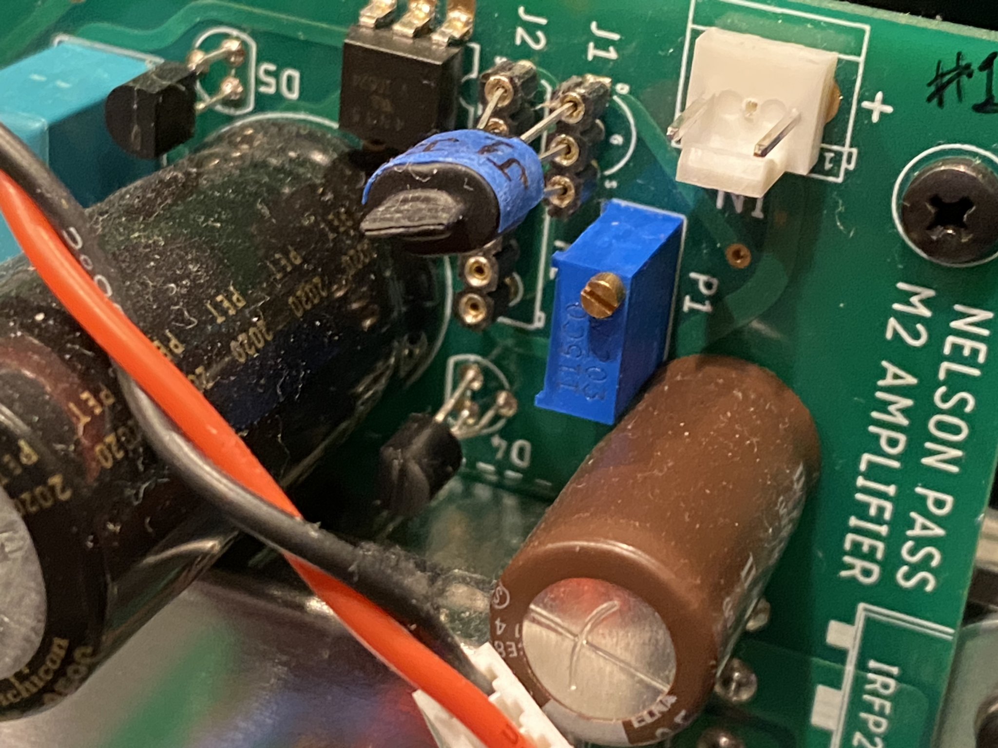

My plan is to try them in my Pass M2 clone. When I built the M2, I installed the JFET’s and P2 trimpot in sockets for future upgrades. Signal output/power input for the buffer will use these positions. With the JFET’s and trimpot removed power can be taken from the vacated Drain sockets to feed buffer. Input signal will use the existing Molex KK header and feed C4 by installing a jumper between J1 Gate and P2 #2 position socket.
Should I remove the M2 input components R1, R2 and C0 since the buffer has similar input components already installed, no need for redundant parts, correct?

Easiest way would be to remove R1 and connect IN-1 with transformer PIN1 or C4 negative pin. As buffer has less than 1 mV DC offset (usually 100 uV), C4 is not required. All other parts can be left in place as removing JFETs and R1 leaves them unconnected or “floating”.With the JFET’s and trimpot removed power can be taken from the vacated Drain sockets to feed buffer. Input signal will use the existing Molex KK header and feed C4 by installing a jumper between J1 Gate and P2 #2 position socket.

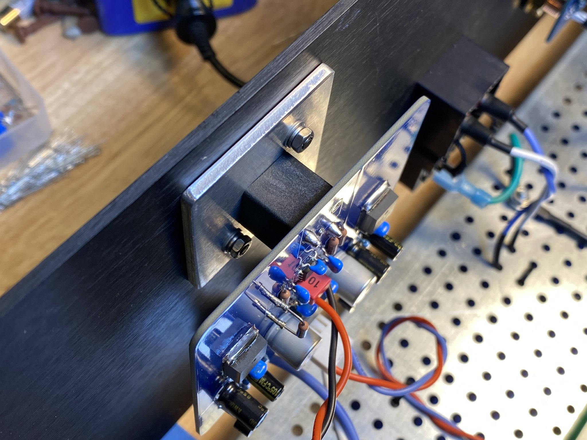

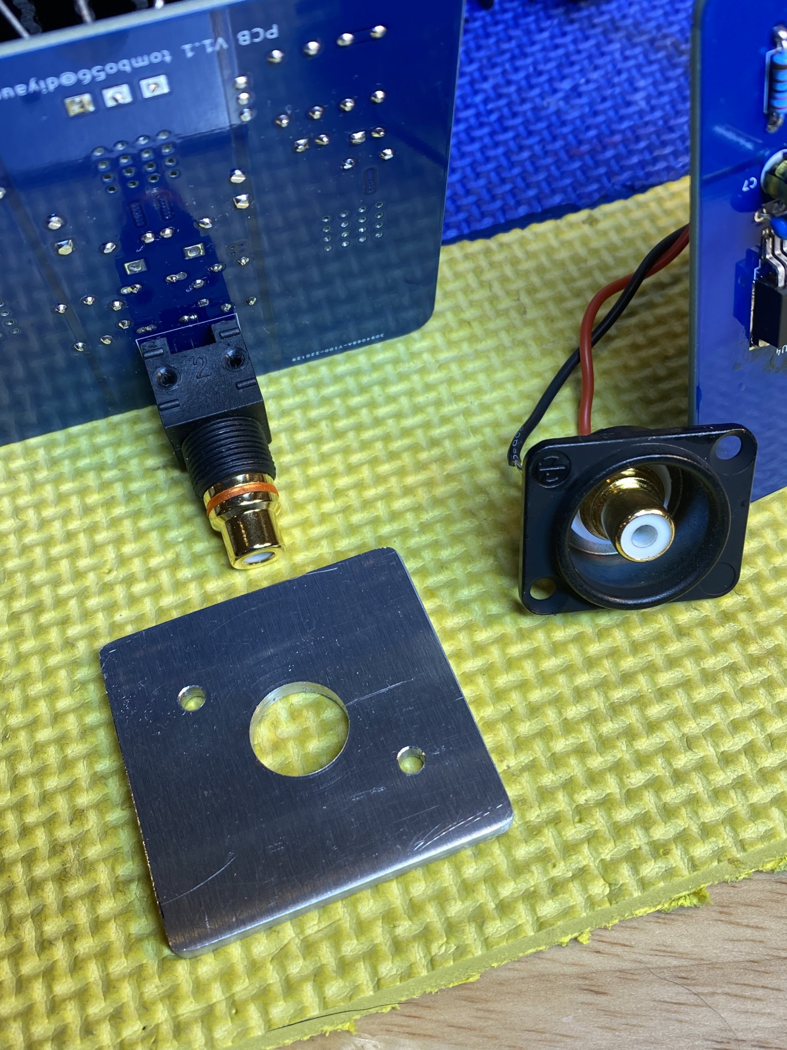

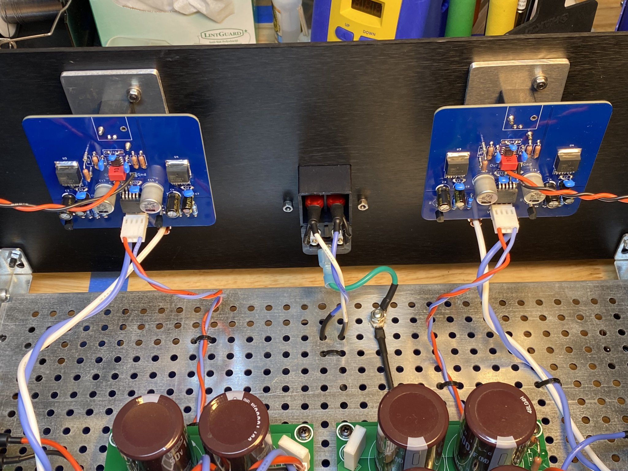

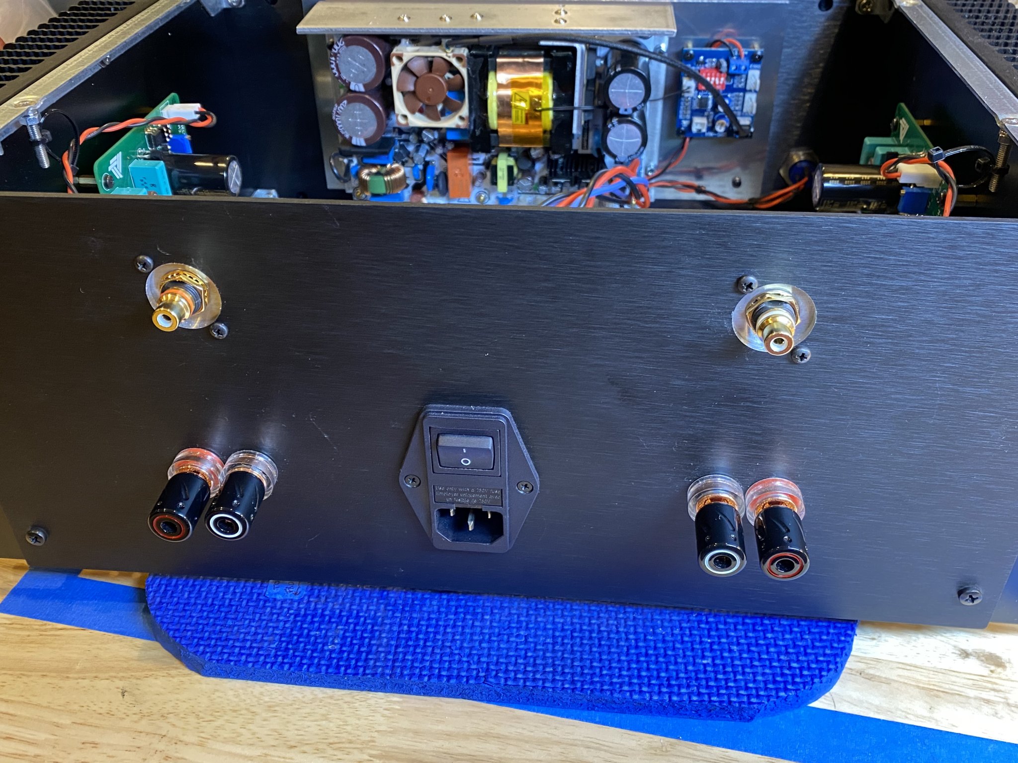

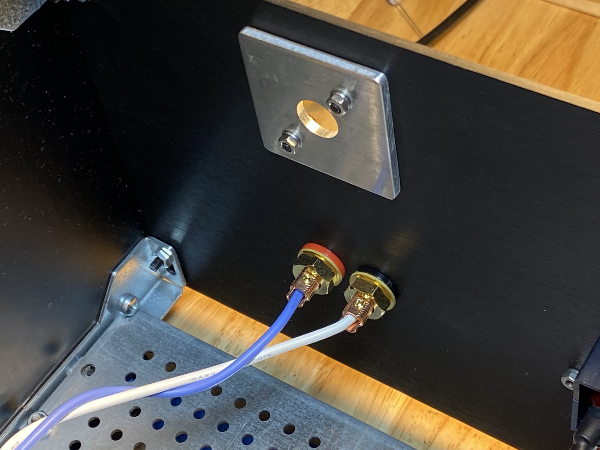

TomboBuffer Pass M2 clone conversion completed. I fabbed up a pair of aluminum adapter plates to mount the buffers in the rear panel holes that were originally cut for the standard Neutrik panel mount connectors.

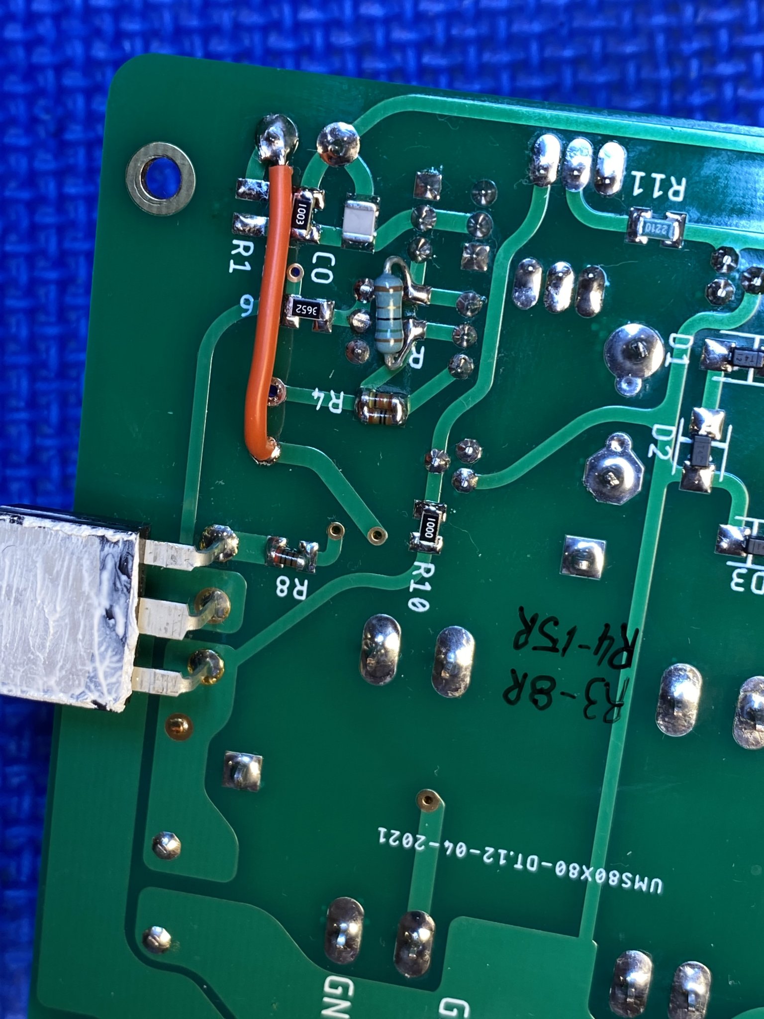

Tombo, your suggestion of bypassing the M2 input components with a link from input to the neg. side of C4 made me rethink my original plan and gave me the final push to remove C4 altogether. I decided to pull the amp boards from the heatsinks, remove C4 and R1, connect a wire between Molex input header pin and C4 neg pad. Took Pos/Neg power directly from the psu cap bank (no ground wire, ground is provided by signal output GND).

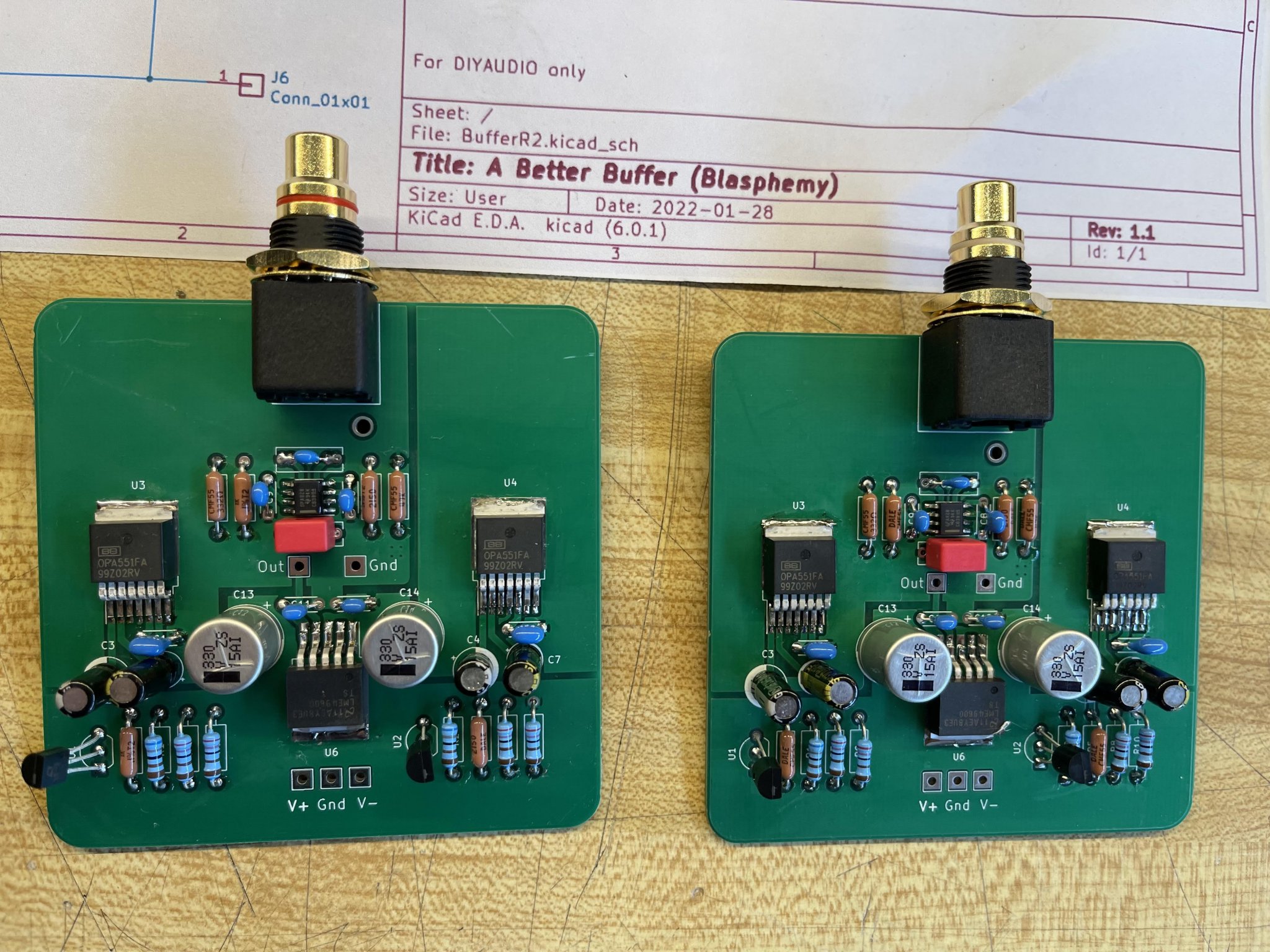

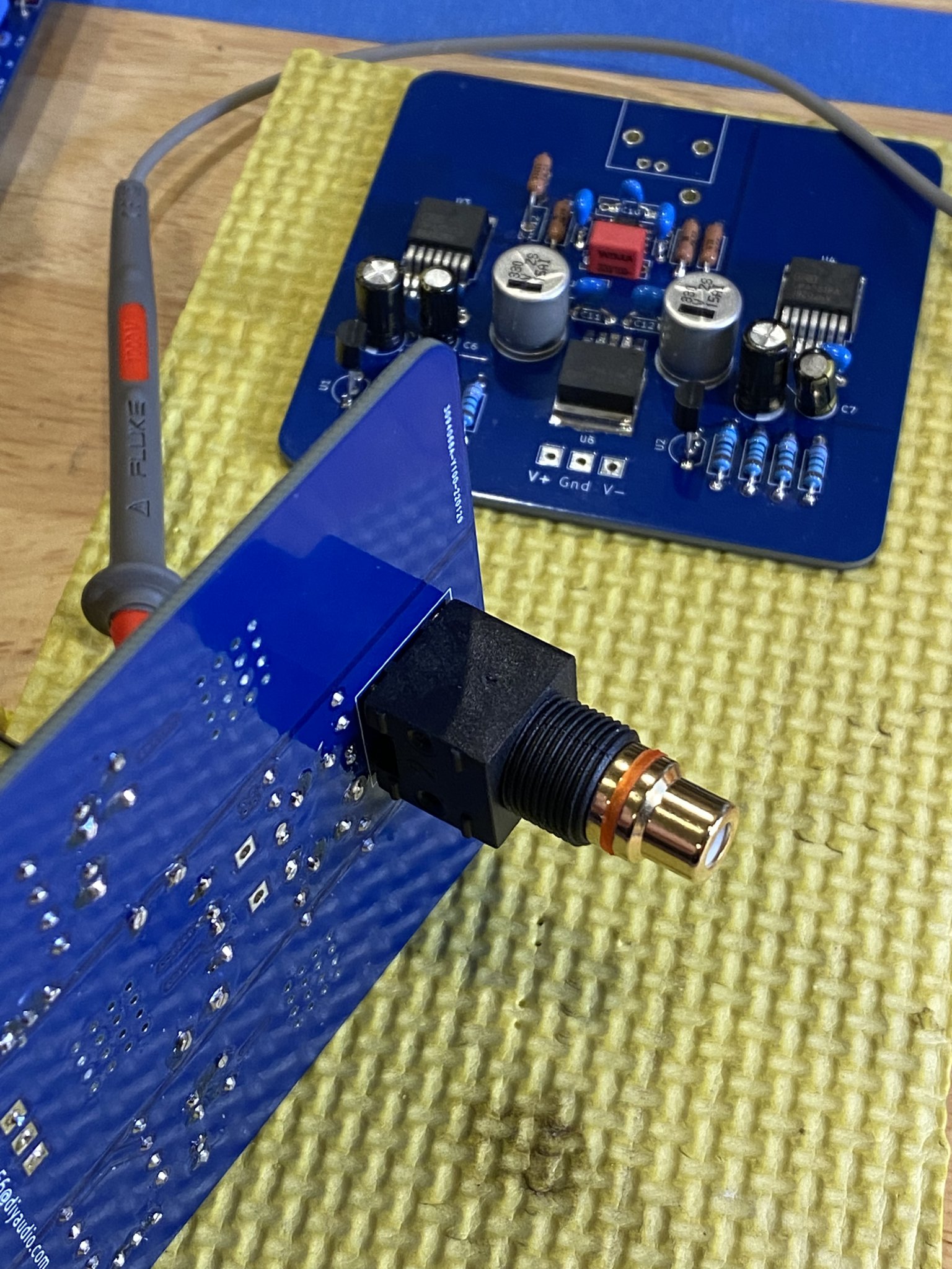

The buffer boards are built as per the schematic with 330R installed at R12. I installed one buffer to compare volume against the channel with JFET’s still installed and could not tell a volume difference between channels with this gain setting.
Drama free power up and dead silent background with music paused. Now it’s a matter if listening time to get a feel if the M2 has changed in any way.

Default buffer gain is just 2.5 dB, Hard to notice in workshop conditions.

Buffer can be supplied from lower voltage supplies, down to +- 12V. For 15 V it is enough to change R1,R2,R7,R8 to 4K7.Wow, way cool!
Question tho- how would you downscale the regulator chips for lower input V (+-15v) and for lower cost?
OPA551, employed as super regulator, is essential for using this with power amplifiers. For preamplifier or headphone amplifier use, on condition that existing power supply is of very good quality, they can be omitted, and supply can be attached directly at C13/C14, honoring that supply voltage should not exceed +- 18 V maximum and +- 4 V minimum.

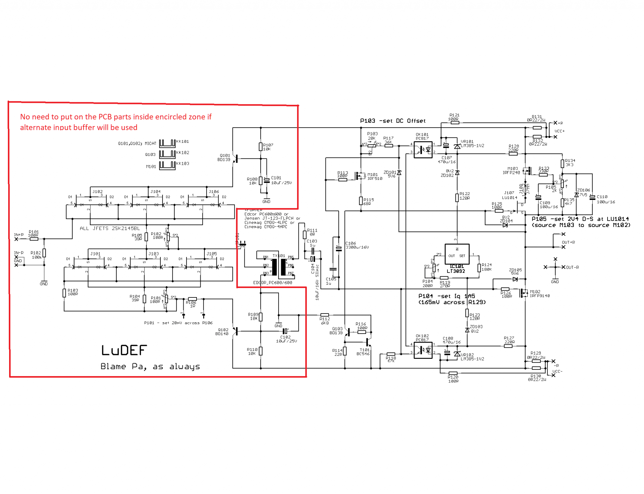

Hello Tombo,
Since I haven't completed my LuDef build, where would I add the input buffer connections to the LuDef schematic?
If I understand correctly, it will replace the 2SK2145 Jfets. I'm guessing it needs to be in front of Q101 and Q102.
Thanks!
Thanks!

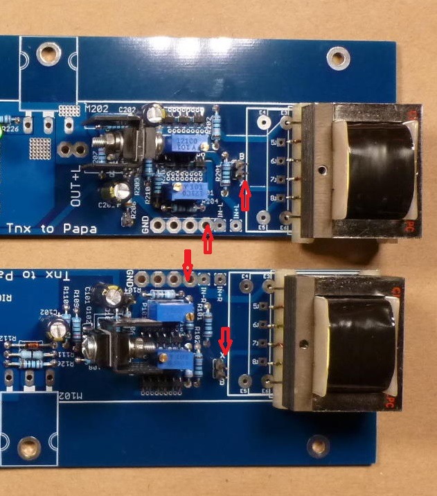

Hi wg45,
Connection goes directly to transformer input. That’s jumper JP101 pin marked with X and ground, as on this picture:

Thanks, Tombo! It really couldn't be easier to make the connection. Input signal goes to the X connection of JP101 and the ground to ground.Hi wg45,
Just to make sure I understand, we are bypassing the LuDef input buffer. All the components "in front" of JP101 can be left open. So, no need to install-
R101-106
J101-106
P101-102
Thanks again!

Yes, but maybe you should assemble PCB as designed to have comparative choice. On the other hand, it will cut assembly time considerably. 🙂Just to make sure I understand, we are bypassing the LuDef input buffer. All the components "in front" of JP101 can be left open.
Everything inside red encircled zone on attached schematic doesn’t need to be installed if other input buffer will be used.
