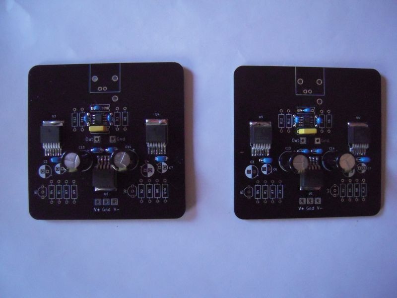

Everything inside red encircled zone on attached schematic doesn’t need to be installed if other input buffer will be used.
I have the components, so I'll install them in the LuDef as designed by Zen Mod.
I get it now- JP101 installed and it's the LuDef as designed. If I remove JP101 and connect your buffer to JP101 X and GND the LuDef buffer is bypassed, even though the components are installed. I like having choices.

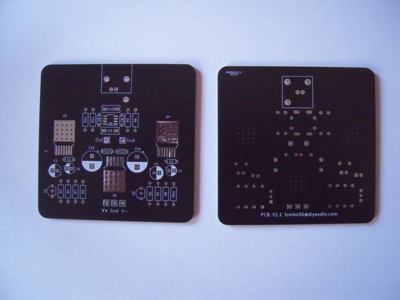

It looks to me that those reasons had more to do with asthetics if not inexperience. C5 node needs to go between the input pin and the input jack. Decoupling caps need to trade places with feedback resistors, keeping ther traces short is the priority. If you have a seperate gnd plane but didnt vias stitch it to the top plane then the whole thing is a disaster only held back by the miraculous loop gain of the ics and possibly the 33pf stabilizer cap. Your layout will end up very different if you start looking at trace capacitance.

You rather assume than read even few sentences of PCB description. Looking back, your first question seems dishonest, as you know the basics on voltage regulators. It was just “entry” or false flag for you continuing with claims on better sound with no ground close to opamp input pins and “sharing ideas”.If you have a seperate gnd plane but didnt vias stitch it to the top plane then the whole thing is a disaster ...

I tend to keep discussion on topic (+some humor is always welcome) and, again, design practices are not on topic.

I’m glad it works well. At least, it confirms that what I hear it’s not simply result of my (inevitable) bias. 😀
Buffer can be easily moved between amplifiers, so no need to build another for SissySIT.

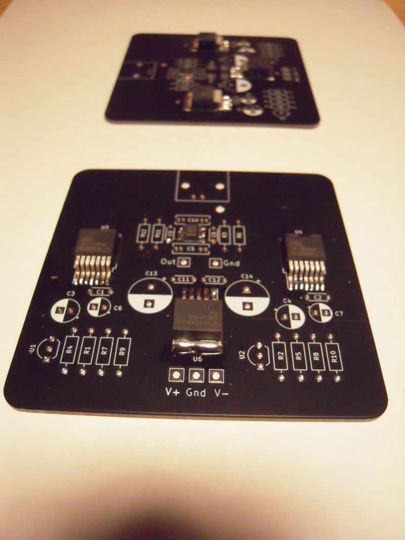

I don’t know how this project got by me. I could. Put this in my SissySIT.
I was thinking this could see this as a preamp as well.
It can be easily used as a preamplifier or headphones amplifier. I have PCB design with corner mounting holes ready if that helps.
