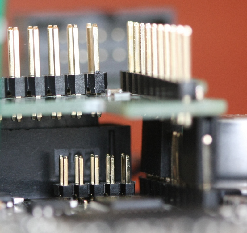

Hi Normundss
I need to confirm the followings before I proceed:
It seems that the jumpers J4 on DAM1021 is preventing me from fitting the i/o board.
Should I remove them?
Second, in post #127 of this thread, the first picture shows that the board is not connect to all the power pins in J2. Does it matter to connect all of them (most of them are GND pins)?
Hmm, not sure what the problem is here. J4 looks like a JTAG header used for programming and testing the FPGA, so there should not be any jumpers on it. I don't have any jumpers on J4, and the height of the J4 header is about half the height of J2/J3, so it does not prevent mounting even when the optional pin headers are inserted on top of the input board. This is how it fits on my unit:Hi Normundss

Thank you normundss.
I managed to find a pair of longer pins head in my part bin.
The problem solved.
The problem solved.
