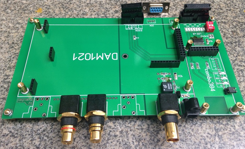

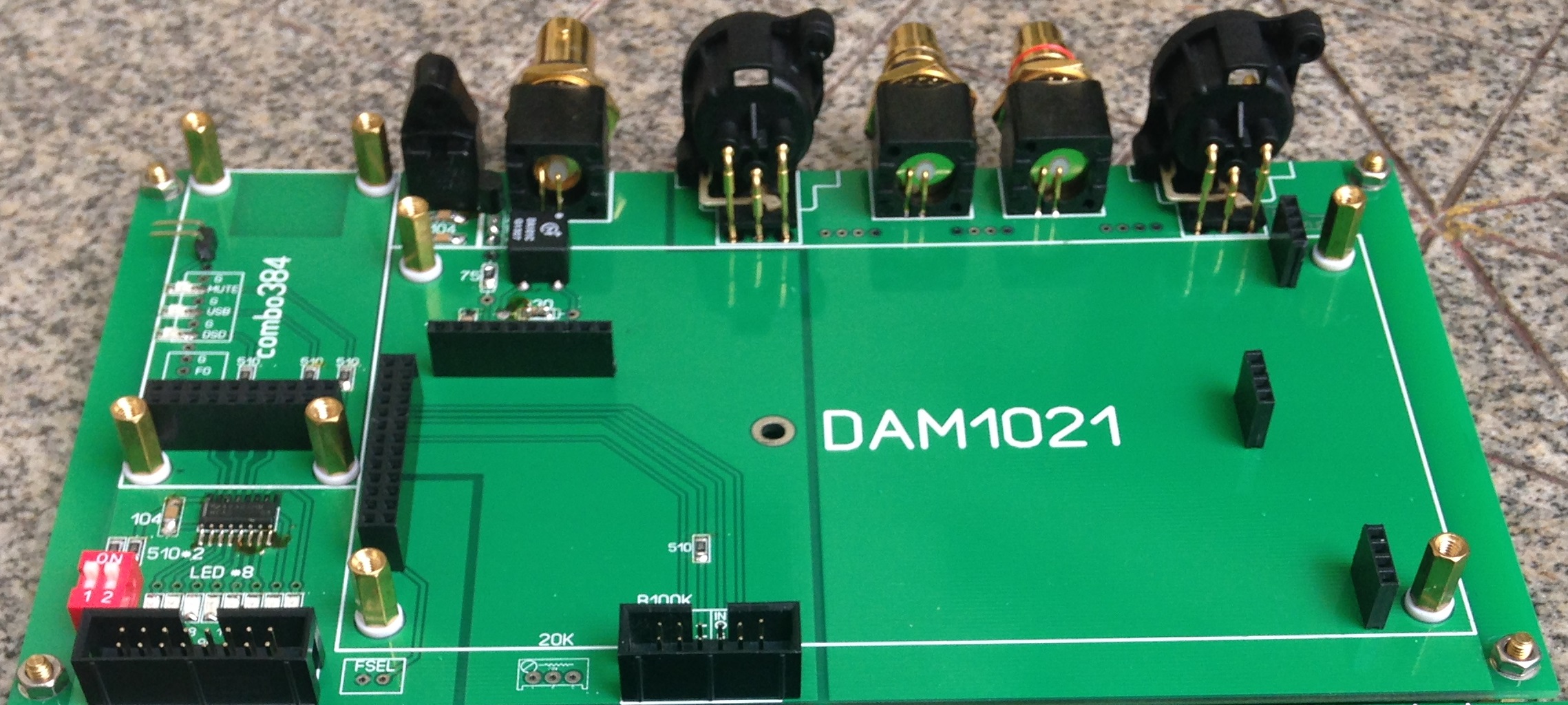

Is this board available?
Regards Christian
USB-I2S up to 384KHz
Wave I/o compatibility

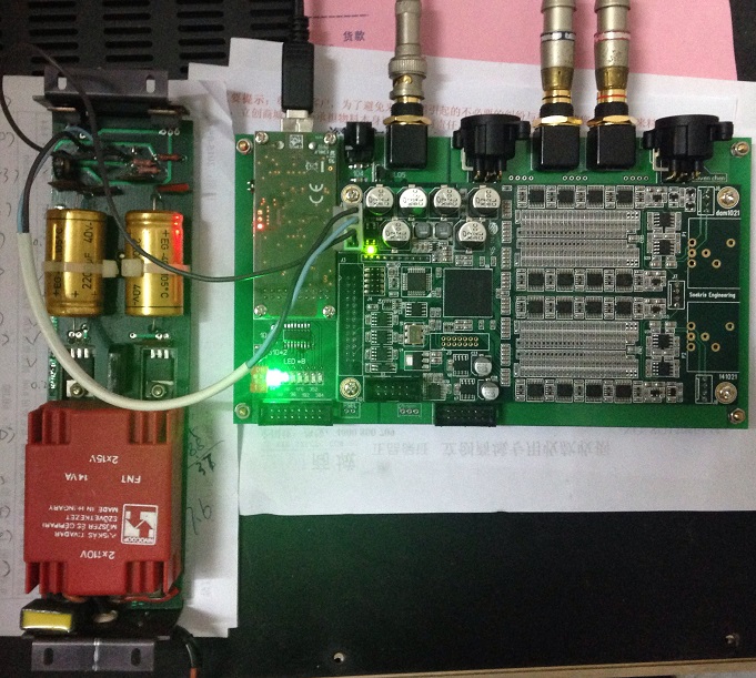

WaveIO is not a drop-in replacement for Amanero, but it could easily be connected to my input board using u.fl connections (the small round connectors labeled I2S DATA, LRCLK and BCLK). You would also need to supply 3.3VDC power for the DAM1021 isolators. I have not checked it the isolators can tolerate 5V supply. If they do, then you could use the 5V supply from Waveio board for that purpose.

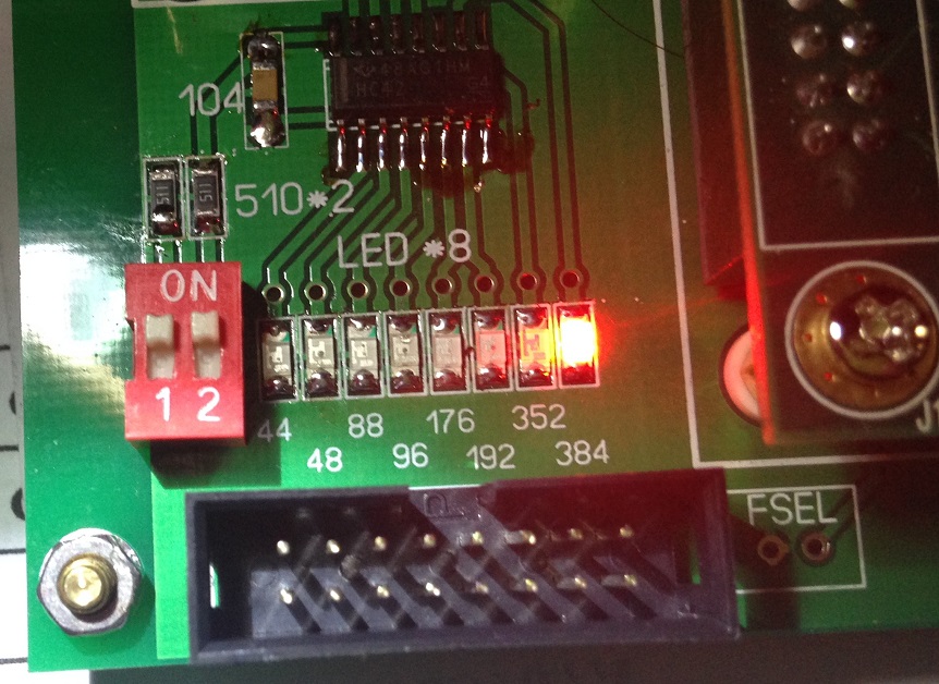

There may be some layout adjustments to make convenient connections for the new DAM functions. I am also thinking of adding an I2S input selector to allow switching between two I2S sources.
I would like to get a feeling for the interest in new features:
1) Selection between two I2S inputs
2) Convenient connectivity for true balanced setup using two DAM1021 DACs. (If the new firmware supports it)
3) Convenient connectivity for chaining several DACs for active crossovers (if the new firmware supports it)
4) other suggestions?
