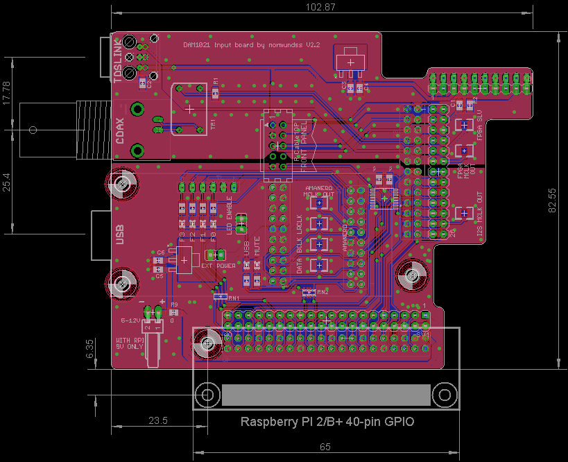

Input board V2 draft design
Here is a draft design for updated input boards. This is a good time to make suggestions and feature requests
The most important differences from V1 boards:
There will be a small PCB for connecting Raspberry PI as outlined at the bottom of the drawing. It will allow directly plugging in RPi without additional cabling. RPi would be oriented upside down, with USB/Ethernet connectors facing left. This way the RPi HDMI and power connectors are also easily accessible and HDMI can be routed to the front or back panel by using a pigtail cable. The Micro-SD card is accessible from the right side.
Everything is designed to fit in a 1U case (40 mm height).
The USB interface status connections use 6 (for Amanero) or 4 (for DIYINHK) GPIO pins on Raspberry. If those GPIO pins are needed for other purposes, they can be disconnected by removing RN1 and RN2 resistors.
The entire 40-pin RPi GPIO connector is replicated on the input board to allow easy connection of other devices, such as a display.
I2S input selection can be controlled by an external switch or by RPi GPIO17 pin. At this time GPIO17 is permanently connected and can not be released for other use.
I2S-1 input can be either Amanero, DIYINHK USB or the U.FL sockets.
I2S-2 input is Raspberry PI.
There are serial connections between RPi and DAM isolated serial interface.
An updated switch board will also be designed to support mechanical selection of 5 input choices.
- Two selectable I2S inputs.
- Raspberry Pi connector
- Flexible external power options for the isolated part/USB/RPi
- Support for DIYINHK USB interface (the non-isolated version)
- Amanero/DIYINHK USB status lines readable from Raspberry GPIO pins.
- Serial port control from Raspberry Pi.
- Fashionable rounded corners

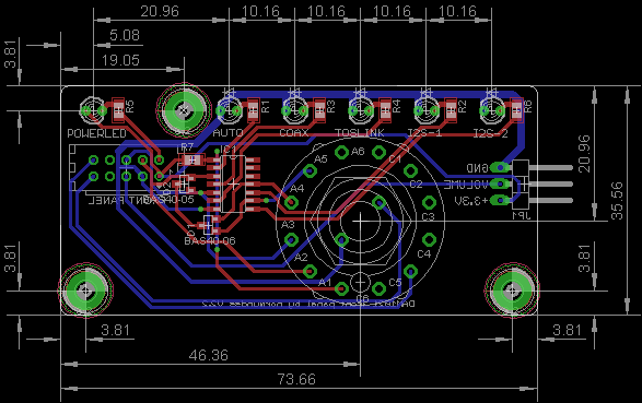

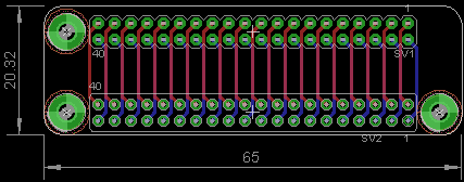

Here are the preliminary designs for the accompanying boards.
Raspberry Pi connector:
Switch board to support 5 input selections:
All measures are in mm.
A 2-pole, 6-position switch is used to support five selections. Since it requires switching on both isolated and non-isolated sides, two wires of the ribbon cable are left unconnected to separate the two sides by a larger physical distance for reduced noise coupling, while still using the same 10-wire ribbon cable. Such arrangement requires the use of additional logic elements for driving the LED indicators.
All functions can be controlled from Raspberry Pi, so the switch board will be provided as an option. When using the mechanical switch, only I2S-1 input (USB/U.FL) will be used in DAM Auto input selection. In theory, auto selection feature for all inputs could be implemented in Raspberry Pi software.
