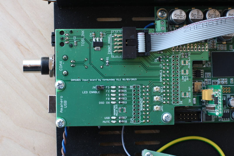

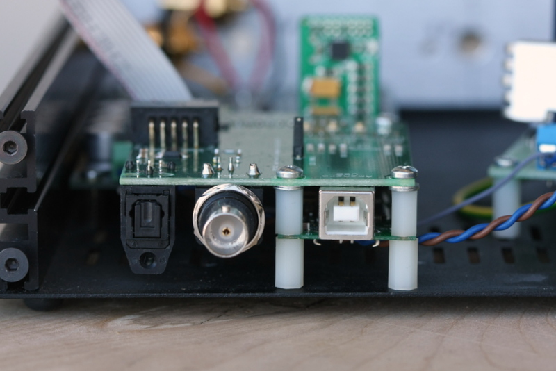

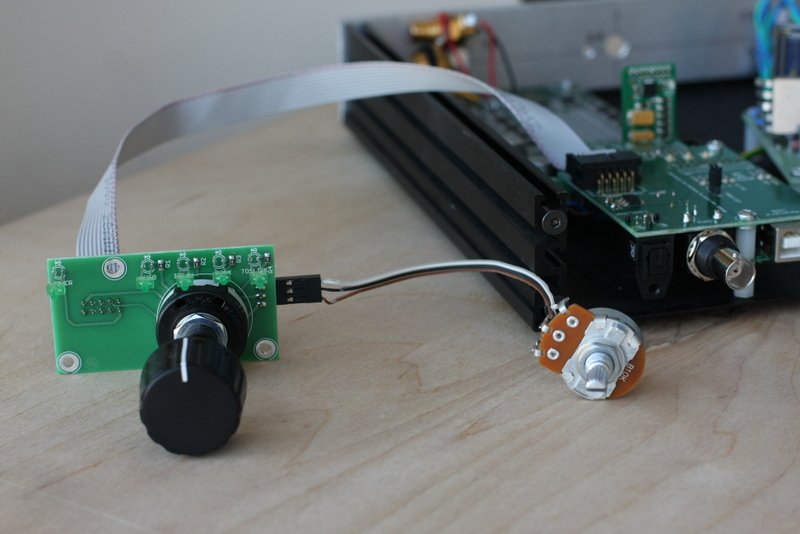

Here are some pictures of a fully built production board mounted on DAM1021.

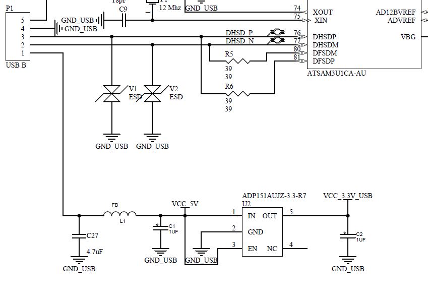

Hi. I have a question regarding the Amanero supply using the GB Input PCB. I just want to confirm that in addition to the Dac 7V,10VA transformer, we need an other supply for the Amanero.
I also want to confirm that the Amanero needs an external 3.3Vdc supply, anyone knows the supply current needed? I was thinking to use Salas Reflecktor-D shunt supply for that.
Thanks in advance, any information appreciated.
The amanero does have it's own supply through USB power, so you won't need any additional 3.3v supply. BUT you can remove one LDO from the amanero pcb and power it with external 3.3v supply if you want.
Yes, you are right. Myself i will use the USB power, since there is reclocking, the psu on the usb-i2s converer isn't that important, i think it's a bit overkill using high end psu before the isolator/fifo. But of course you are free to try and maybe compare!
As Rollee2k already said, there is no need to provide any external power to the input board. Amanero and the dirty side of tHe isolators use power from USB bus, and the other components are powered by the unregulated PWR+ line of DAM1021.
I believe the quality of power for the isolated side will not be very important, and intend to use USB bus power.
However, if you want to try, external power for amanero and isolators can be suplied throgh the duplicated pins of the amanero connector after appropriate modification of the Amanero.
