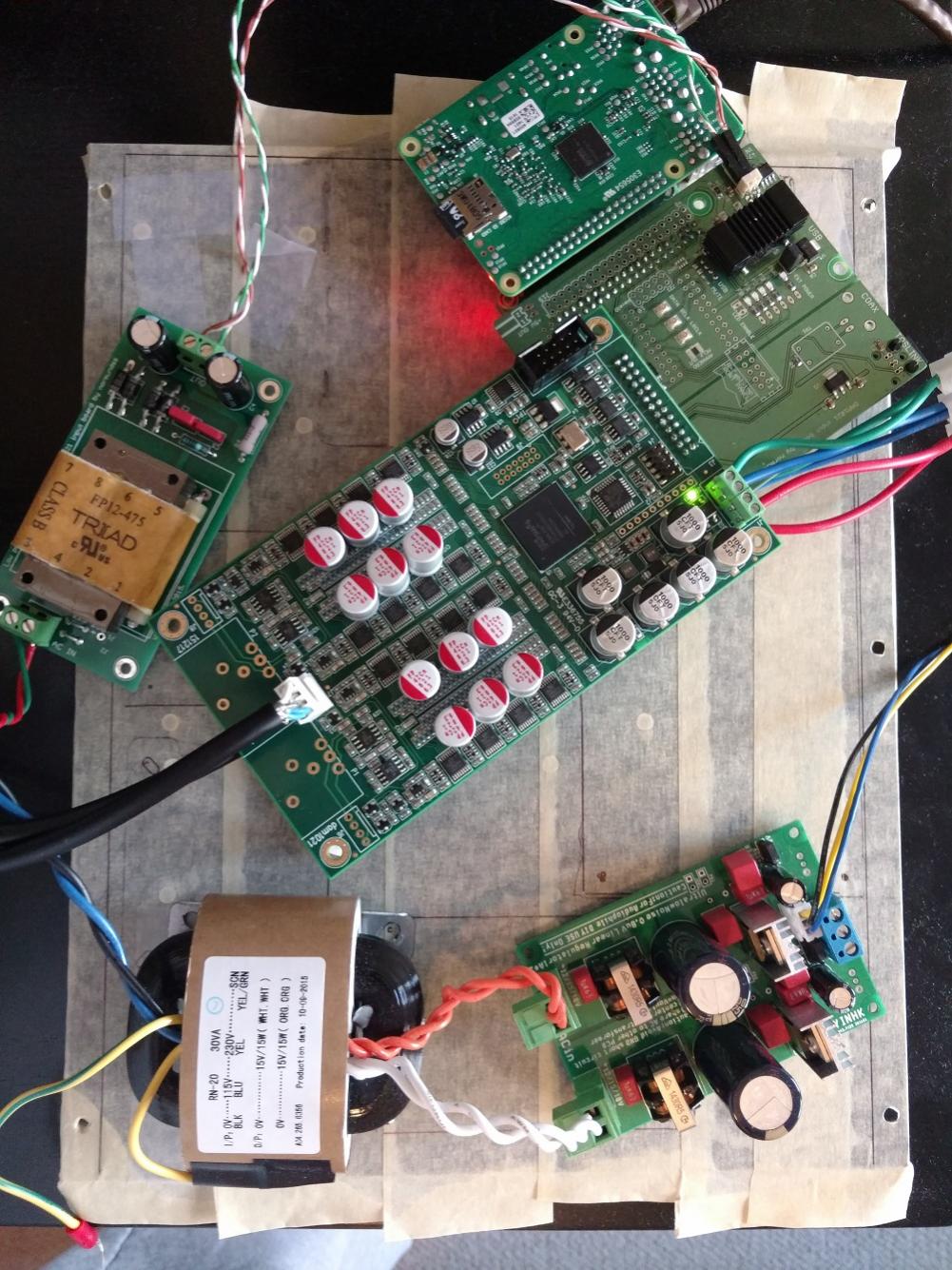

Ugh, last several posts have all been by me.
Anyway, I assume many folks out there like to look at pics, so here's a shot of my project in-progress.
This is a dual-mono setup, with Raspberry Pi and optical TOSLINK inputs.
The main setup/config is done, now I plan to focus on some fine-tuning...
- Change that transformer out for one with dual 12V + dual 9V secondaries. I'll change the jumper on the DIYINHK regulator to feed the dam1021s +/- 9 VDC instead of 12 VDC. I'll use the xformer 9V secondaries to supply another regulator which will replace the Normunds PSU (so I have only one transformer in the whole system instead of two like I have now).
- Waiting to receive a rotary encoder. Will wire that to the RPi so I can have a physical knob to turn for volume.
- Case work. All the components in the picture are sitting on the bottom of the case, which is masked off for the drilling.
- Put VREF caps on bottom board. I have revision 3 boards which really don't need those caps. But I had 18 of them on hand, so only need another six to do the bottom board. It's an easy mod and makes the dam1021 boards look cool if nothing else.
