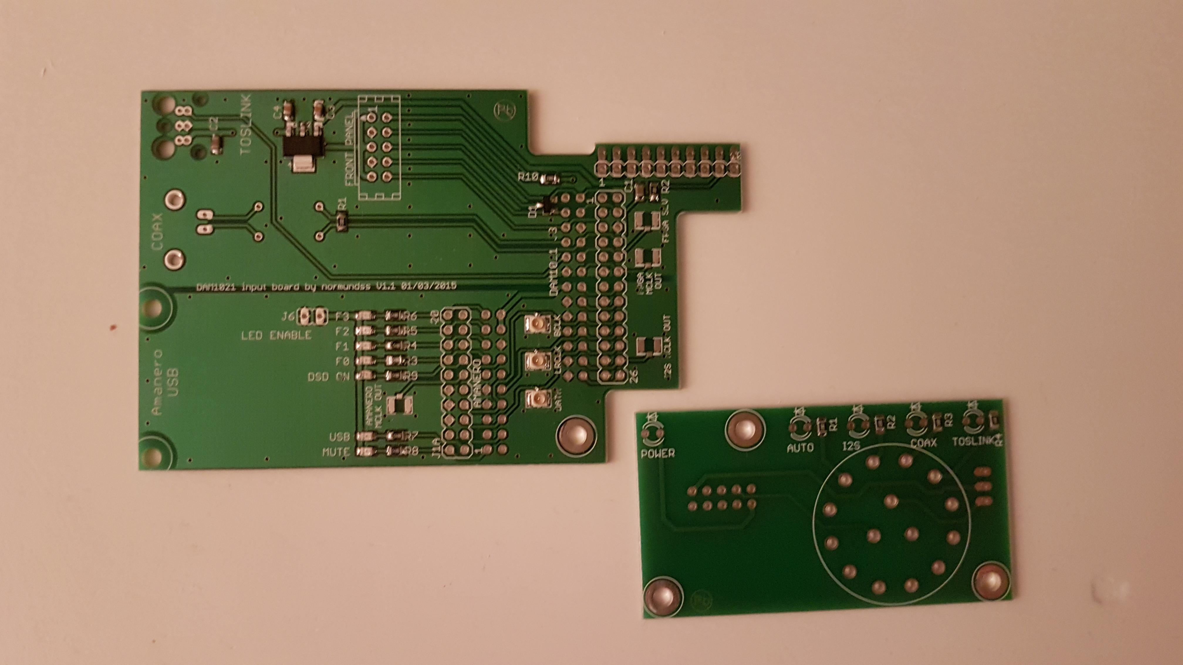

Does the input board work for the OEM Soekris DAC?
Do
Not really, at least they can not be directly plugged together.
I have one spare Input board, bare PCB only, (plus Raspberry connection PCB) and one Switch board, bare PCB only, as well as the surface mount connector for balanced build, which I would be willing to sell for 25€ plus shipping (from Germany).

Have one spare including the smd components soldered on. One input and one switch board. Rev 1.1. Never used.
Same price as the rest? 25€ + shipping is that fair?
Picture soon.
