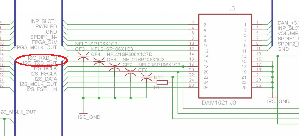

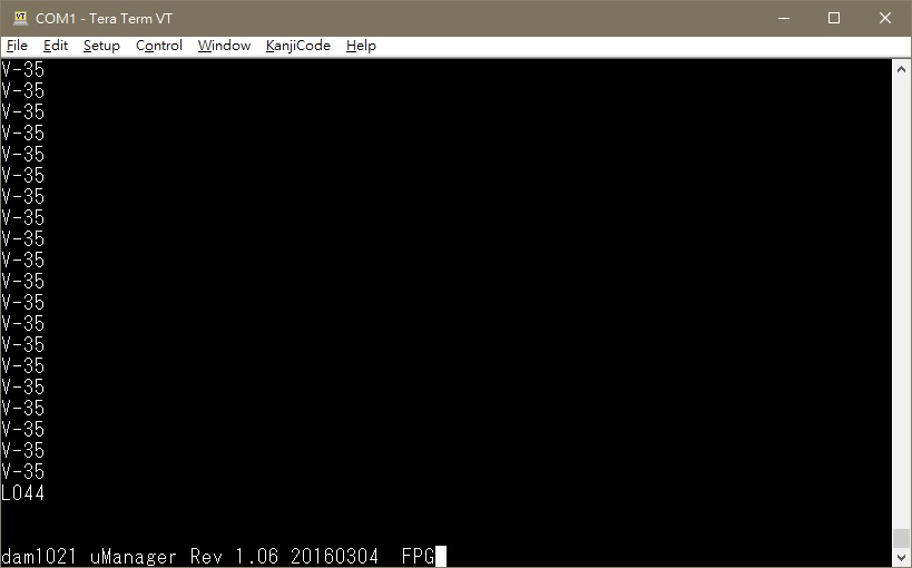

Hi Normundss,
Seems some unwanted signals are populated from RPi to DAM serial. This not only causes the aforementioned volume pot noise issue, but also causes the DAM to hang (refer to attached screen capture of DAM RS232) occasionally. Your comment on this is appreciated.
Thanks!

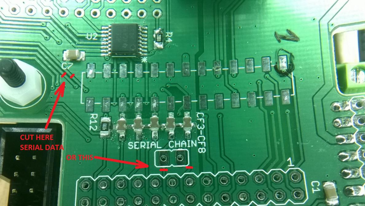

Ahh, perhaps you have Linux console or something else configured to run on the RPi serial port.
You can either:
1) disable whatever is using the RPi serial port
2) disconnect RPi serial ports from DAM by removing the RN3 resistor array. In this case you will no longer be able to access the DAM serial port from RPi.

Many thanks Normundss!
Just removed RN3 and now everything works like a charm.

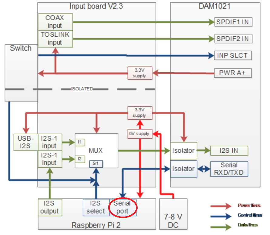

I need your help guys.
I am powering input board via power supply. It is around 8,5V DC non regulated. I also got Rpi B+ and Amanero. I am powering DAm1021 with Salas BIB +-12V.
As You can see in above picture.
I also have Reflektor D with 3,3V. I have it connected like this.
All the voltages are okey. EXP PWR is disconnected. I did measure them. The point is everything looks ok. Yet, I couldnt get it working.

Okey.
I know how to get it works.
I have connected amanero and RPi. No more signals.
While I power up whole preamp, and Swtich board is on I2S-1 there is no sound, yet Dam1021 does lock. I can change sources, nothing helps.
To get it working, I have to switch to I2S-2 (RPi) without power. Turn it on. Then after it get up, I have to simply change to I2S-1 (Amanero). Sound is there 🙂. RPi and Amanero working.
I tested it few times. Each time same thing happens.
Why something like this happen ? Does I really have to change to I2S-2 before turning power ON ?

That should not be happening.
On all switch settings except I2S-2, the I2S-1 input (Amanero) is connected to DAM I2S input. When you switch to I2S-2, the input board disconnects Amanero and connects the RPi to DAM I2S inputs. So it seems your Amanero might be causing the DAM to misbehave .
Please try it with the Amanero disconnected, see if that makes a difference.
It would be good if you can provide the power-on output from DAM serial console to see which input it actually locks when there is no sound.

The same happens to me. During power if I selected I2S-2 Raspberry Pi, I can subsequently select any input without problems.
Otherwise It can block DAM1021. I think it's because Serial Data coming through the Raspberry PI serial port in the power ON.
attachment.php
I do not know program the Raspberry to disable the serial port. Or make this serial port to work properly with DAM1021.

Ahh, yes that could happen if your RPI distrubution runs console on the serial port. DAM can interpret console output as commands and mess things up.
If you do not want to use the RPI serial port for controlling the DAM, you can remove the RN3 resistor array. That will be the same as cutting the tracks, except you can solder it back later 🙂
If you do want to use the RPI serial port for DAM control, you need to disable console output to the serial port.
Here are the steps I used for Raspbian:
sudo vi /boot/cmdline.txt
Remove console=ttyAMA0,115200
sudo vi /etc/inittab
Comment out getty on serial line:
#Spawn a getty on Raspberry Pi serial line
#T0:23:respawn:/sbin/getty -L ttyAMA0 115200 vt100
Reboot.
Then you can use a terminal program on the RPI, such as minicom, to connect to DAM serial port and issue manual commands. Or use the python library by DIYA member forta.
