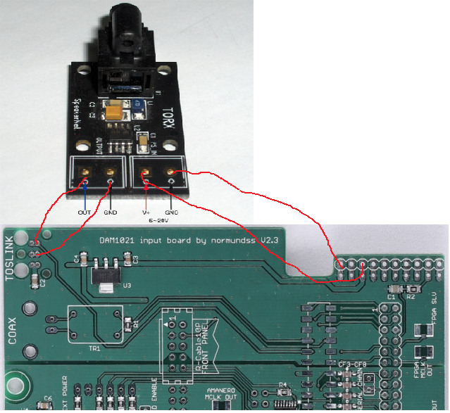

U3 and U4 on the input board are both 3.3v ldo.
is U3 always working with or without the External power jumper set? it looks like it's tapping off Power A+? you'd suggested to power my toslink module from J2. and does U3 power the DA101C? or spdif transfomer "pulse or whatever" Basically, will SPDIF RCA/BNC work or be powered from the U3 LDO. Or is it from 1.2V on Power +?1.2V. I'm trying to figure what amount of 3.3V i'll need to supply the board. Hoping the toslink module and spdif rca/bnc can be powered from dam1021, and potentially a hdmi i2s ouput module (20mA) as well. would that be OK to power from same source as toslink module? pwr A+.
I'll be adding external 5V and 3.3V. I'm 90% sure U3 is always going to work...so toslink can be powered, along with SPDIF and hopefully hdmi i2s module?

And my TOSLINK module asks for 6-20V input (MAX 40mA) albeit I swapped the component to a genuine Torx 142L (25mbps), kinda odd imho but appears to have it's own low noise regulator. but normunds mentioned in previous post to use PWR A+ and GND from J2. so my external regulated PSU (10V) that powers the dam, will also power Toslink.
The I2S module should be powered from an isolated supply. You can tap 3.3V from input board U4.
Do not power it from DAM +3.3V or from U3 on the input board. They are not isolated from the DAM.
TOSLINK is connected to the non-isolated side of DAM. Since your module has its own regulator, you can power it directly from DAM PWR A+. U3 regulator on the input board does the same thing - it supplies separate +3.3V rail for TOSLINK receiver.
