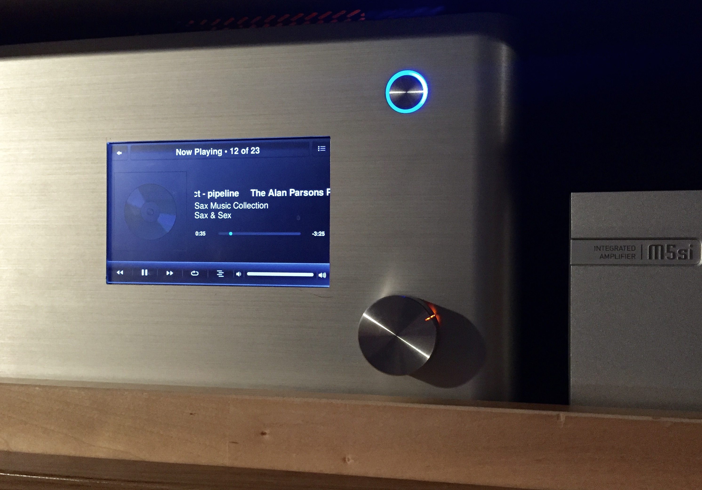

It's really embarassing - I do apologise for such a rookie mistake... That was missing connector to the dac... I rather listen to good music than solder electronics - but hey, at the end of the day its full success and I'm completely amazed how good this stuff is - dac sounds awesome and this switch/input board is great.
There're still some final touches remaining but right now - thank you Normundus - good job :cheers:

Very cool! I would love to see more photos and learn of the specs of your build. 😀

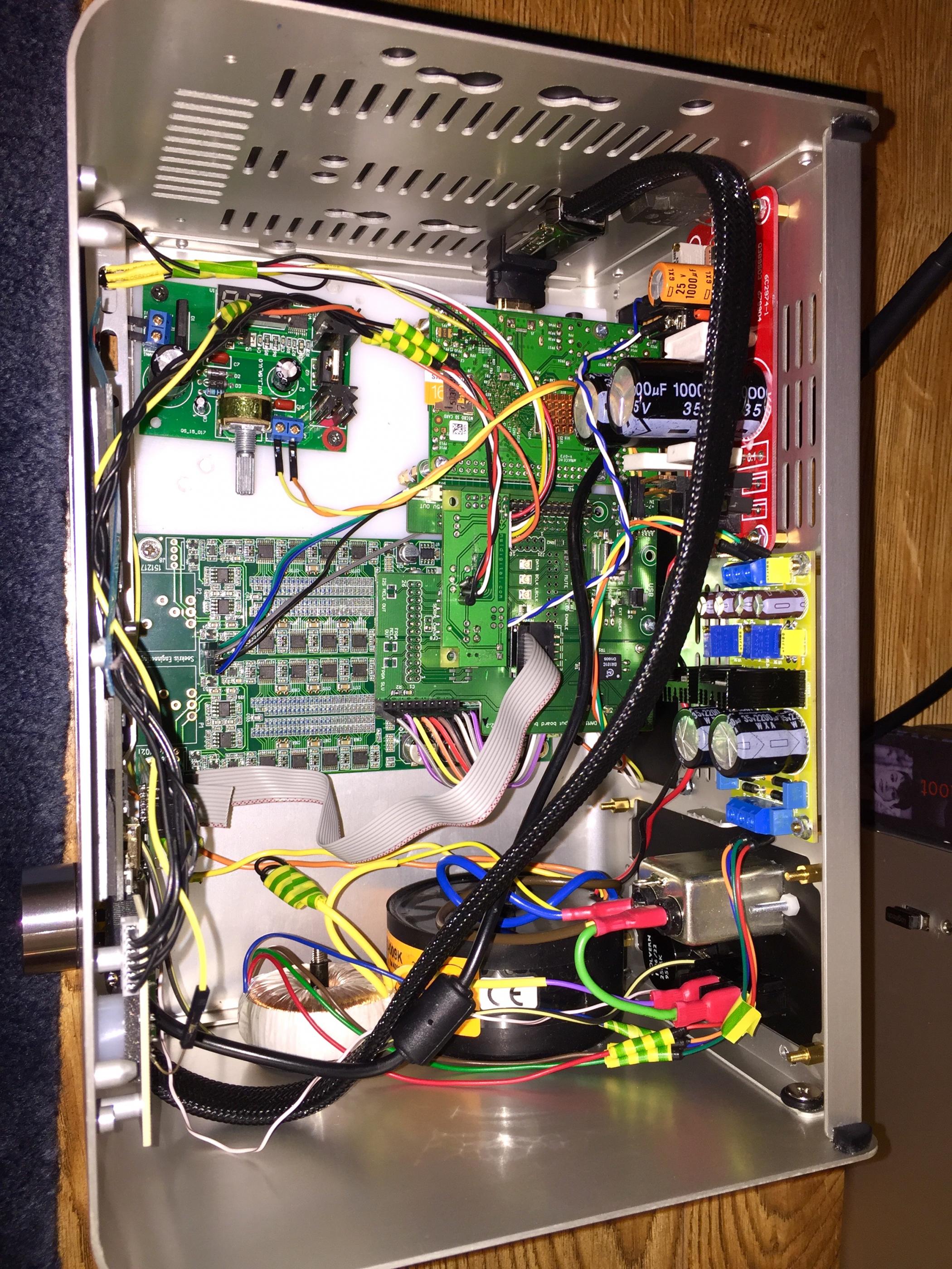

So this is how it looks inside. This is my first ever diy audio project so please forgive me this mess inside... I used 2 transformers 2x9v 30VA and 2x15V 7VA.
Voltage regulators - 2 on lm317 (318) and one for Rapi lm1083 if I remember correctly. I had to do some jiggery pokkery as the case is to shallow for dac and input board - so I used short 5cm ribbon for connectong dac with input board and 10cm single pin cables for J2 connector (as you can see on the picture)
Screen 5" hdmi with usb touch functionality from waveshare and on/off module with IR for Rapi from MSLDigital.
No other mods to the DAC. Haven't yet uploaded any digital filters so it's on the default one.
