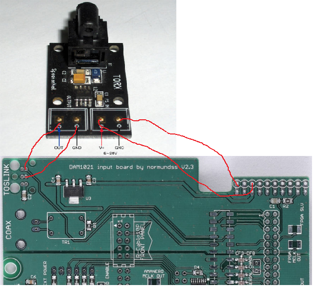

I would like to use this toslink with the normunds input board but what is the best way since the board uses a pcb mount.
I have this toslink and it's pretty good.
This should work:
