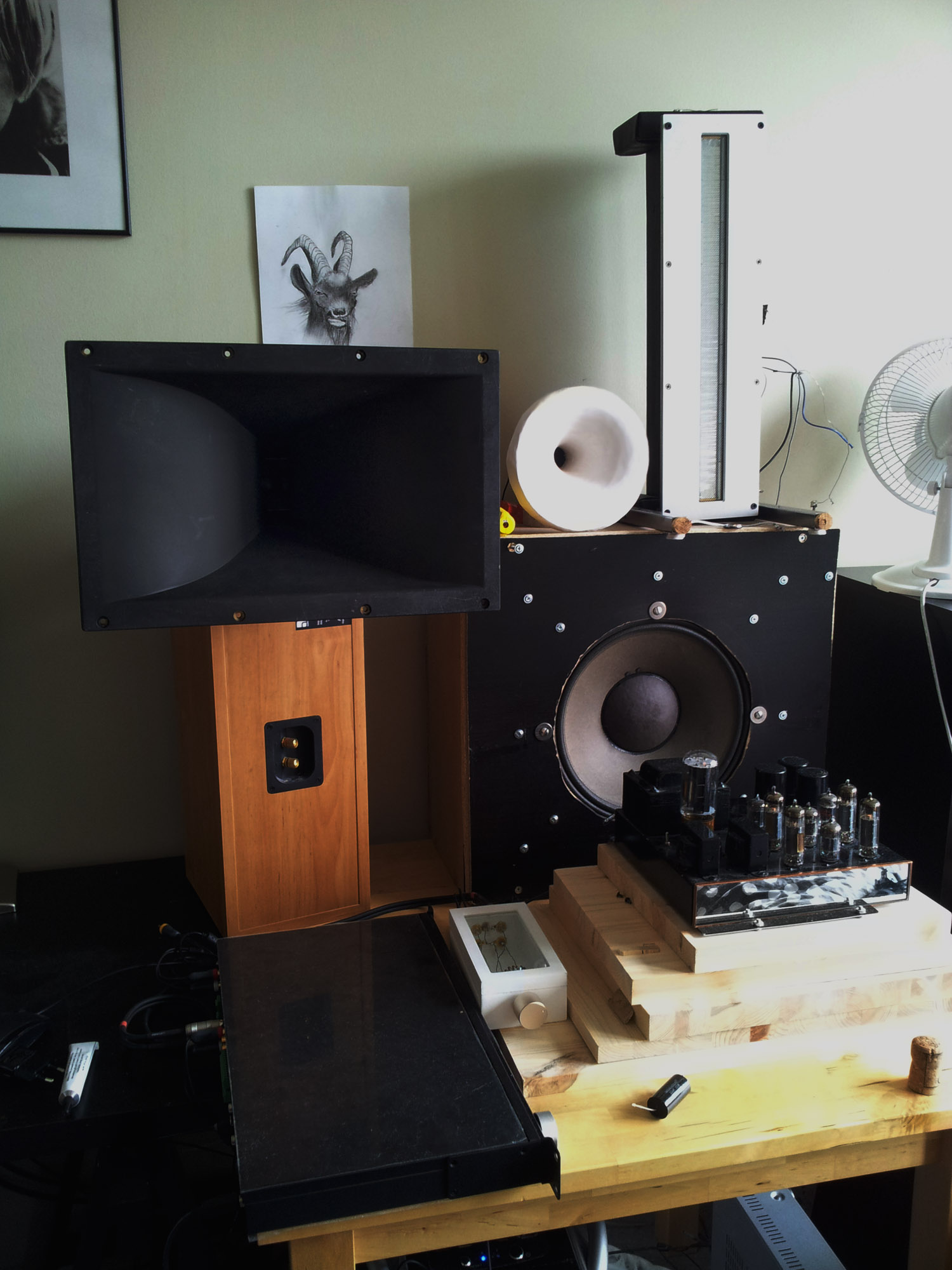

I was working all night, and now I am done with both sides of a wooden 1.5m long, 75cm diameter Goto horn. I will glue them together soon, fix a mounting plate and then enjoy some sweet horn sounds with the JA6681B... tomorrow.
I did some more trials with channel upper midrange in a Avantgarde Trio tweeter horn. It adds a little more ohmph! than the 6 times more expensive Beyma TPL-150. The 1" in a small horn blends in much better with the 2" Radian 750-8. The Beyma TPL-150 made me think an upper midrange channel was not needed, because I could not really hear much difference, at least not when using the Radian 2" compression driver in a 40x40 cm horn from 450Hz up to 7kHz. Guess I will save the TPL-150 for another project, like the bass AMT project. I was sure classics like the Avantgarde Trio was out of date, and could use new ideas. And it does, but not sure the AMT was the best. It might work later, in a bigger room, bigger back chamber, in a bigger horn, I don't know yet. I need to live with it a few years more.

I can finally compare the 2" Radian 750-8 (760PB?) with the JA6681B in this smaller horn. No Goto horn yet. Even with a 2" horn the JA6681B is noticeably more musical. A more dry sound in a way. Tougher. If Radian is Dwayne "The Rock" Johnson, then the JA6681B is Marlon Brando.
Very impressive. The Avantgarde Trio tweeter with a Beyma 1" adds something nice at 3800Hz to 7000Hz, that is lacking without. The Radian could do this better, but an extra 1" compression driver in a small horn was still better. I bet that another JA6681B would sound even better. I can hear what JLH meant with "acting like a direct radiator." above 4300Hz. This is about how the Avantgarde Trio is crossed.
I don't hear much difference on 500Hz and 250Hz high pass. This would require a bigger horn, I guess. Or my 100uF protection cap is in the way.
I added also a picture of a Goto S-150, or very similar, which I am building. This is not a very popular horn in these forums, and some opinions are quite negative, but I doubt many have tried them. If not for the JA6681B, then for the modded Atlas.
