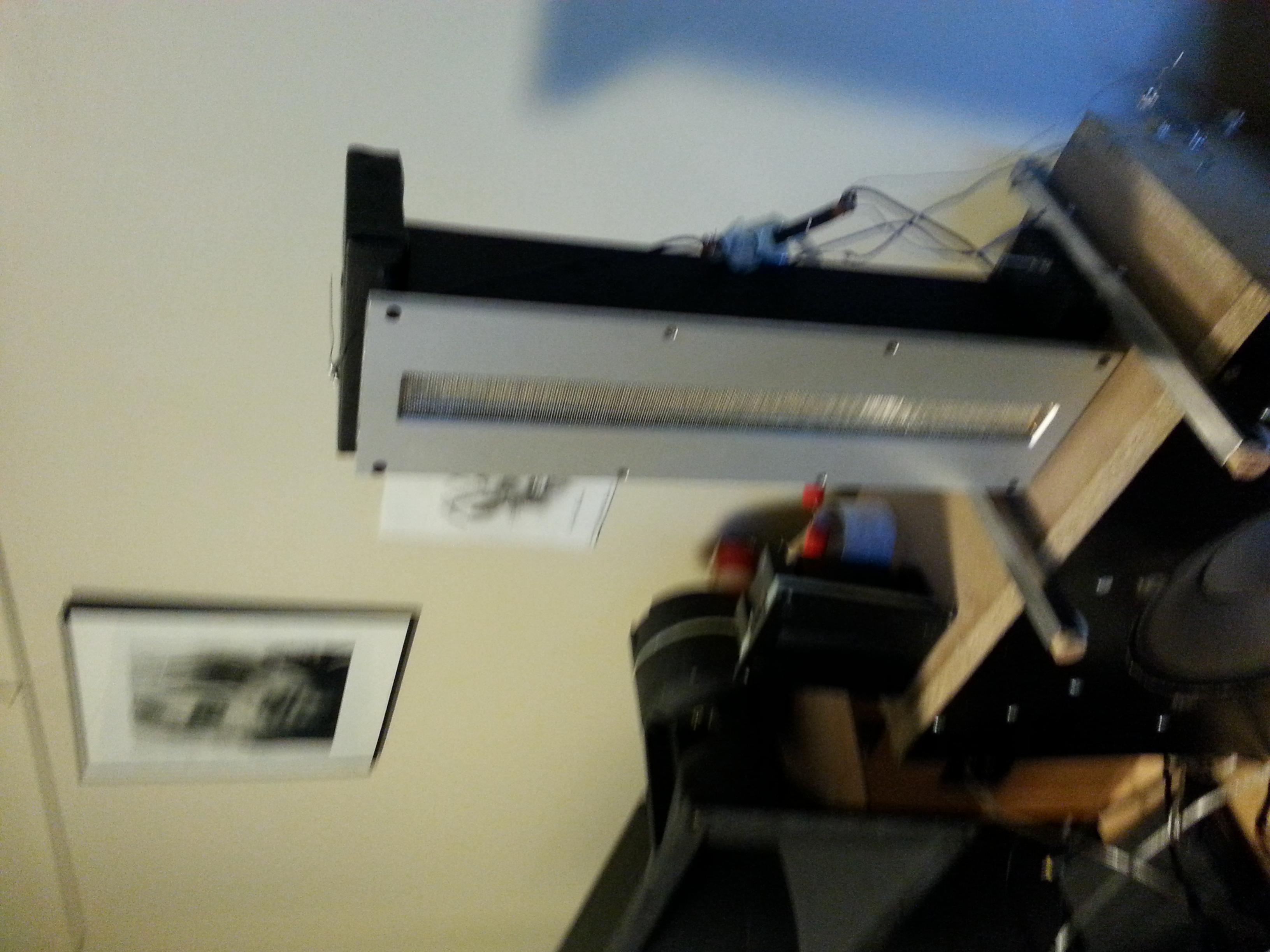

This one is pretty smooth. 🙂
That's not a compression driver, no matter where you hang it in a horn? 🙄

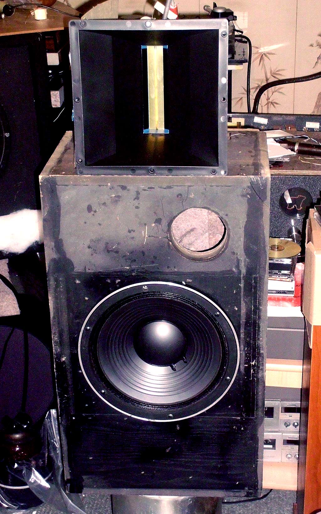

Ok here is a picture of a quickie set up of my ribbon. Mine is bigger and better than yours... nah nah naaa nah.:xmasman:
Coming next, after I download them, shots of of the inner guts of the phase plug on the 6681b!!

Sry to rain on your parade. 50cm ribbon beats that.
I use two compression drivers below 2kHz now. The JA6681 down to 600 hz and another down to 150 hz. No sub yet, but I am building a Labhorn to test it out.

Nice ribbon, commercial or homebrew?
may or may not be better... what's the reference sensitivity and impedance?
Seems to me that you could run ur 6681 down to that 150Hz point and get rid of yet another xover point, and/or run it up higher, like to 4kHz. The advantage to this is getting essentially the full "voice range" from a single source. In theory anyhow this would mean less phase shift, flatter response, and of course automatic "time alignment".

The ones shown are Stage Accompany 8835, they do >100dB/1w/16ohms, and will do 128dB SPL <1%Thd. Bandpass is 1.5kHz to ~22kHz. As with most ribbons their main issue is lack of vertical HF dispersion. Other than that, very hard to beat in that frequency range.
But generally I don't like to have a crossover in the middle of the audio band if it is possible to avoid it.

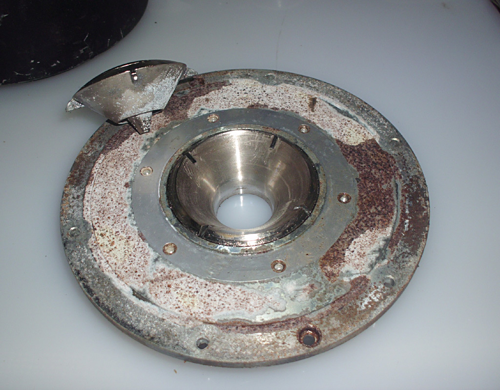

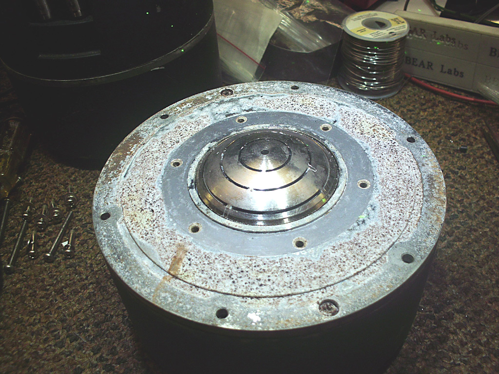

Yamaha 6681B Phase Plug SALTED
Don't store your compression drivers in the natural environment in Florida!! No, I don't live in Florida, but this one came from Florida. Yikes!!😱
Shown is the phase plug partially disassembled, from the side where the diaphragm installs (the back of the driver). Also the driver guts before the phaseplug was removed. The sound exits down in this image. The stuff all over the place is corrosion due to salt.

I would go at it with a dremel tool and be sure to tape over the magnetic gap. And later run tape into the magnet gap to remove particles. I bought a EL84 with a similar moisture issue. I used the dremel tool on every tube pin in the amp, and I got rid of a lot of noise.
I meant to go at the rusty old JA6681B with a dremel tool. Not the SA ribbon speaker.
