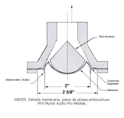

Performance in the top end will depend on the phasing plug, diaphragm breakup, and mass break point (motor strength vs diaphragm weight), whereas performance in the low end will depend on the horn loading and air displacement capability of the diaphragm (Xmax*Sd).
So when used on the same horn, the 2482 would only need 1/4 of diaphragm travel compared to the Atlas to move the same quantity of air and get the same SPL at low frequency.
A large diaphragm has not nearly the structural strength of
the little 2" inverted dome. The very thing that buys us a better hf extension
causes more distortion on the low end. At little excursion all is fine but
when we need more low end more air has to exit through the slits and we get
multiple non uniform pressure points on one large area, the thin duralmin diaphragm.
The way the Atlas/WE driver achieves the compression is top and shoulder
ahead. You get uniform pressure build up on a structural already stable
diaphragm, exhibiting very little distortion coming from the diaphragm itself.

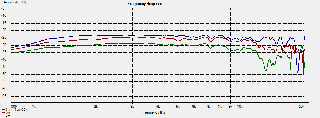

That BL vs excursion thing that you are explaining here preached for the largest possible diaphragm...
The phasing plug geometry does not come into play that much at low frequencies: the only thing that matter there is the compression ratio. It does come into play at higher frequencies of course, but there I'd expect the slit of the 2482 to behave better than the one of the Atlas... (and of course none of these drivers shall be used too high...)
By the way, the 2482 uses a phenolic diaphragm.

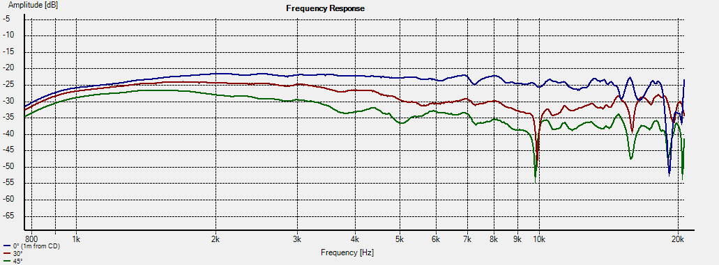

Radian, I am afraid we will have to have some disagreement about the differences.
The response you show is very good (unclear what the smoothing is) but it is not nearly as good as the documented response on the Azura horn with the Yamaha. The HF response of the K55/Atlas driver is not even in the same ballpark. As far as I can see the LF response shown is very much similar to what the Yamaha will do on a an appropriate horn.
No matter the K55 is an interesting driver as long as you can live with the HF rolloff.

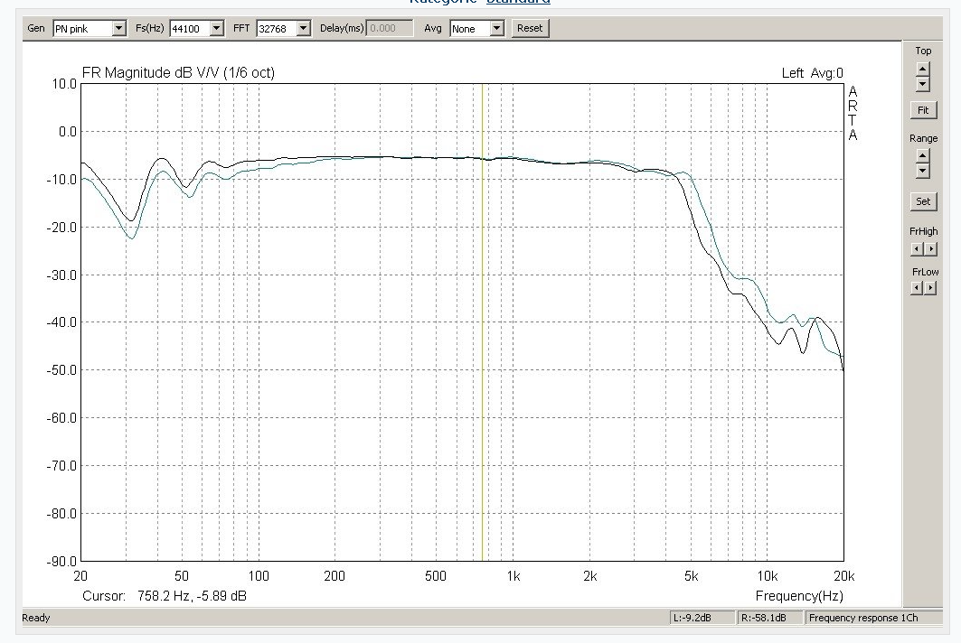

Both are well known phenomenons, so I guess we have to agree to disagree.
I don't even know what you are trying to tell me.
The BL product (force) to produce hf is way more than for low freqencies.
The BL product decreases the more the coil leaves the ideal air gap.
If you try to go as low as possible with a big horn pushed for higher spl and on the same time try to reproduce lets say 12k to 16k it will not nearly sound as good as the same driver on a small horn cut off below 500 hz or so.
That is fact and you can even try it with a fullrange driver pushed to hard.
Forget about the 2482 it will not outperform a WE555 on a big horn.
If you get the following low end extension with the JBL I will stand corrected.
Messured on a plane wave tube.
Who suggested such an application?
The comparison of the Atlas and 2482 (or other 4" midbass compression driver) can of course only be done on the same horn, same bandwidth, and same SPL!
Regarding the plane wave tube response you posted, it is indeed impressive.
What is the input level and absolute SPL?
Did you measure it yourself?
Is it a valid plane wave tube? (quite important matter at these frequencies)

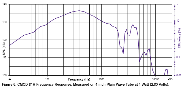

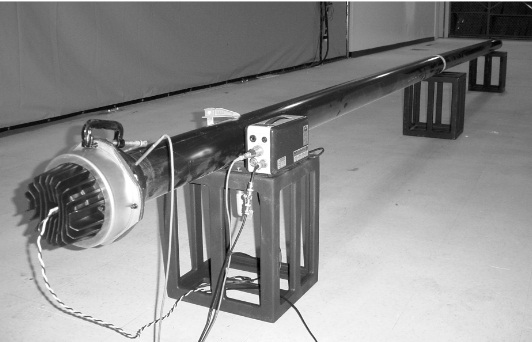

Klaus, as you don't seem interested in answering my questions regarding your PWT measurement, let me show you what a proper measurement should look like:
Here is the measurement of a JBL CMCD 8" driver, with a 4" throat on a proper plane wave tube:
Everything can be seen on this measurement:
- absolute SPL level vs frequency for a given input voltage
- the low frequency rolloff from the back chamber acoustic suspension
- the mass break point frequency (-3dB around 700Hz, exactly where the theory said it would be: BL^2/(Pi*Mms*Re), check the 2250H here) and subsequent rolloff
- the breakups above 2kHz
Just for the reference, here in the PWT used for this measurement:
Now comparing that measurement to your (?) measurement above:
- what is the absolute SPL and input level?
- where is the acoustic suspension rolloff?
- where is the mass break point? (don't tell me 5kHz 😉 )
- where are the breakups?
Do you really expect that $100 Atlas driver (2" diaphragm, 1" exit) to have better low frequency performances (SPL and distortion at a given frequency) than the last iteration of JBL compression drivers (8" diaphragm, 4" exit) ?
Woha, Cool down please,
1. This is only my opinion and not to be taken as gospel.
2., Romy has posted pictures and drawings of his horn and there is nothing
we don't know about it.
3. He has been using it, at least for a wile, all the way up to about 1,2 khz
as far as I know.
4. John Hasqin has build Romy's horn. It's a simple tractrix contour. Nothing
special. John is one of the most respected people when it comes to horn
speakers especially tractrix and it's iterations. He himself has stated several
times that the Fane would benefit from a phase plug .
4: There are plenty white papers on the net that show how important it is to
get the compression ratio and throat design right for ultimate performance.
5. Common sense and a the study of nature is all it needs to understand that
letting a cone even if only partially push against a flat piece of board is not
very wise and will cause a number of unwanted effects even in the lower
mid region.
A teacher in the field of hydraulics or aerodynamics would shake his head
upon the way this design tries to achieve the compression.
The throat is a high pressure/low velocity region that needs a passage as
smooth as possible to prevent unwanted turbulences which are in regard to
sound waves just phase and amplitude irregularities that our ears are
sensitive to.
Anyone who believes that these are not audible in the range this horn works
in is in my opinion naive.
It's easy to see that my proposal is not about a simple phase plug that
achieves a better hf behavior.
Klaus

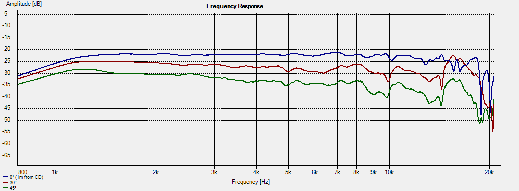

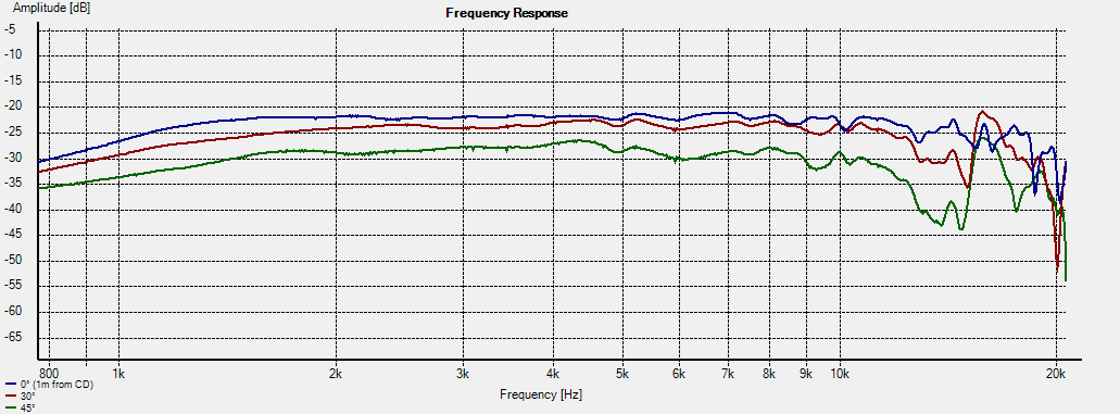

If you are interested by these horns, here are some directivity measurement of a 2450SL driver with truextent Be diaphragms, with EQ, on the SRX725 horn and a 90x50 PT waveguide (similar to the one found in the STX series).
horizontal SRX:
horizontal PT:
vertical SRX:
vertical PT:
Both horns are very smooth, and in the realms of 80° horizontal beamwidth, and the SRX horn also gains vertical directivity lower in frequency thanks to its higher profile.
Its profile looks similar to an OS or quadratic.
The 2451/2452 compression driver use in the SRX is also a bit better than the 2432 used in the STX, but it would arguably be better (less hash) with an SL (aquaplassed) diaphragm...
horizontal SRX:
horizontal PT:
vertical SRX:
vertical PT:
