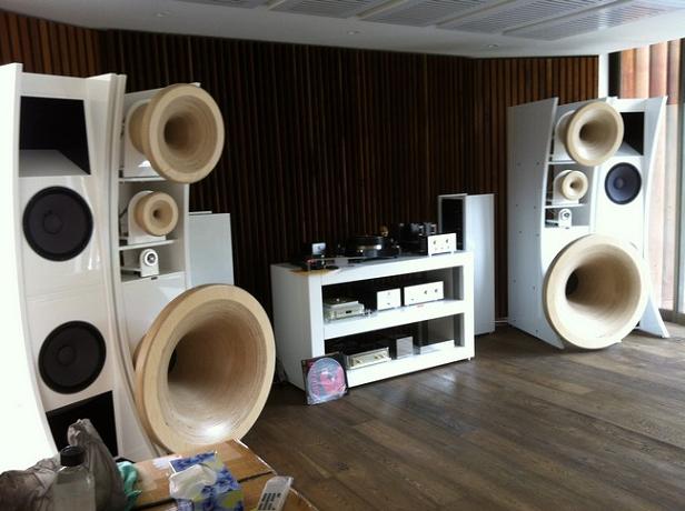

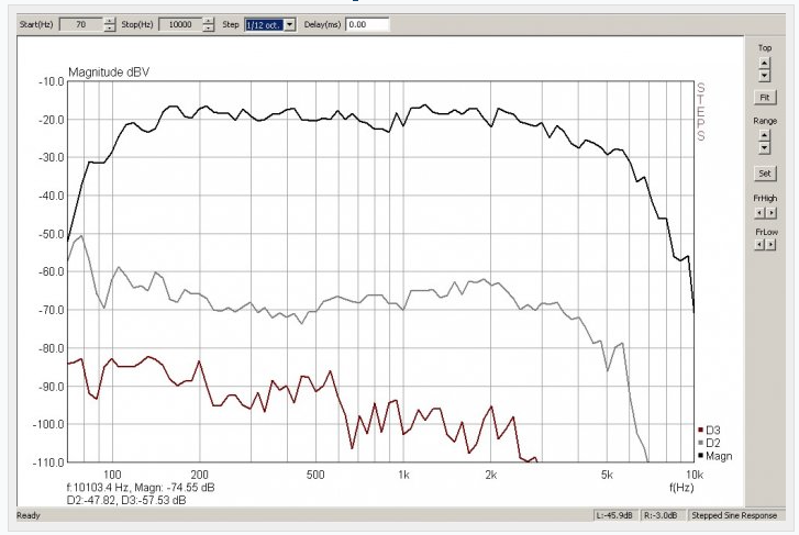

I have the Fane 8m below the JA6681, it operates from 120Hz up to 350 Hz and rolls off at 6db. If you can find a 12" which goes down to 80Hz the mid bass horn is getting large, but it would enable a sub to be used , Maybe T-TQWT from 20 to 80HZ. I am building a 15Hz horn below the Fane to run form 20 Hz to 120Hz, then cross to the Fane and then the JA 6681.

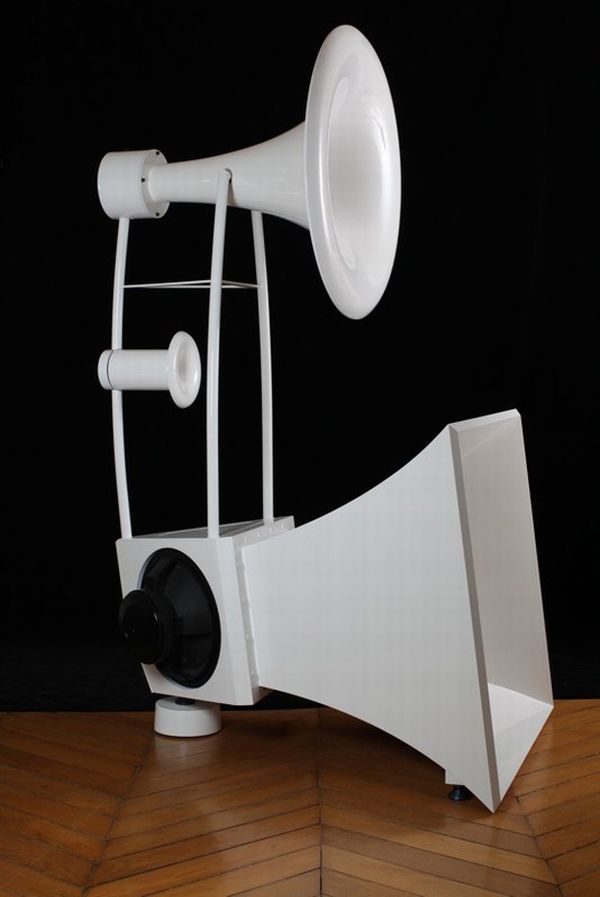

There are two commercially avaliable speakers, La Grande Castine and the Cessaro Gamma, that use a 15" driver or a 11" driver, instead of the 8" Fane as a hornloaded midbass speaker. Here is Romy's thoughts about these.

Actually they are identical. You can swap the diaphragm from one driver to
the other. As I said before, I suggested in the German analog forum to play
with that driver till it does what a W555 can do and Dietmar an experienced
horn fellow who is retired had done exactly that. A bigger back chamber and
a litte change of the compression ratio got him this output on his Sato horn:
Distortion D2 0,4%, D3 0,04% !!!
Now that's a driver who is really fit to cover the lower region. Much
more so than the JA6681b.
A system with JA6681b on an Azura can not achieve the performance
of a Sato with K55 and a decent 1" driver like Emilar, Radian or TAD on a CD horn.
Non critical crossover points and a pretty uniform radiation pattern all the way up,
can not be beat sonically by any big tractrix horn no matter how hard anyone tries.
Klaus
