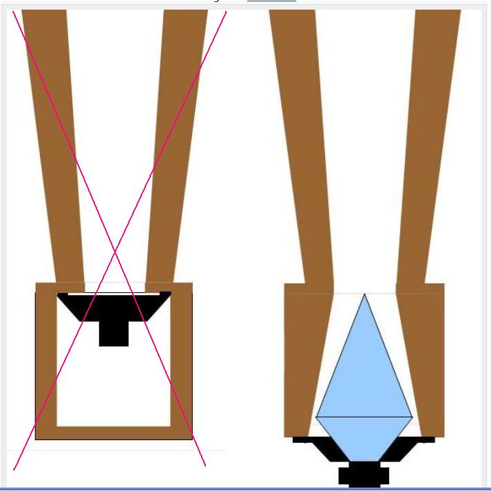

Sorry I have not checked this thread for a while.
I had a drawing done in 2010 for a discussion in the Analog Forum.
It was very crude but I show it anyway. The widest part of the phase
plug should be at the edge surround of the cone and not like in the
drawing that shows it above that point.
Starting at the pole piece of the speaker a phase plug should be
progressively open up, following the contour of the membrane. I would start
at about 3mm clearance to the cone at the pole piece and try to end at
the edge surround between about 8-15mm. Of course this depends on the desired
compression ratio and the size of the cone.
This way the compression happens almost like in a WE555 driver.
In my opinion this is the most important feature in the WE555 that makes
it sound so natural. If one would envision a fluid being compressed in a
normal compression driver vs. the WE555 it would be clear what was the more
natural and smooth way.
With a cone speaker it is not any different.
To cover a third to halve of a cone with a flat piece of board is IMO not wise and far away
from optimized airflow. Great care is taken in a hf horn to find the best contour and good
throat transition and when it comes to low frequency reproduction we seem to forget everything.
As if the laws of physics do not matter as much at those frequencies.
At the moment I have no time to write my thoughts about the subject in more detail so this has to
do.

Radian: Are you sure a phase plug is needed for the Fane driver when it driven to just 400 or 500hz?
