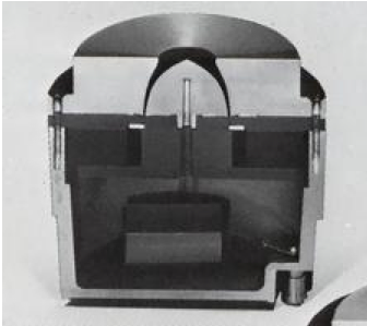

But I put a picture up a few posts back...

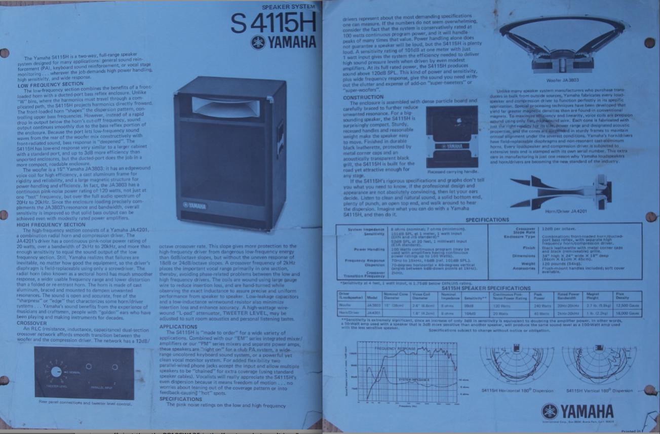

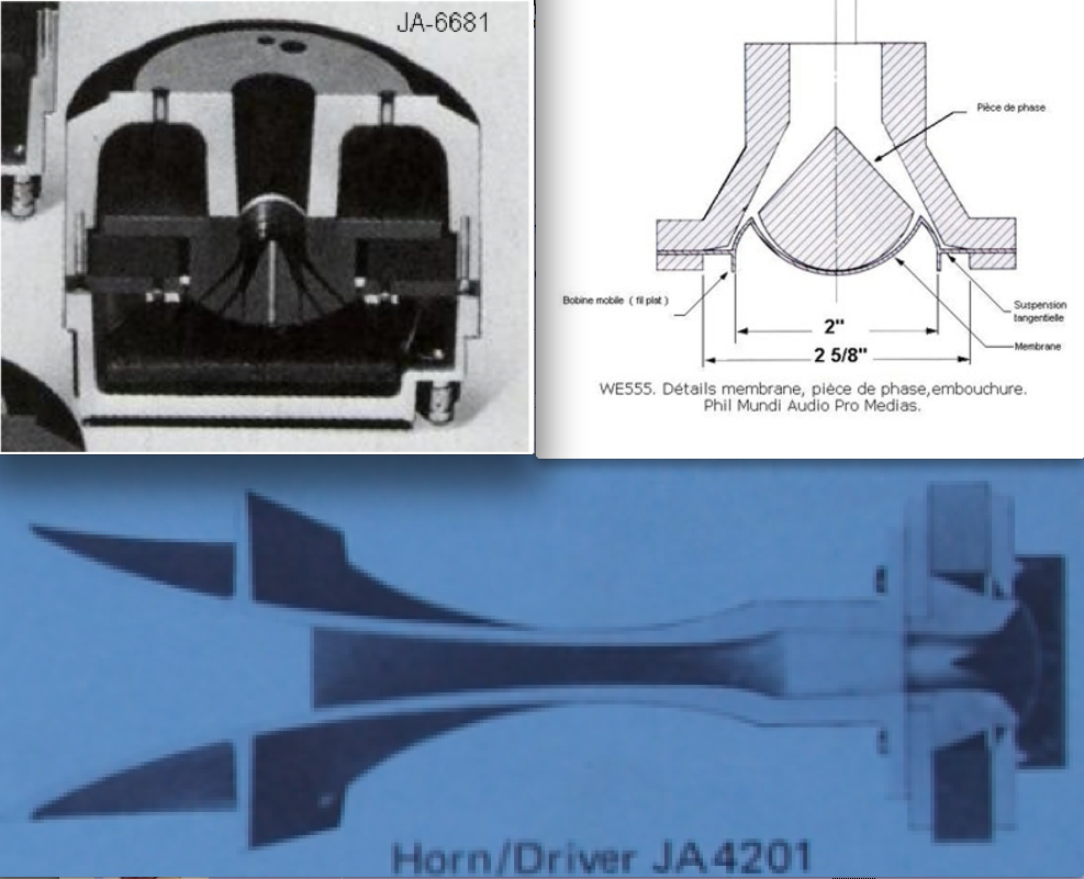

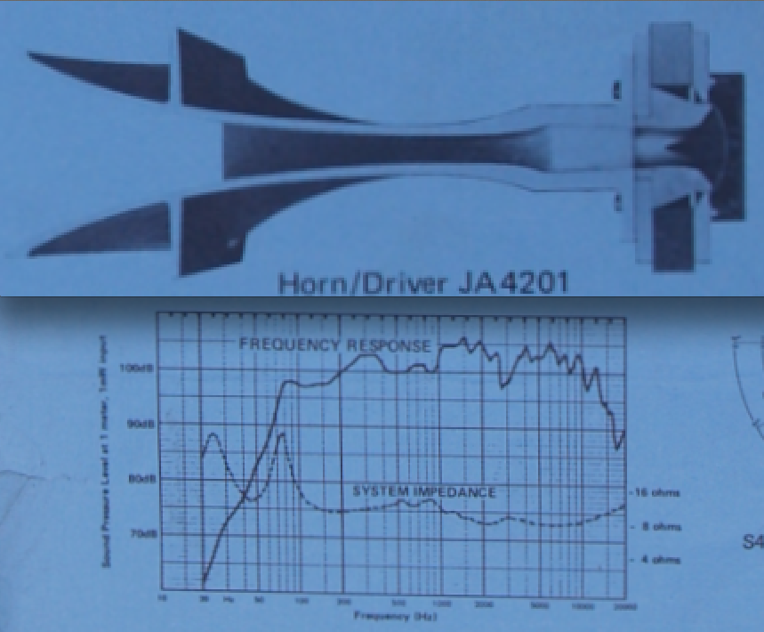

Klaus,
Looking at pictures of an old throw sheet from the 4115H (which I have had in my files from when I was an owner back in 1978!) I found it used the JA4201, aftermarket diaphragms have been available for them since the 1990s.
Appears the aftermarket diaphragms are made of titanium rather than the original aluminum.
Does anyone know whether the JA 4201 phase plug has slits like the JA 6681, or lacks them like the old WE555 ?
My throw sheet does not have enough clarity to see, and my old partner Willy (RIP) was the one that burned and replaced 4115H & 2115H stage monitor diaphragms back then, so I don't recall ever seeing the insides of one.
Art

I think it is important to differentiate between the 6681's slits and almost all other slits, they're a bit different.
Can't see from ur post what is there, but I guess you couldn't see either.

Still wonder whether the JA 4201 phase plug pictured in post #213 used in the 4115H and 2115H has slits like the JA 6681, or lacks them like the old WE555 ?

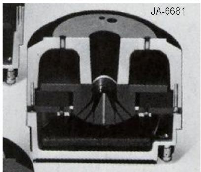

the 6681 has a unique phase plug, I haven't seen one quite like that, although for all I know all sorts of newer drivers have adopted that general scheme. It's afaik somewhat different than the usual slit method first used in the WE394 (? do I have that right) and then copied down the line by JBL and Altec, and almost everyone else since.
So are you asking if it is slit type or a slit type like the 6681?
Hmmm... that's axial phase plug slits, right?
_-_-
The 6681 phase plug contains both an axial and a bifurcated axial slit, the latter being unusual.
My question is whether the JA 4201 phase plug has slits, or is like the old WE555 with a single slot around the diaphragm's perimeter?
More likely it has slits, but from the old picture, can't tell.
