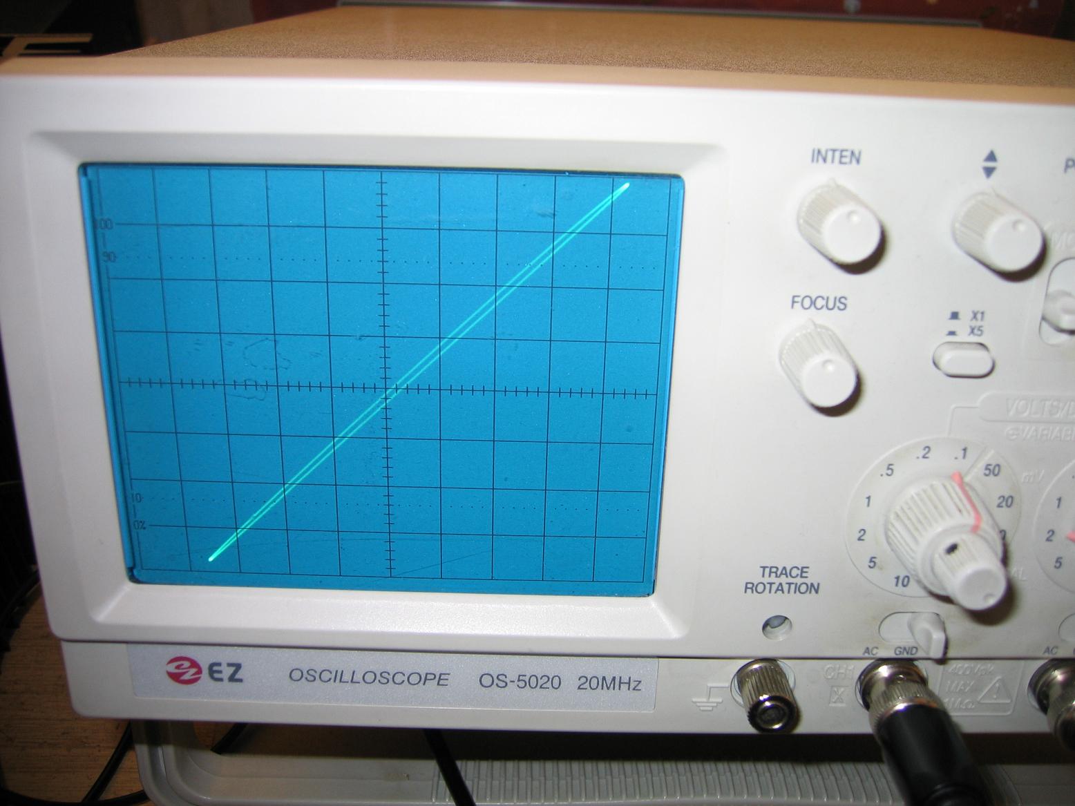

FYI (For Your Information) - the measured result at 100kHz (I am attaching it again) and the simulation result at same input voltage are completely different. You are saying that simulators do not make mistakes, but they are only as good as models used. If you want to live in a virtual world only, then poor models and incomplete maths are perfect for you.
P.S.: as a real world amplifier design is my know how, I will not show the simulation result. Your turn to learn real world design.

t is time, α is angle, β is constant
Vdif= U1*sinus ω(t+0)- U2*sinus ω(t+ α)*β is mathematically incorrect
If you do not know mathematics, so you must prepare amplifiers trial - error
No worries, simple math, simple formula. Who knows what we are talking, knew the correct results. He who can not use the correct values, the correct result will never know.
You must prepare amplifiers trial - error .
The formula is incorrect, you cannot add time t and angle a. Either use both time or use both angle.
Also, it is not clear what you mean by U1 and U2. It seems that U1 is the peak input voltage, and U2 is the peak output voltage. Is that what you mean?

Yes, exactly. U1 is connected to the positive input. β is the transmission of output to the negative input. β is not constant.
β is not constant? That's new. Why/how not?
Are you really teaching electronic circuit design?
BTW The formula is still incorrect, you cannot add time t and angle a. But you don't seem to be interested in correctness anyway, right?
