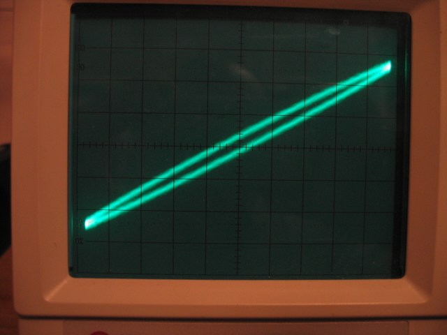

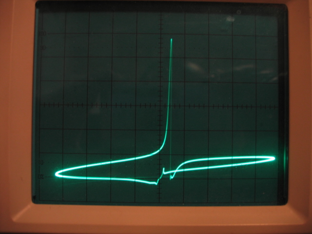

Blue, oblique line is the ideal transfer characteristic. There Vdif = 0 Actual characteristic is brought to the feedback divider. Deviation from the blue line shows the voltage does not represent the phase relationships when the capacity is used, etc.
I asked to know what kind of a plot you require (Lissajous). No problem to measure tomorrow at 100kHz Vout/Vin, my amp handles 100kHz without any problem.
BTW, the plot shown was MOSFET amp with error correction, output forced by current. X - current, Y - voltage at output terminals.

7.8 V output voltage for 4Ω and 100kHz? Is about 16W. Nice result. Angle α is arctg 2 / 38 = approximately 3 °. Is an excellent result. Vdif = approx 10mV, excellent result. Moreover, these topology, which has a better course Vdif.
My compliment!
How would it look for full performance?
How does simulation? Is similar?
The X and Y scales of the scope are calibrated.
But, I still fail to see any relationship between this measurement and distortion and subjective sonic results. For example, this amplifier has JFET input stage. As you know, the linear part of the transfer characteristics of the JFET differential stage is much wider than that of the BJT, but Gm is lower. How would you generalize your 'Vdiff results' ?

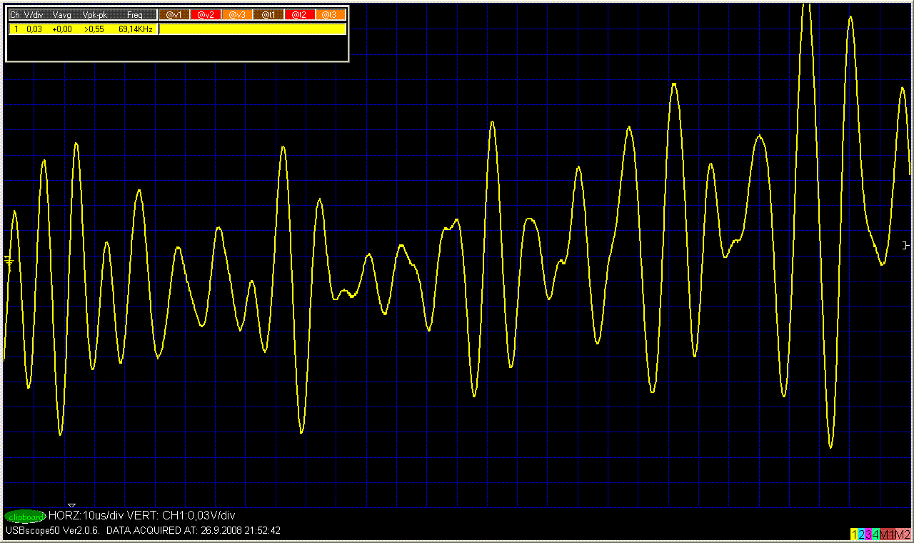

Regarding Federmann's concerns of 100kHz frequencies in audio signal etc. - the worst case with highest RF content I have ever measured is the SACD DSD ultrasound noise, which rises fast above 30kHz. This noise is much higher in amplitude than any musical instrument ultrasound components recorded anywhere. An example of the DSD noise is attached (voltage and time scale shown in the image), and it is present despite the obligatory 50kHz low-pass at the SACD player output :
