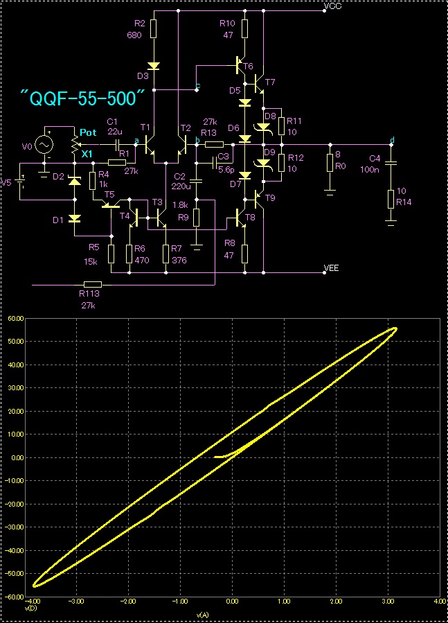

MOSFET simulator models are quite incomplete and do not fit to real devices well.
If you do not model, write down the models better. Write to such models in order to avoid mistakes. If your model is not enough, write Macro. More I can not advise.

You are showing only sad illustration of the fundamental misunderstanding of context. Phase shift is the inevitable consequence of the final frequency range, not vice versa, increasing Vdif as much as it inevitably falls OLG, so distortion with frequency is increasing. However you can not removed this simply by increasing OLG gain to "infinity", (eg by omitting degeneration in dff. Iinput)as you hope, because you get not an amplifier, but oscilator, certainly with showed PCB.

Federmann, I wish to honestly say that as drawn, your amplifier will oscillate and even blow up, due to REAL devices, especially the mosfets, and difficult loads, such as real loudspeakers, wire, etc. However, I like your principle, and I think that in an ideal world, it is a good approach. If you can, please read Solomon: 'A Monolithic Operational Amplifier: A Tutorial Study', hopefully for increased insight of real world limitations of actual devices, and how they compromise an 'ideal' design. I realize that you are more sophisticated than this tutorial implies, but you appear to overlook important problems, that if not considered, will make any practical effort, useless. Also we should talk to Kirkwood Rough, who is a mosfet designer, who can help here. He is on this website as well.

Federmann, I think that you feel that you are needlessly diverted by REAL aspects of amp design, that if taken to extremes, might dilute your theoretical efforts. You might be correct, and I wish that your countrymen, as well as other critics, would back off, so what you are trying to say, is what is discussed here. I personally have not gone through every graph, and sometimes I even have trouble reading your graphs, and what they actually mean. In other words, what might be obvious to you, might not be to me.
Still, any deviation in a differential input in this design, which generates the amplification of the input signal, will MODULATE the output phase shift, and this could be important. It is not easily measured, because we do not measure the FM component of amps, normally, and any signal will create some FM component, but the very nature of the design, UNLESS the open loop bandwidth is greater than the working bandwidth.

I have not been following this thread closely, but I must say once again that as long as the CLOSED LOOP bandwidth is the same, a given amount of nonlinearity in the input stage will create the same amount of PIM, or FM distortion, as you call it. Open loop bandwidth has no direct influence on the propensity of an amplifier to generate PIM as long as apples are compared to apples.
It is also important to realize that PIM WILL show up as sidebands in a 19+20 kHz CCIF IM test.
It is also true that it is virtually impossible for an amplifier to create PIM without also creating a substantial amount of AIM. This is because PIM usually results from an amplitude-to-phase conversion, and that conversion is far less than 100% efficient.
Lastly, as I have pointed out before, the mechanism of input stage nonlinearity for creation of PIM that you discuss is not the only source of PIM. Amplifiers create PIM in the open loop as well. Indeed, open-loop PIM tends to be reduced by the application of negative feedback, as are most other distortions. This means that even Charles Hansen's no NFB amplifier will exhibit measurable PIM.
