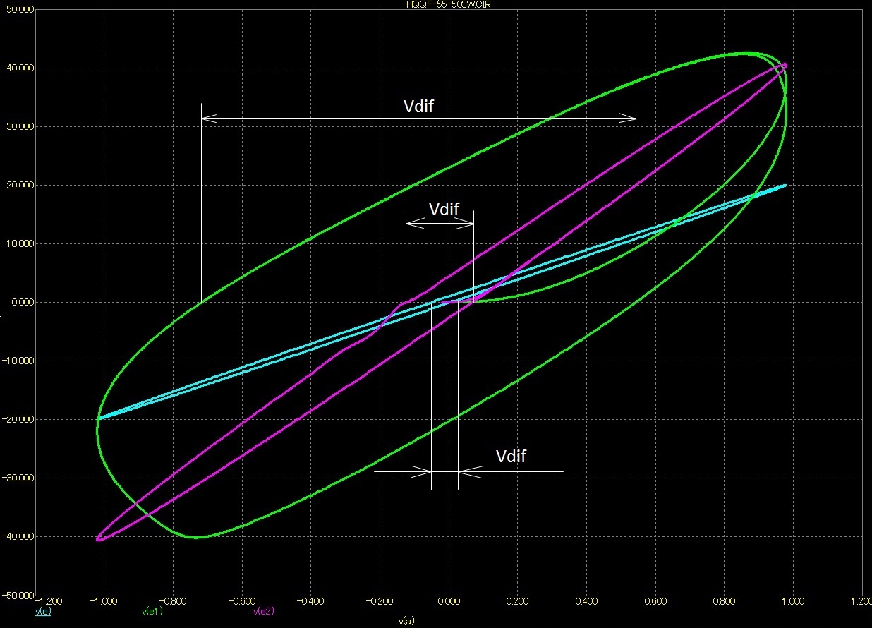

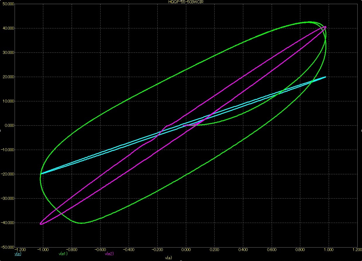

I am not claiming that the phase shift caused by bias. I say that:
1st Phase shift indicates a ratio amplifier and a decrease in amplification.
2nd The decrease in gain less suppress non-linearity amplifier.
3rd The decrease in gain increases Vdif.
4th Vdif gets into the nonlinear region.
5th Cause the nonlinear, then modulation.
The worst situation occurs when large changes in audio signals and high harmonics.
I say that the phase shift may be a measure of quality amplifiers. We need to know the involvement of input circuits and the size of the output voltage.

Ahhh, yes I think I get it better now.
OK:
1 - yes, if you mean by ratio a roll-off;
2 - yes, ther is less excess gain to let feedback decrease the distortion;
3 - yes, less excess gain, more Vdiff;
4 - Aha, now I see what you mean. Vdiff gets bigger, and Vdiff is part of the input signal, so now that combined input signal gets into the non-linear region of the LTP so that increases the distortion. I need to think about that.
5 - see 4.
OK so I think we have here the crux of the matter. What does everyone else think? I'm not if we have cause and effect correct, but I may be wrong.

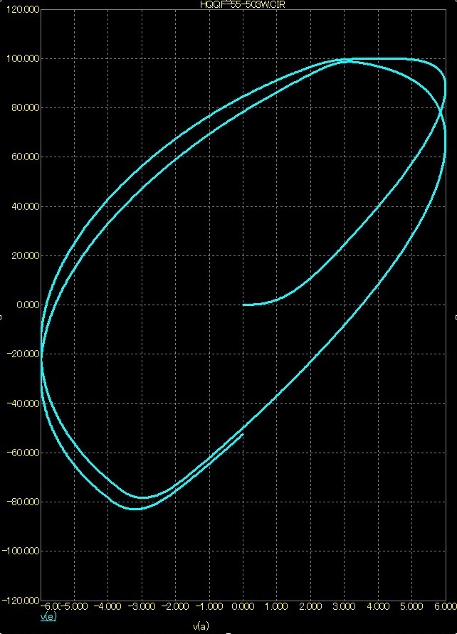

Make amplifier transfer characteristic, x = input voltage, y = output voltage is very interesting. Monitor the effect of feedback at different frequencies. Is seen rotate the output stage.
Shape characteristics of a lot to say.

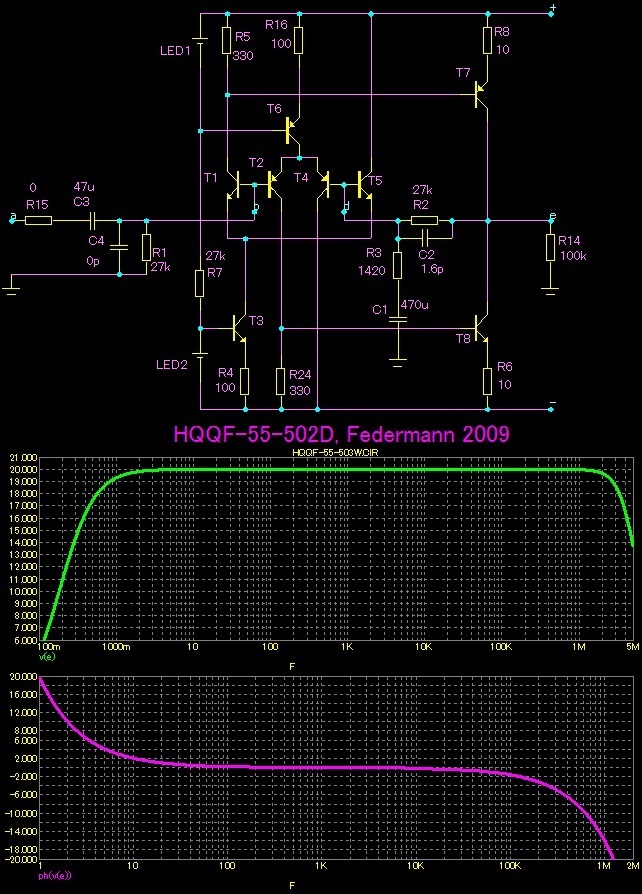

He hopefully might have a good effort, but circuit examples are lousy.

Measuring the delay pattern Lissajouss much to say. That is what I meant X-Y. You can see the delay and linearity.

Vdif might not exactly, but to have an idea that's enough.

Big gain, no local feedback, extreme bandwidth, so I am building an amplifier from the 70s Years. If you want to hear, DPA for me were never good enough. Transistor always hear the sound.
Some hear, others not hear. Hearing is not comparable and repeatable benchmark. Lacked foothold in theory. Lacked explain why the fast amplifier, without local feedback, with less distortion, listening better.
Today is my explanation, you do not understand, you do not agree, it's your personal thing.
Federmann, we both can the same...but I have, in contrary to you, many experiences with FUNCTIONAL mosfet amps and I claim, that your design will be not work, 'cos you have there many design faults. I can't tell, which they are, you will see them later, but remember, you can't to make amp with only one global compensation, which will be stable into every type of loads. Prototype of my mosfet amp 330 was very fast ( 26 V into four ohms / 900 kHz ), but it was in border of instability - not in every cases is fastness right thing...much more interesting thing is stability in every conditions and many others behaviors....
