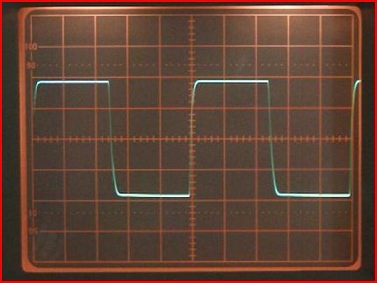

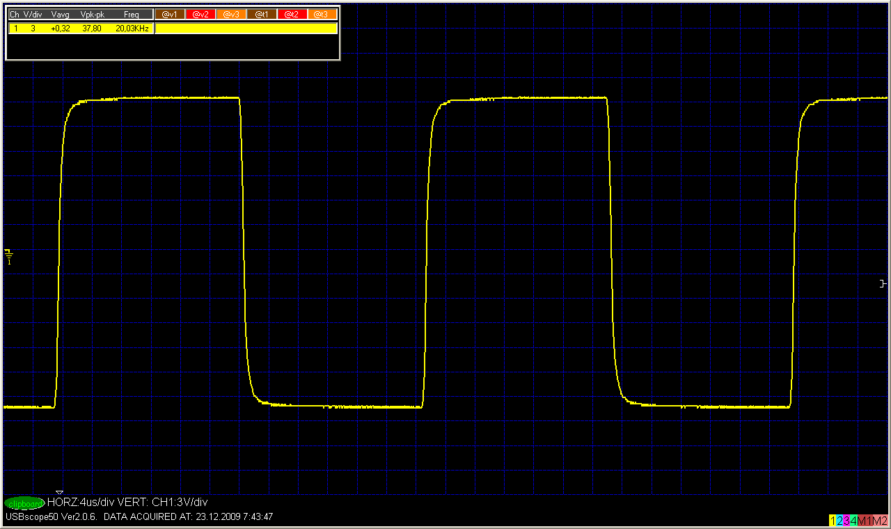

Excellent. So could you kindly show measured (not simulated) 100kHz sine response at full power, and 20kHz square response at half power? Load 4 ohm, and 4ohm with some capacitance in parallel. Measured on your amplifier that fulfills your Vdiff criteria. This would be a good starting point to assess a real quality of your amplifier.
As a starter, I have prepared 20kHz square measurement into 4ohm load, of the PA2 power amplifier

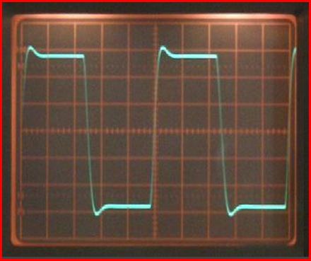

So can we see some scope shots please along the lines of these which show a prototype HEXFET amp at 20 volts into 5 ohm at 20khz, and then with the 5 ohm replaced with a 2.2uf metalised polyester cap... you could draw an arc connecting and removing that 🙂
Let's stop going round in circles please... scope shots are worth a thousand words IMO
Your amp may have some merit... please let us see real performance measurements of it.
