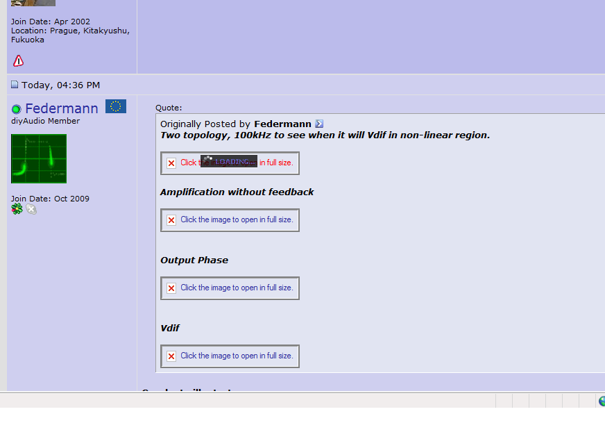

Delayed output voltage is compared with the input voltage in the differential stage. Long delays mean big Vdif.
Two topology, 100kHz to see when it will Vdif in non-linear region.
Amplification without feedback
Output Phase
Vdif
Graphs to illustrate.

I'm not listening to Vdiff, am I? Are you suggesting that this Vdiff can be 'heard' in some way?

I can't see any of these attachments, and I can't connect to them directly. Why?
I can see them, all of them.

I can't any of his attachments, anywhere. I can't connect to the site they originate from. Odd.
