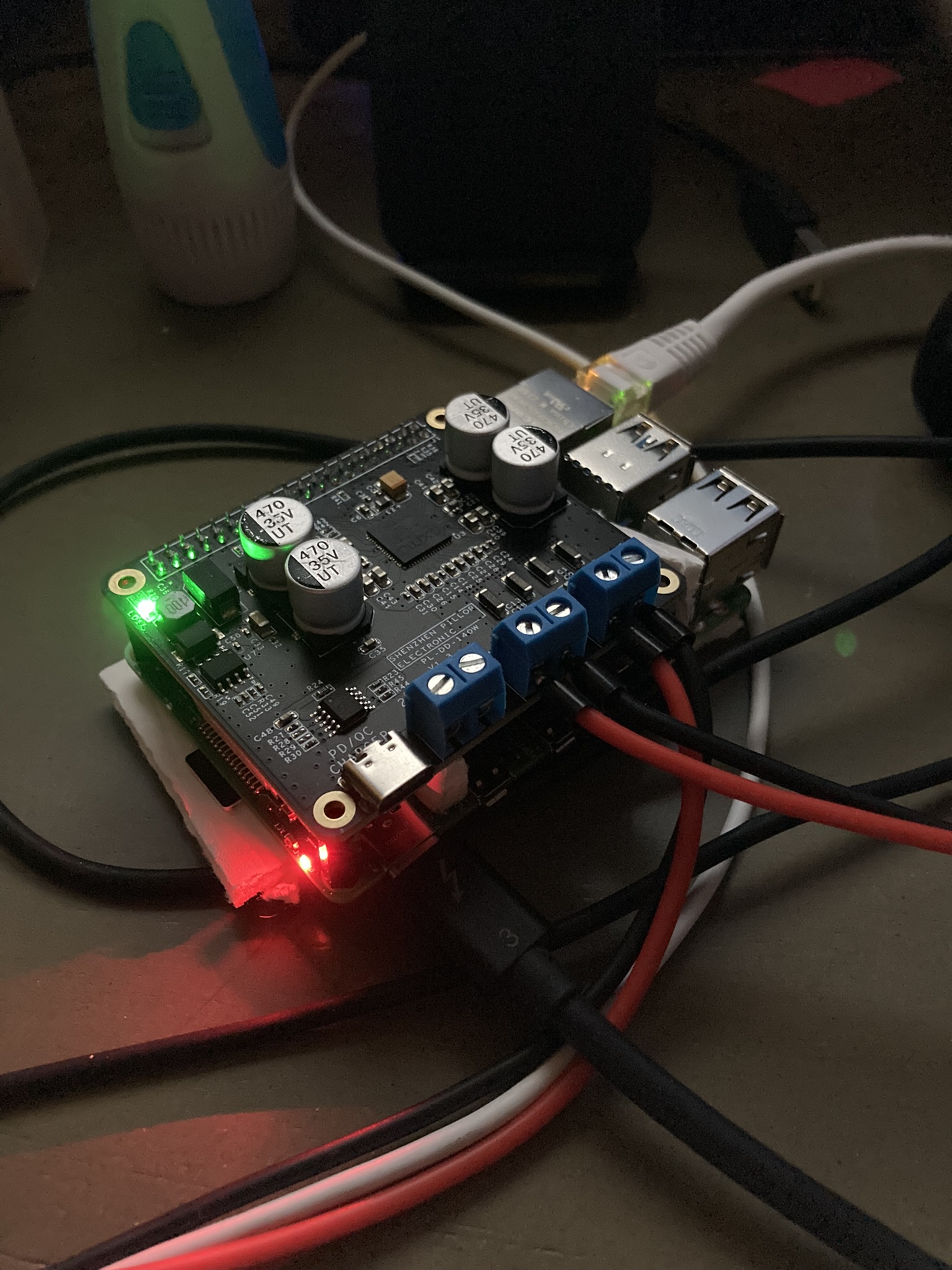

I now have the Merus HAT amp working with piCorePlayer and playing music very well.
I had to SSH into the pi to make changes to ALSAmixer settings. For some reason I couldn't change the settings within the piCorePlayer menus (even though the settings can be seen, they couldn't be saved).
It sounds quite good. I understand how these amps have surprised people. I like the silent background and abundance of detail. The overall balance from low to high frequencies is impressive. Maybe just a bit light on bass, but it's just a wee little thing with ~20VDC rails. There is a bit of power output limitation because of the internal limiter settings, but it gets plenty loud enough for my listening.

How are you powering it? In your photo I can't see a supply connected to either of the power connections?I now have the Merus HAT amp working with piCorePlayer and playing music very well.

I was using one of these GAN usb-c chargers:How are you powering it? In your photo I can't see a supply connected to either of the power connections?

Worked the same whether plugged into the pi or the HAT with a TB3 cable.

Are you saying that if you power the RPi4 using this supply via the USB-C port it powers the amp HAT via GPIO? I'm surprised, as I thought GPIO could only pass 5v maximum?
I measured the DC voltage at the power-in terminal block on the HAT. I’m not going to try to measure at the IC. I’d definitely fry something.
Oddly, though. The ALSA mixer settings didn't save from last night. I even used 'sudo alsactl store' to make them stay, but no dice. I'll need to find what exact files I can change to keep the right settings.
- TB3 cable into HAT: 20.16V
- TB3 cable into the Pi: 4.6V

I was unaware of USB-c Power Delivery until your posts.I measured the DC voltage at the power-in terminal block on the HAT. I’m not going to try to measure at the IC. I’d definitely fry something.
So it’s working as expected. Remarkable that it works at all on 4.6V, but it should be powered by a supply into the HAT for full performance. 👍

You'll fry it if you supply 24v (despite the board saying 26v max). Ask me how I know!Normal that it works with the pi power supply.
your Hat card is equipped with a buck boost.

Is it really ma12070 which accepts 24 volts or its little brother limited to 19 volts?
Enjoy!!!
The board designer stated the board is setup for 20v supply, but will tolerate 22v. See his post here:
https://www.diyaudio.com/community/threads/infineon-ma12070-class-d.347422/post-6814624
Thank you for the link... It's clear... Too bad not to exploit the full potential of this WONDERFUL CHIP... If
I understand it is the components that revolve around the chip that limits? .
If you remove the CH224K (10 pin package near to the USB input) and use the screw terminals, then you can run at 24v
