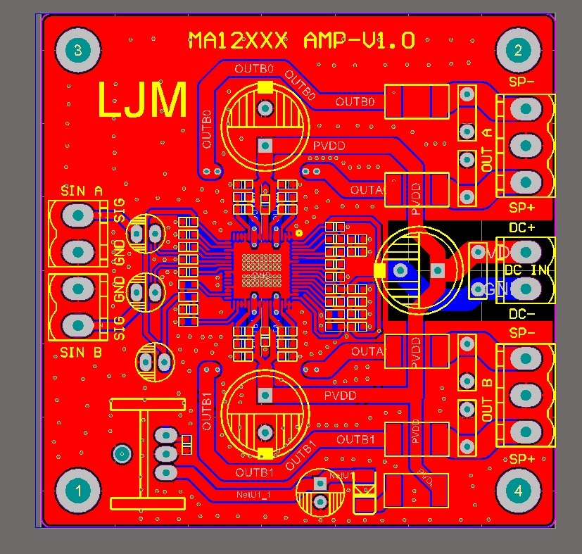

You can rest assured that I will design it and give the information on it.
In addition, I found that many Chinese chip manufacturers also have similar chips.
I will also design it for free. For example, Shanghai chipstar IC
Yes don't reject suggestions. Surprise us all with your skills, ljm_ljm. You may ironically be the best designer of a MA12070 PCB that get most out the chip. If you will do it: features like full output filtering, 5 mm pitch film input caps, MKDSN power supply connectors, ceramic caps preferably avoided so 5 mm film caps (but also SMD PCB pads just in case), pads for onboard linear regulator like LT/LD1084.
Enough similar stuff that exists but not many so well liked as the one in this thread.
Nice start but no film input caps (4 pieces) and no balanced input/opamp circuit to make balanced balanced so the chip will definitely hiss. Output connectors could be the 2 pin version. Decoupling caps of the chip should be X7R as minimum standard so larger types. My personal question is if if makes sense to use TH film caps for decoupling despite their higher inductance. Why? In many cases where I replace the in that regard superior ceramic caps the device performs better instead of worse. For the input caps this is a 100% clear improvement too.
Input section can also exist of a unbalanced/bal transformer of Far East origin (so affordable) coupled with an onboard volume control like the standard Alps RK27. Resistors in 0805 for ease of soldering and caps at least 0805 to even 1210 for the 10 µF types (or 5 mm film if we are not afraid). With both 1210 and 5 mm TH pads things can be tested. In my experiments I found the chip performing nicer with regulated voltage and no SMPS so I would include pads for a 5A TO247 LDO reg with heatsink, 30 mm 10.000 µF 35V snap in filter cap and Schottky rectifier diodes.
Contrary to most devices we see on the market this PCB should be to aim for (subjectively) highest performance not lowest cost/highest margins. So against all normal (?!) design considerations aim for highest quality and high cost and then scale down if necessary. We see enough hampered designs without output filtering, gazillion opamps of unknown origin, armies of Class III caps and cheapness all around. Point being that these cheap devices already perform quite nice due to MA12070.
If the IC would be simple to solder I would already have made my own PCB. However I think it is slightly over the threshold of average level DIYing.
