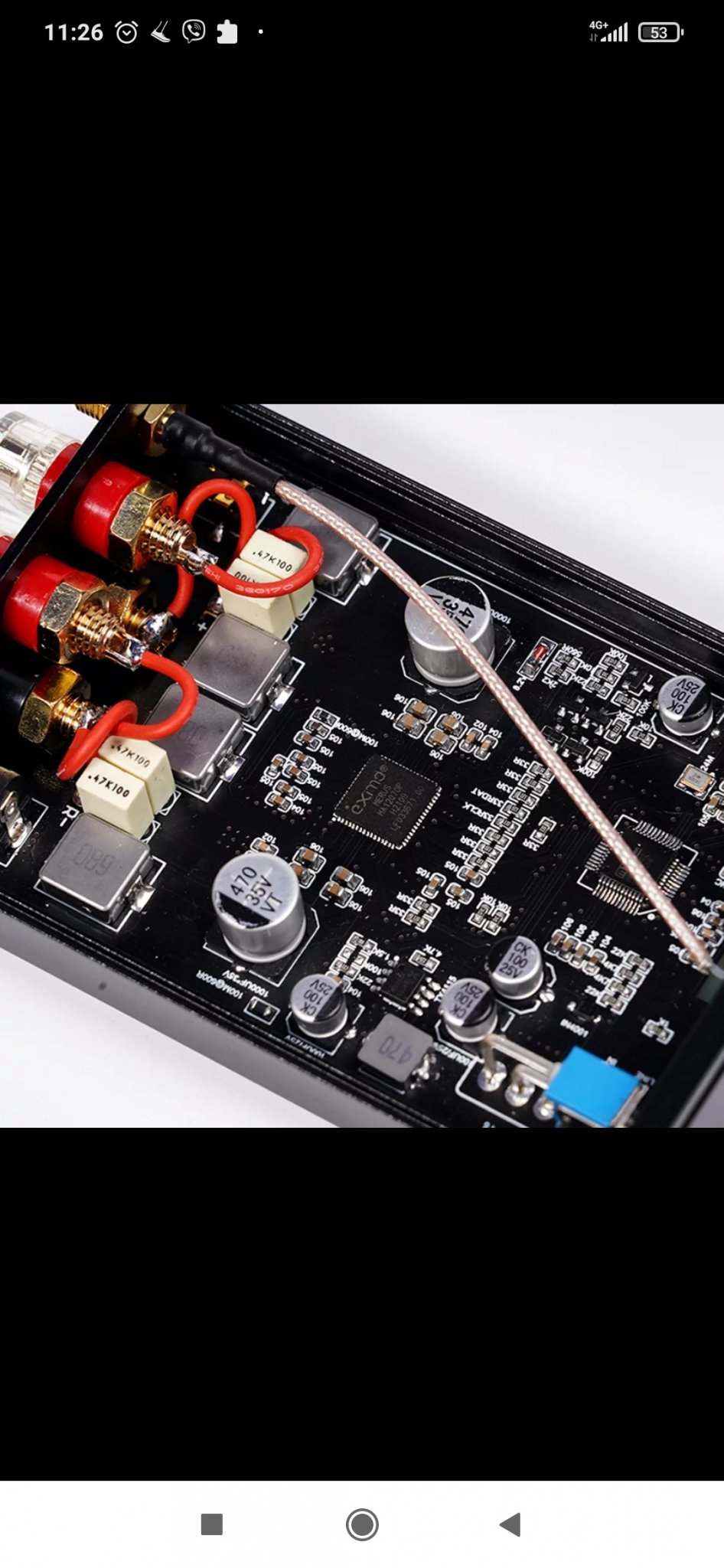

No caps after the coils (LC remember?) which is left on your picture. They could be added using the L+ and L-, R+ and R- pads when one knows the properties of the coils. If one wishes to do stuff right that involves measuring the coils, recalculation, remeasuring etc. The Aiyima exhibits a loud whine after switching it on. Still have to find out why that is. Not over the loudspeakers but through its casing.

Mmmm, .3 ohms from Cap c20 to output of coil L3 .No caps after the coils (LC remember?)
Unless the damaged chip plays a roll here we have a filter

Rethink that one 🙂Mmmm, .3 ohms from Cap c20 to output of coil L3 .

Depending on the block diagram there should not be any cap touching the output traces of the chip unless there is filtering applied. Where I measure makes no difference here as the coils have almost zero resistance.

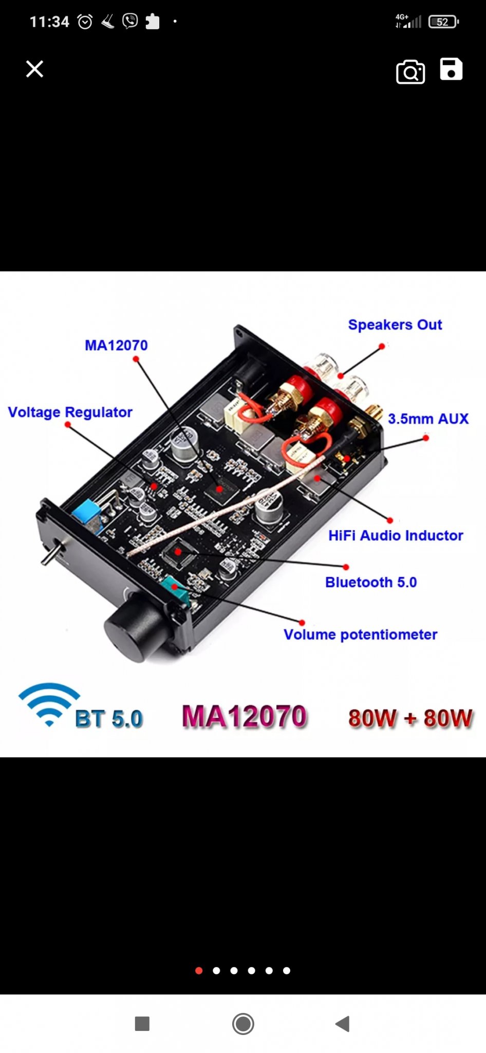

Aliexpres, but i have problem to pass a link ???🤔For me it is about price/quality ratio with emphasis on the latter item so no SMPS for instance. I would like to see that design when it really costs 20 Euro. A quality design in all aspects with best parts for the purpose, no gadget like device. The nice thing of Chi-Fi is that many only got to know this chip because of the cheap gadget devices that lack a necessary feature here and there 😀. Only the power transformer for a decent design cost me 25 Euro today and this was a 50% discount transformer. Normally it would be 50 Euro and then one needs to add costs for rectifiers/filter cap/regulator/heatsink to that. Casing cost is also relatively high nowadays.
Rethink that one 🙂
Nesha, do you have a link? Seems they knew how to design a device.
C$ 36.43 9%OFF | KGUSS D70 MA12070 MINI HIFI Class D Digital Amplifier Supports Bluetooth 5.0 70W*2
https://a.aliexpress.com/_mLnPuMi
HRK 131.57 20%OFF | 80W+80W Bluetooth 5.0 Infineon MA12070 Class D Digital Audio Power Amp AUX HiFi Stereo Amplifier
https://a.aliexpress.com/_mtDRLBk
