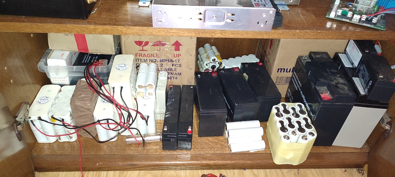

I work on a daily basis with industrial quality SLA batteries in high numbers and in high power applications. Also there is either 13.8V or 27.6V which are both simply inadequate for this chip and thus category "just doing something". Therefor no lead acid batteries in my home.
I had a pair of gel cel 12V batteries originally intended for class D amp power. They got conscripted for electric lawnmower use!

I get all kinds of Batteries for free because of my Job. It is very expensive to get cleaner power then from the right kind of battery for the Job.
The digital side of my dac has 3.2v Lifepo4
The analog side did not sound very good with 6.4v Lifepo4 but my LT3045 regs for this job are in turn fed by 9.6v Lifepo4.
As soon as I complete my overnight charger, I will try Nickel Cadmium on various places.
No reg in the world can approach NC Batteries.
Nickel Cadmium batteries are a special breed, especially the fluid NC kind. Way longer lifetime compared to lead acid.
Anyway the more one works with high power batteries the less the desire to use them in a home. Not for everyone of course.
