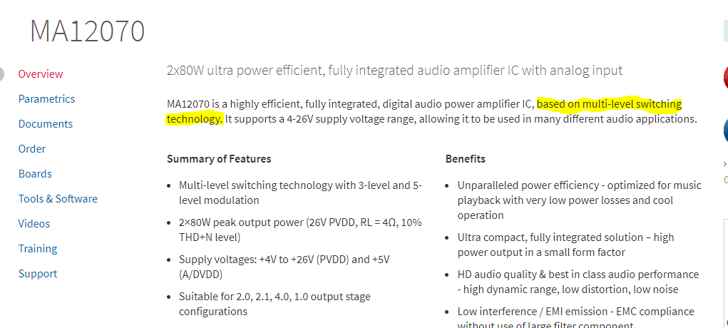

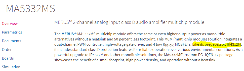

3. Jlesterp: shows part datasheet of MA5332M where it only says that MA5332M has the same protection features as its predecessor IR43x2M.
4. Jlesterp concludes that MA5332M is a IRS2092 with integrated MOSFETs. Wrong assumption as IRS2092 is not mentioned. MA5332M datasheet only says IR43x2M to be a predecessor with the same protection features. Saying that MA5332M could be a repackaged IR43x2M contains more truth but is still on thin ice.
5. JlesterP shows part of datasheet of MA12070 being based on multilevel switching technology. True but has nothing to do with the subject. Both MA5332M, IR43x2M and IRS2092 are NOT based on multilevel switching technology as that is the novelty of MA12070.

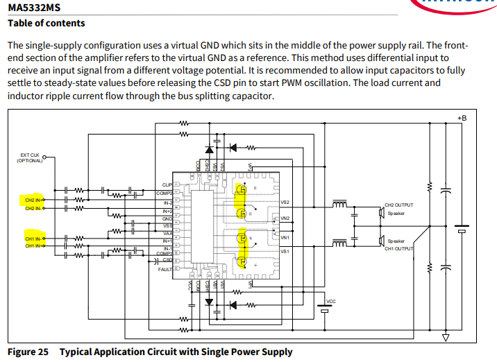

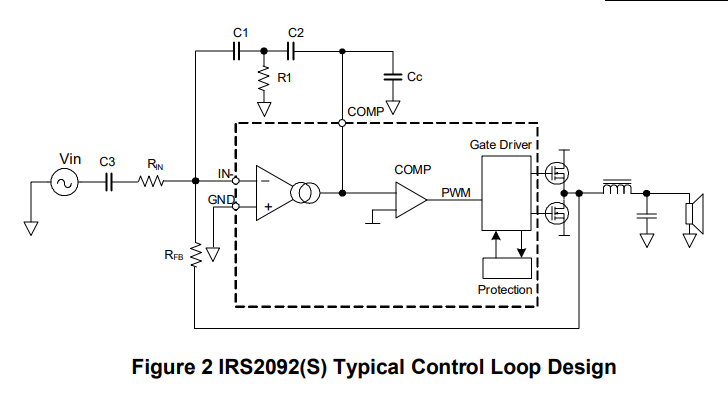

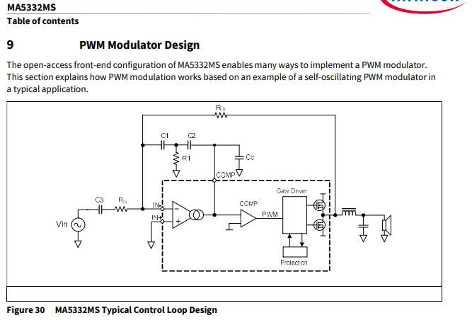

IRS2092 and MA5332 have similar control loop designs, the chip process might have improved but they still have the same topology.
Just highlighting this because others might assume that MA5332 is the higher version of MA12070, just because they have the same "Merus" branding.
IRS2092
MA5332
MA12070 has a proprietary control loop design. Which is why the design hasn't been shown in its datasheet
MA5332 definitely does not implement a multilevel topology

They have the same THD, same noise, and same freq vs THD+N, power dissipation was improved due to integrated mosfets. You are arguing over a very thin line of MA5332 with built in mosfets, and IRS2092 without mosfets. That's all.
Show reasoning why explicit mention of a prior generation would be needed? Looks an entirely reasonable conclusion to me and your 'wrong' is merely an assertion.
So you claim.

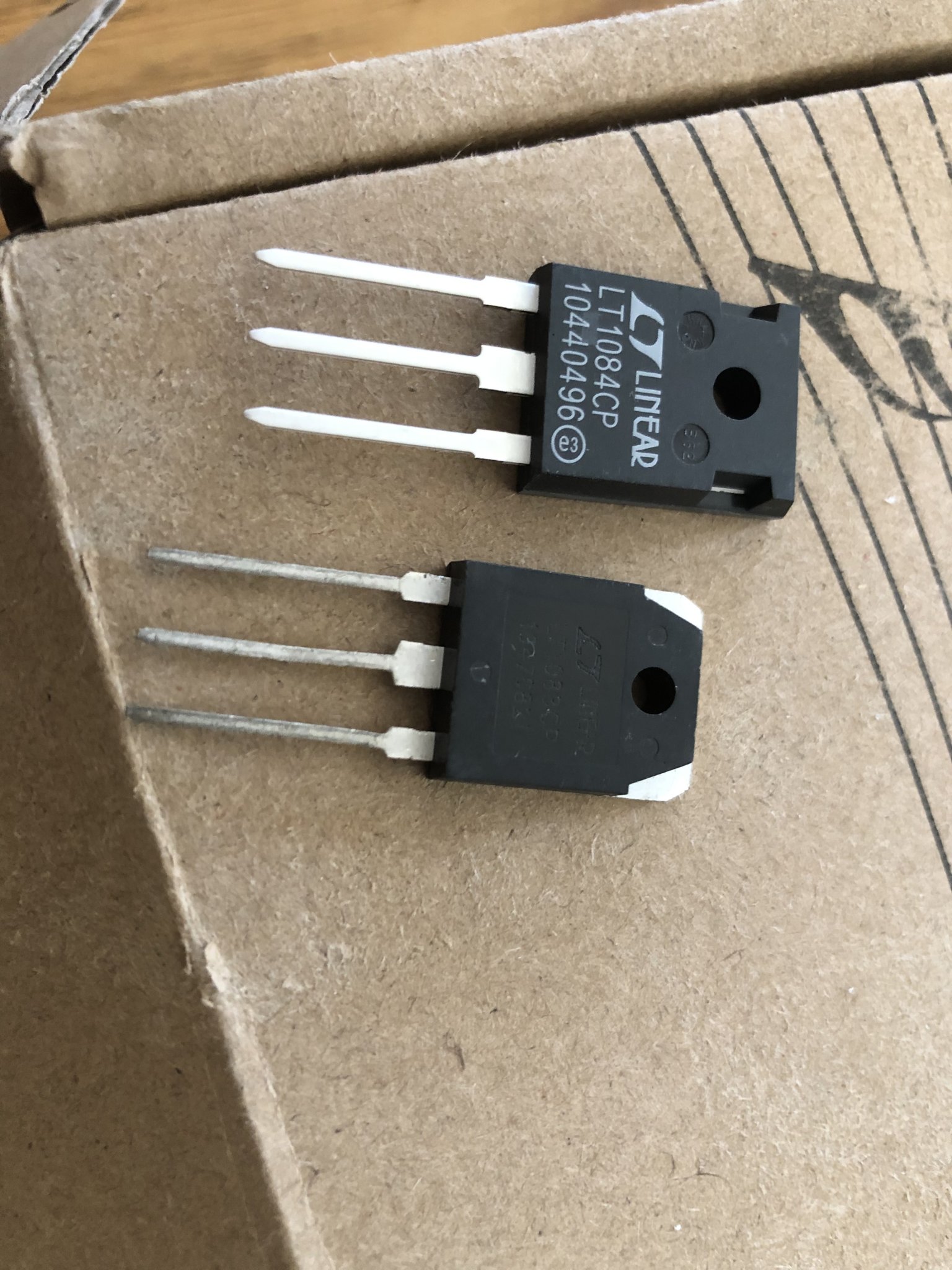

Yes please Post a picture
Here is one. It is not hard to see 🙂 Even the normal insulation washers don’t fit. These came from the main distribution channel of fake parts. Of course a picture of original ones was used.
Glad I found a rail with LT1084CP but an original LT1083CP would be nice.
