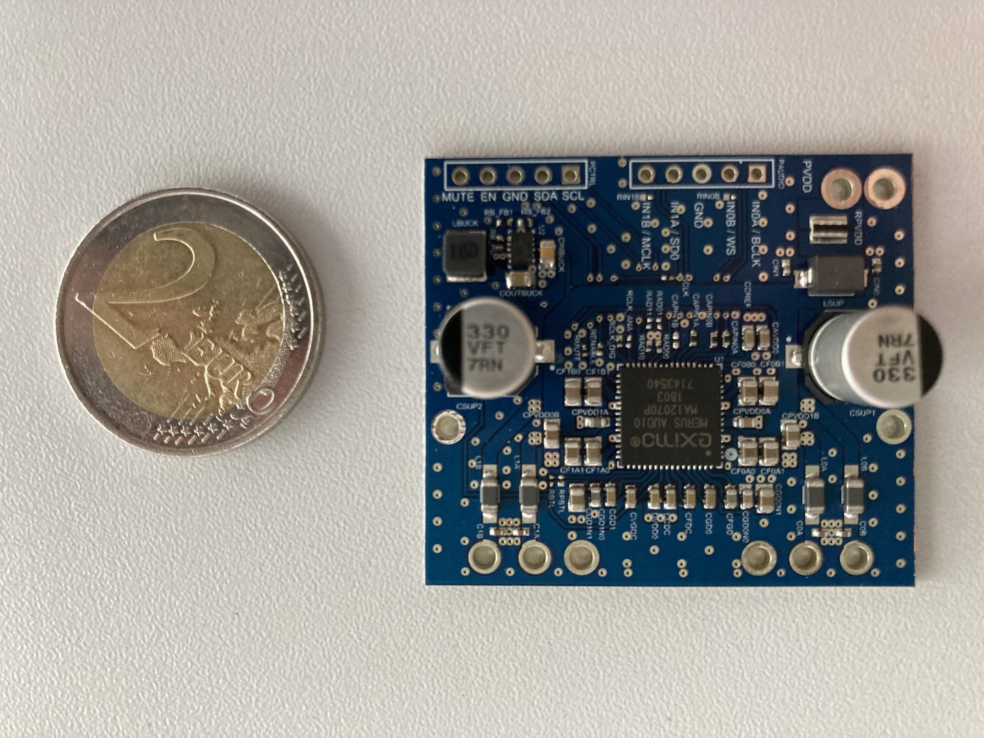

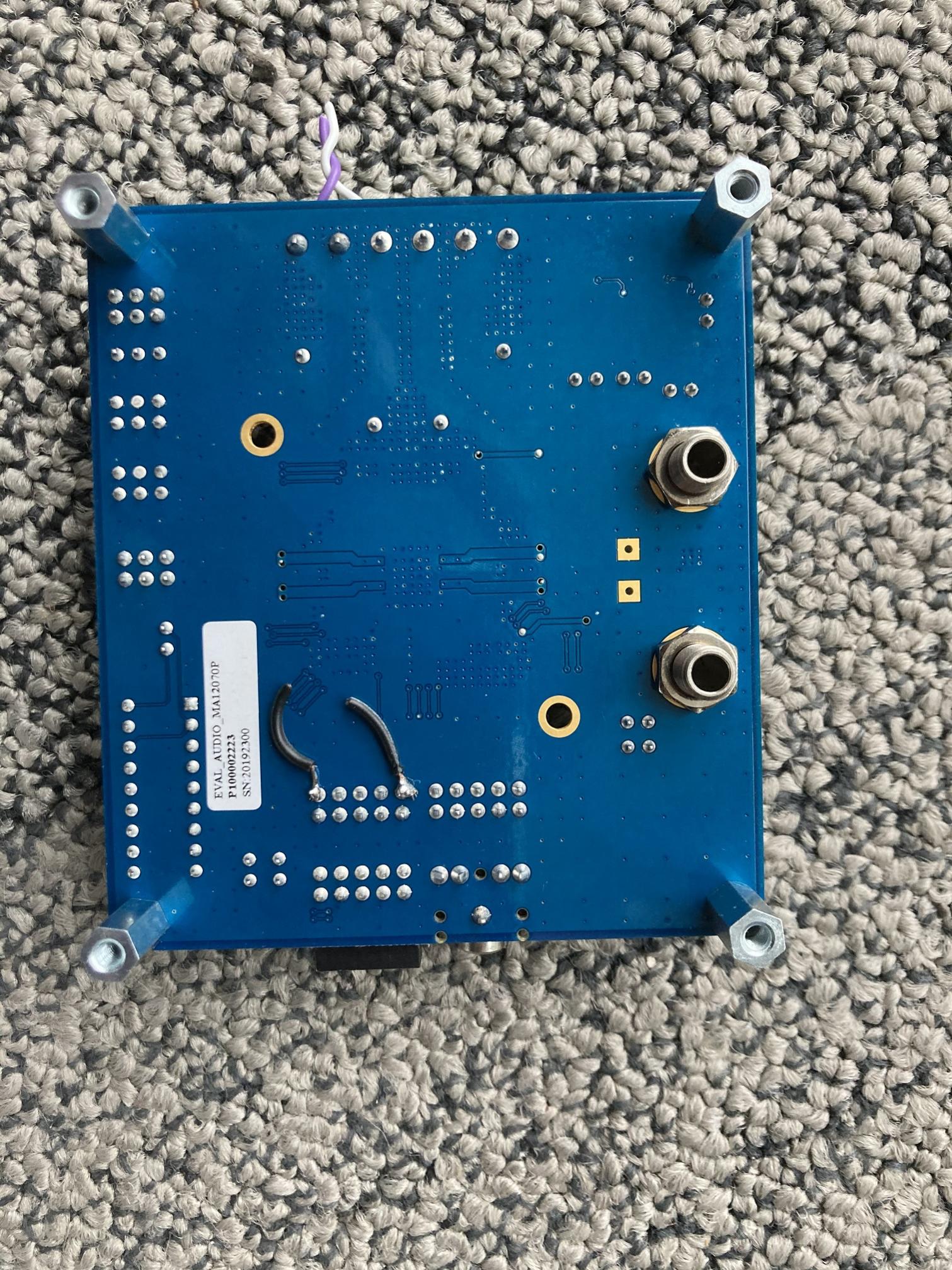

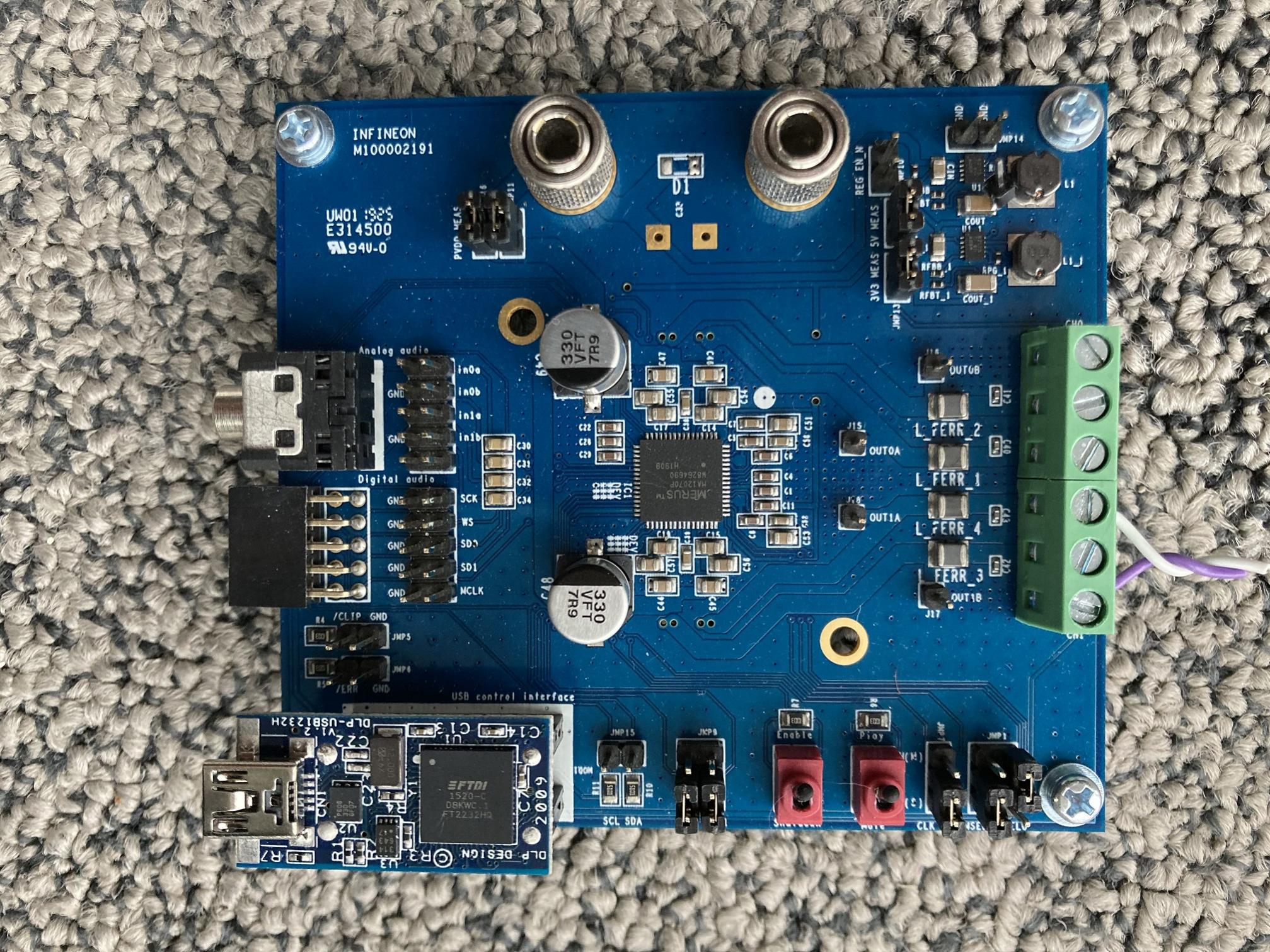

Here as promised some pics of the EvalBoards. On the big one I did already some "hand modifications"... so don't wonder.
For the small one I put a 2€ coin next to it for size comparison.

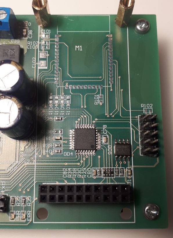

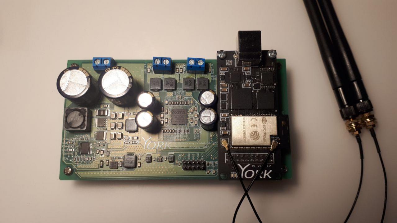

Finally spent few days on these winter holidays on the second version of my Merus amplifier.
It basically consists of 3 parts: power regulation + LM25122 boost converter for PVDD, Merus chip and MCU/control logic.
This time I used another my project, the interface board, just to make bring up and debug process easier 🙂 But there is a place for Atmega8, which now does the job of merus chip initialization and encoder handling for the volume control. Signal source is the amanero-like interface board, it will work with original module without any problems, or there is also an option for on board ESP32 module:
There are 3.3uH inductors in the output filters which are not necessary. And I don't know why, but when amplifier is enabled these are quite noisy! Maybe it's just bad choise of inductors. I've never heard any noise from inductors in TI based amplifiers.

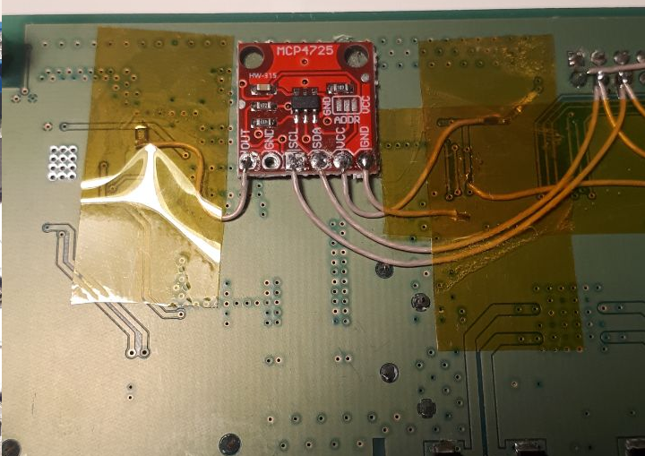

Someone mentioned here that it will be interesting to dynamically control PVDD, so since I had almost everything in place, with addition of small I2C dac I did it:
It's basically current injection in the feedback loop of the boost converter, which allows to set output voltage in 12-36V range. Can't say that I notice any difference in output power by just listening music. It does make sence because it is a closed loop amplifier. This trick works great with TI open loop amplifiers 🙂
