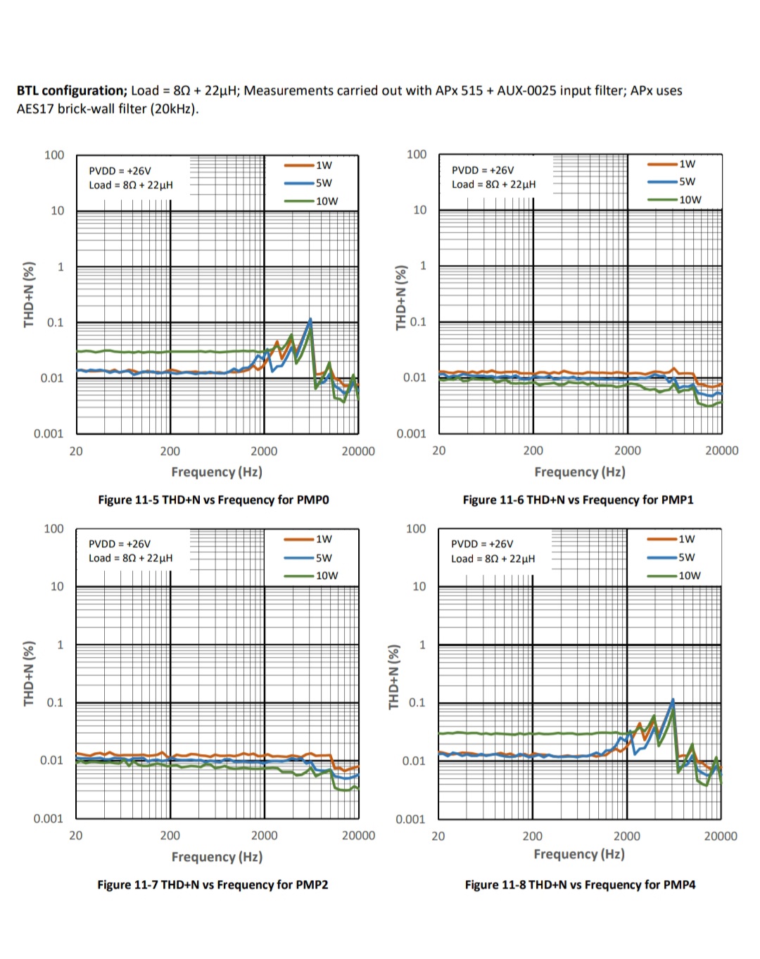

if we look at the distortion measurements in the PDF (40 like the 70), we can see that the distortion rates are higher in the high frequencies on the PMP0 and PMP4 amps, not the case for PMP1 and PMP2.
If it's plugged into BTL, is there a fusion of the first 2 and the last 2, when is the final distortion?
Also another question, can we choose 4 channel mode, and connect only the PMP1 and PMP2? I know that a class D amp becomes unstable if no load is connected, I could always put resistors of good capacity.

I don't understand this questions to be honest.
The measurements are already for BTL configuration (standard Stereo-operation).
And no, you cannot set the power-mode profile per output. You can configure it via I2C, but the power-mode profile applies for the whole amp (and therefore also all outputs).
MA120x0 doesn't have stability problems in open-load condition in proposed ferrite-bead filter configuration.

I will try to be clearer. Let's say I want to connect the 4 channels separately (4.0), my question is if the distortion of the 2 nd and 3 rd channel is lower than 1 and 4?
