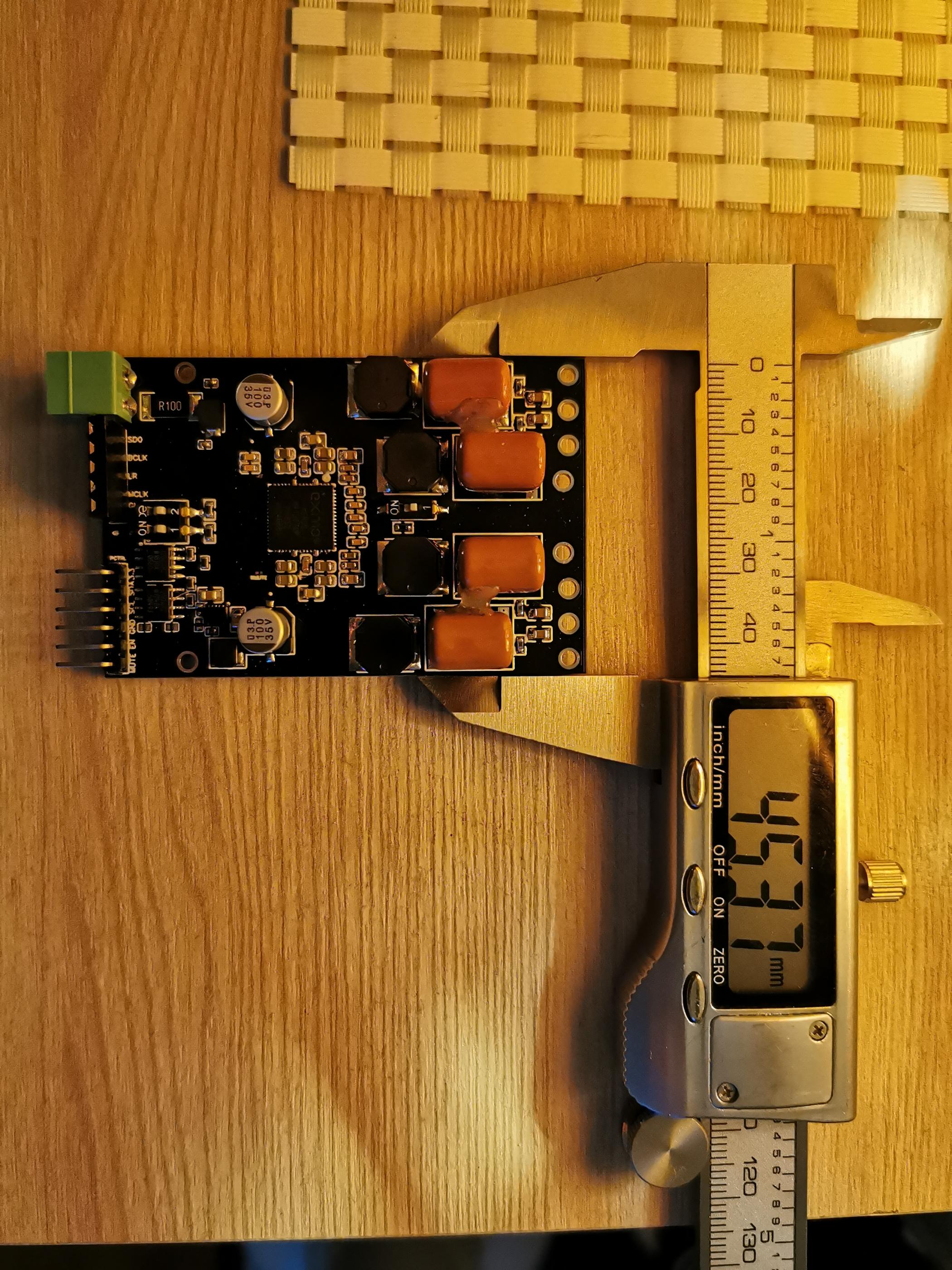

But source of the audible noise is defenitely MA filters. During bring up I've used off board PSU.
Here is my version of PCB for MA12070P. Nothing special, used Infineon's reference board design as a base. Added two Adum1250 to isolate I2C and MUTE and EN pins from microcontroller. Also added couple of buttons to switch I2C address and toggle between BTL and PBTL modes. And finally changed ferrite filters to LC filters.

I found one mistake yesterday in my assembly, one cap value in the filter was wrong.
After fix the filter now is 3.3uH + 1uF, and RC is 2uF + 5.1 Ohm
When amp is idle the noise is much lower than under load. I actually can hear music coming from inductors when the amp is loaded by 6 Ohm resistors 😀

Here is waveform for filter in (or MA output, yellow) and filter out (blue).
There is some ringing, it should be possible to improve by ajusting filter parameters.
I hear that noise in idle, but it's very silent, as much as in other amps. Nothing noticeable.After fix the filter now is 3.3uH + 1uF, and RC is 2uF + 5.1 Ohm

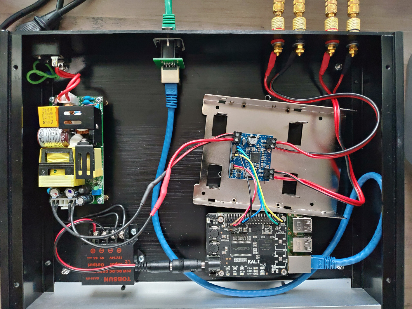

I have the ma12070P reference board. I'm trying to build a Raspberry Pi-based "sound server". The idea is to use a single 24V power supply. That directly powers the ma12070p board; it also powers a 5V buck converter for powering the RPI. For signaling, I'm directly connecting the I2C and I2S pins from the RPI GPIO header to the Infineon reference boards. See pictures.
In this config, I'm not getting any sound. I can communicate with the ma12070p board via I2C. I am using the "rpi-dac" overlay to push the I2S data. The Allo Kali is helpful, because the LED status indicators show me when a stream is active. Those do light up as expected when I play sounds. So I do believe I am creating an I2S stream.
The ma12070p has a number of I2S options available to configure via I2C; I believe I've tried them all (in particular, trying different versions of right-justified, which I think is more common). In my experience, if two devices don't agree on the I2S format, you should at least get noise. But I haven't been able to produce any sound.
My hunch is that I've overlooked something trivial, so just thought I'd see if anyone here notices anything obviously wrong. Thanks!

There are few wires missing: enb, muteb and mclk
See post 292. Are you sure you can communicate with the chip? Can you read status or volume registers?

Thanks for the hint, I have some progress.
I deliberately didn't connect ENABLE and MUTE pins, as the board's reference manual says, "The board is shipped with a default configuration for automatic start-up". I also measured the voltage on those pins, ENABLE is 0, and MUTE is 5V (which are the settings for enabling playback and not muting). (However, I do think I'll ultimately connect those to the RPI GPIO pins for software control.)
The culprit seemed to be that MCLK pin. The RPI doesn't provide an I2S MCLK, and in reading about the ma12070p chip, I mistakenly thought it could be left unconnected. However, it looks like that pin on the reference PCB actually connects to pin 32/CLK of the amp IC, and the datasheet says this about that pin: "Clock input. Must be present before enabling the amplifier." Infineon actually makes an amp hat for the RPI Zero; looking at the docs for that (MERUS audio amp HAT ZW), they actually jumper MCLK and BCLK. So I used a paperclip to tie those two pins (i.e. pins 1 and 5 of the PAUDIO header on the reference board), and now it's playing music!
I've got volume control working via I2C as well, too. (For anyone else doing this, be careful with I2C addresses 0x35 and 0x36, they are used for both I2S config and volume processor/limiter config. I'll post code when this is in a more polished state.)
The only thing that's strange now is that there is an audible hiss and it sounds like it's coming from the PCB itself. I can't figure out what on the board could cause a hiss. If I physically jumper the MUTE pin to GND, then the hissing stops. When I pull the jumper, the hissing resumes, along with a pop.

First, where did you get those tiny terminal blocks? I soldered wires to those holes 'cause I couldn't find anything small enough.
I'm probably having a senior moment, but the MUTE and ENABLE pins of the chip are currently jumpered to VDD and GROUND, respectively. As I understand it, you would need to remove the jumpers to allow external control of those pins. Are you not creating a short when you ground the MUTE pin? If so, I wonder if the board is shutting down instead of muting.
