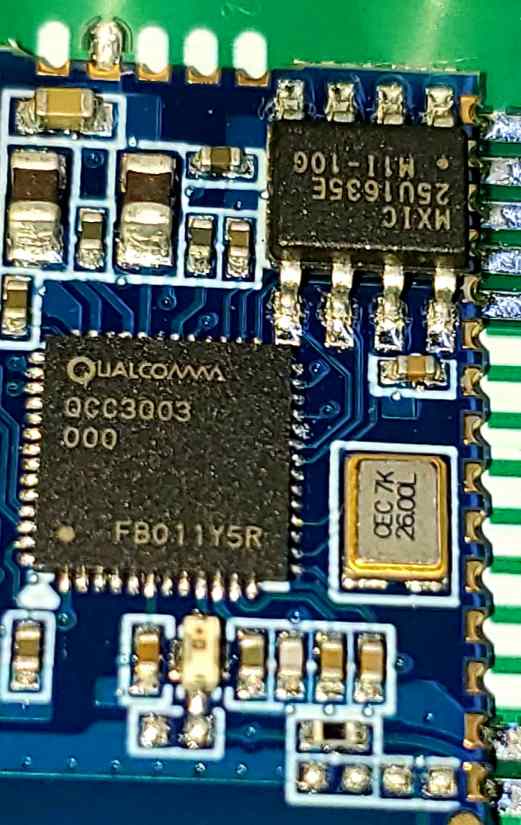

I was interested in the MA12070 PCB, but wanted to try before the MA12040 which is already in a box and with a Qualcomm QCC3003 bluetooth chip (not the best but handy in my workshop). So I bought from Douk and the delivery was quick. The amplifier is very quiet and no pop when opening.

I just want to highlight one matter. Amps like this generally don't have a true analog input. Typically the input is routed into the Bluetooth chip and then digitized and then goes through a D to A again.
That's how they implement the auto input select for such inputs. It is done inside the bluetooth chip.
So there might be additional "colour" from that process.
Best to use a board and build your own amp if using analog inputs.

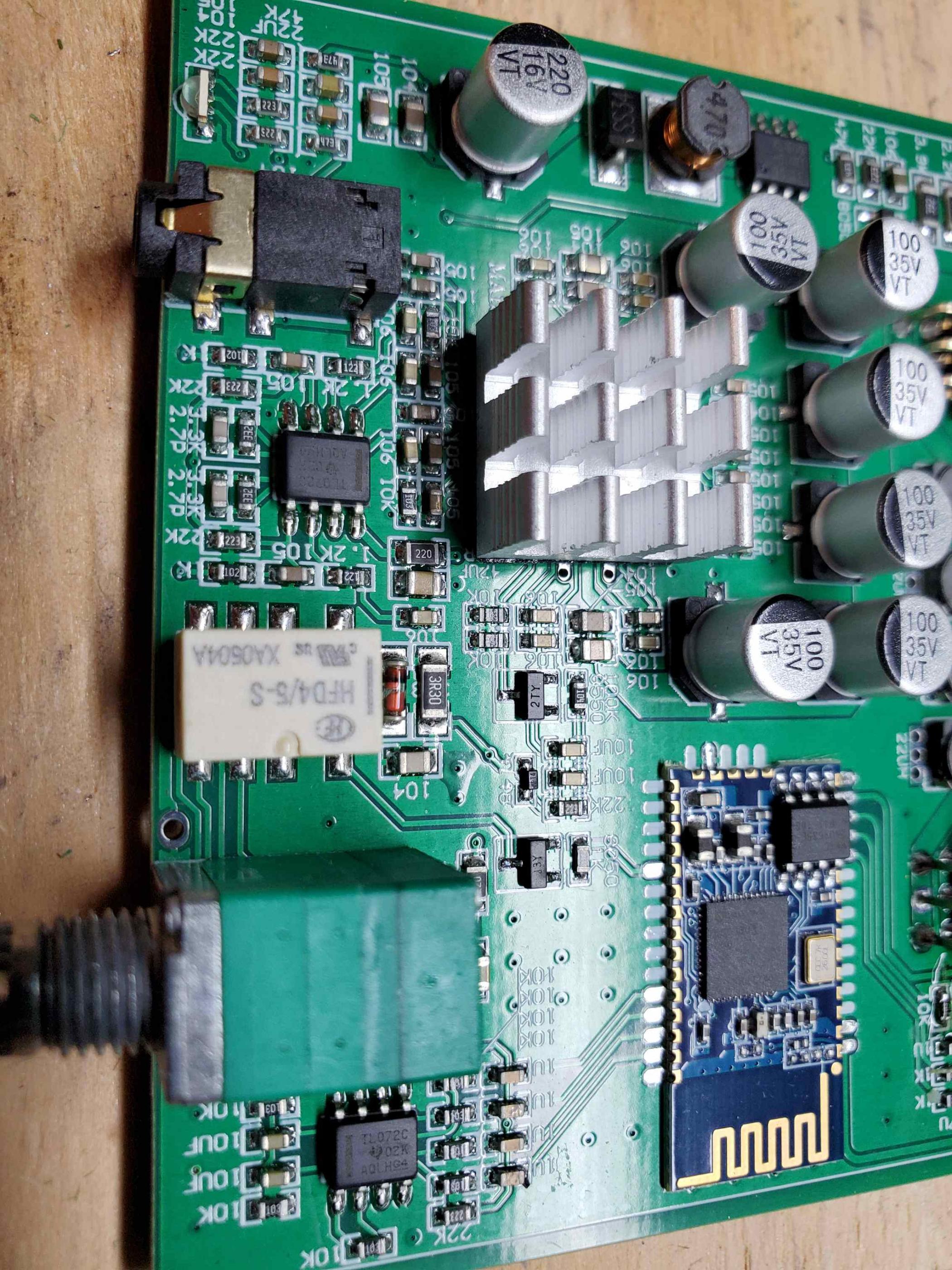

Well, I can't say for this amp specifically, but the amplifier board from sure electronics and tinysine does this.
As for your amplifier, I can't be certain but there is a white rectangular component next to the volume control might be a relay, but it looks quite small. I can't see any other signal relays. But I suspect it might be a power relay, the switch on the volume control would not have enough current to handle this, might be used to turn on relay.

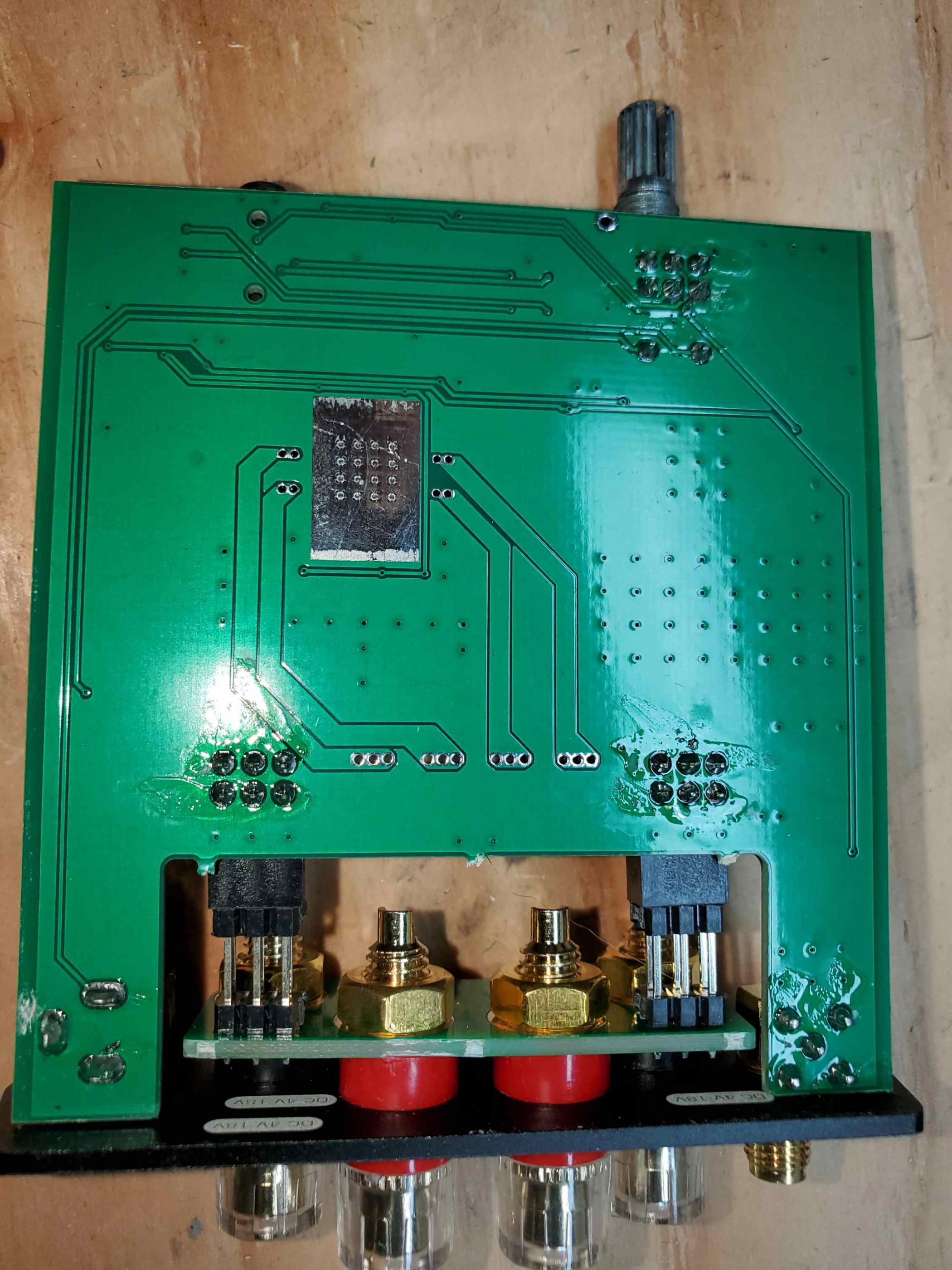

We hear very well on board. By default it's in aux mode, from what I'm seeing here and hearing. I have other PCBs with Qualcomm Bluetooth.
On one of the photos, you can see I soldered the direct dc, because the socket is too small, I tried 6 connectors. The one I had managed to enter had to be pushed very hard and risked breaking. Tried Douk's for $ 11

I had a check on the white object, seems it is a signal relay, so it is good that it allows a proper bypass.
Now I am tempted to get one. A few things i could comment though based on the photo. The DC in track is awfully thin, and it seems to be directly routed through the switch on the volume control. If I were to modify it for hifi purposes, I would bypass it altogether.
BTW, these DC plugs have two variants 2.1mm and 2.5mm if memory serves me tight. Could it be they sent you the wrong power supply?

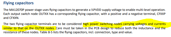

I don't know, but somehow it seems for me that the Layout is probably not the best.
If I see it correctly, the "flying" capacitors are connected very poorly with some extremely small and relatively long traces to the chip. I marked this in red in the picture below.
However the datasheet says, the current / voltages into or out of the flying capacitors are carrying similar currents as on the output-nodes!

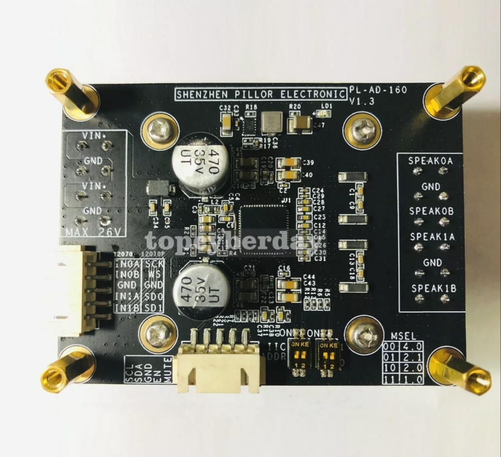

With the MA12070 PCB, has someone connected with an unbalanced input signal, Is there any noise??
Ps: I created a thread to discuss the MA12040 in a box
The little brother: Infineon MA12040 modifications
Read my post on page 21.
In the unbalanced connection, IN0B and IN1B are connected to GND, but in this case, noise is generated when the input is open. If you connect it to any input, the noise will disappear. Also, depending on the type of DAC to be connected, noise may be generated when entering sleep mode.
The generated noise is a large level and feels like white noise.
I try to terminate the input with a resistor of around 10kΩ.
This noise issue does not occur with balanced connections.

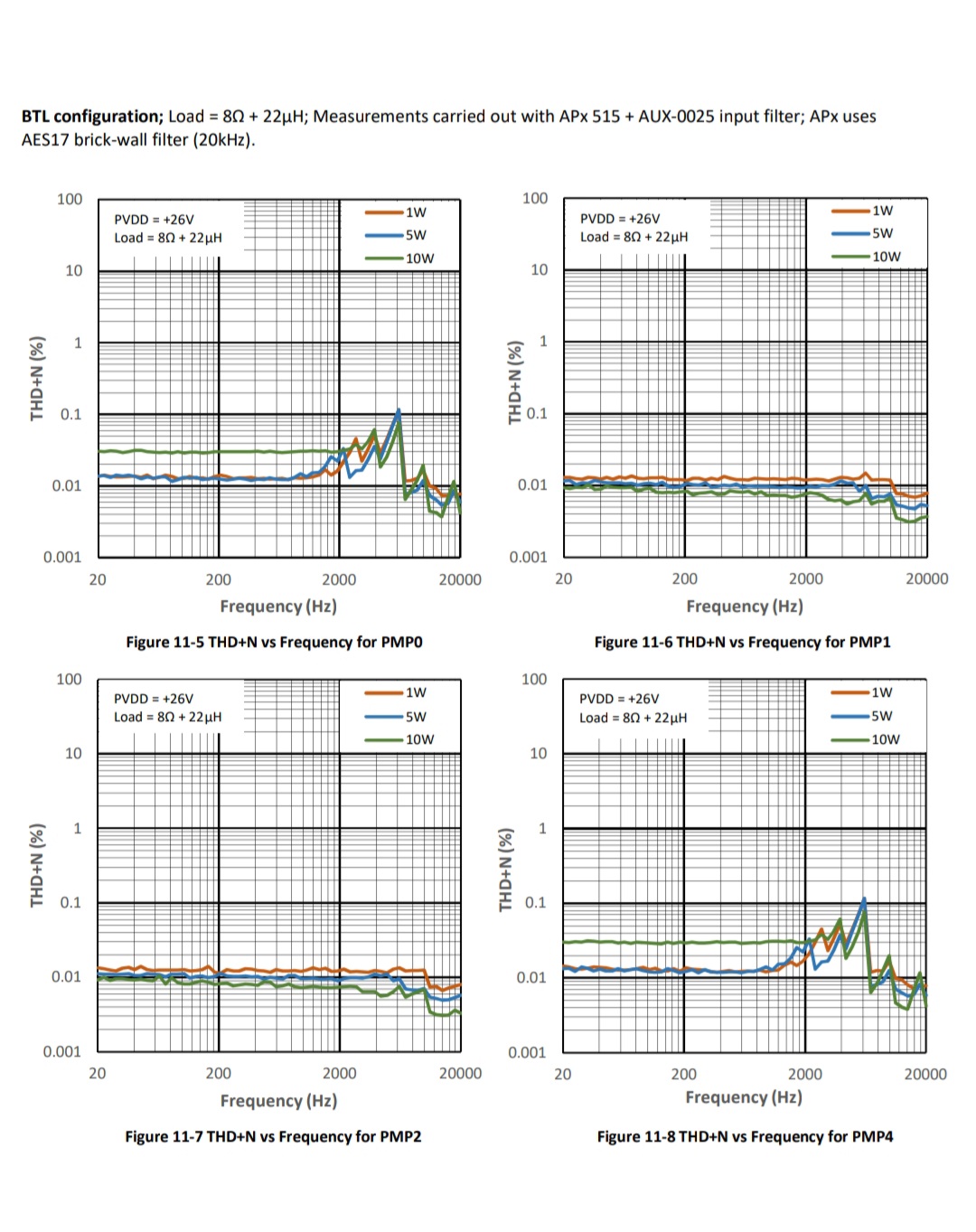

if we look at the distortion measurements in the PDF (40 like the 70), we can see that the distortion rates are higher in the high frequencies on the PMP0 and PMP4 amps, not the case for PMP1 and PMP2.
If it's plugged into BTL, is there a fusion of the first 2 and the last 2, when is the final distortion?
Also another question, can we choose 4 channel mode, and connect only the PMP1 and PMP2? I know that a class D amp becomes unstable if no load is connected, I could always put resistors of good capacity.
